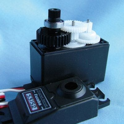

There are advantages, however, and with the introduction of the S3152, Futaba has made them much more affordable. The ‘thirty-one fifty-two’ is a high torque servo that combines robust, well-engineered nylon gears and a ball-bearing output shaft with more performance than many analogue servos with higher torque ratings – all in a standard-size unit that can be bought for around £20.

How’s it done? Well, the S3152 uses a digital amplifier, so that unlike an analogue servo, whose motor is supplied with voltage at 50 cycles per second (50Hz), the voltage in a digital servo is supplied at 300Hz. In crude terms, the magnetic field in a digital servo gives the rotor a full-voltage ‘push’ six times more often than does the field in an analogue servo. The net result is to make the motor more responsive to small or momentary control inputs, and – because the increased frequency means that the voltage reaches its peak more quickly – more powerful.
Run an analogue servo alongside an equally rated digital unit and you can see this difference immediately. A quick flick of the sticks will produce hardly any response in the analogue servo before the stick centres itself again. The digital servo, on the other hand, will mirror the travel of the stick precisely. Similarly, if you hold the output arms of the servos with your fingers, you’ll feel just how much more immediately the digital unit delivers its torque: it’s so fast it hurts.
