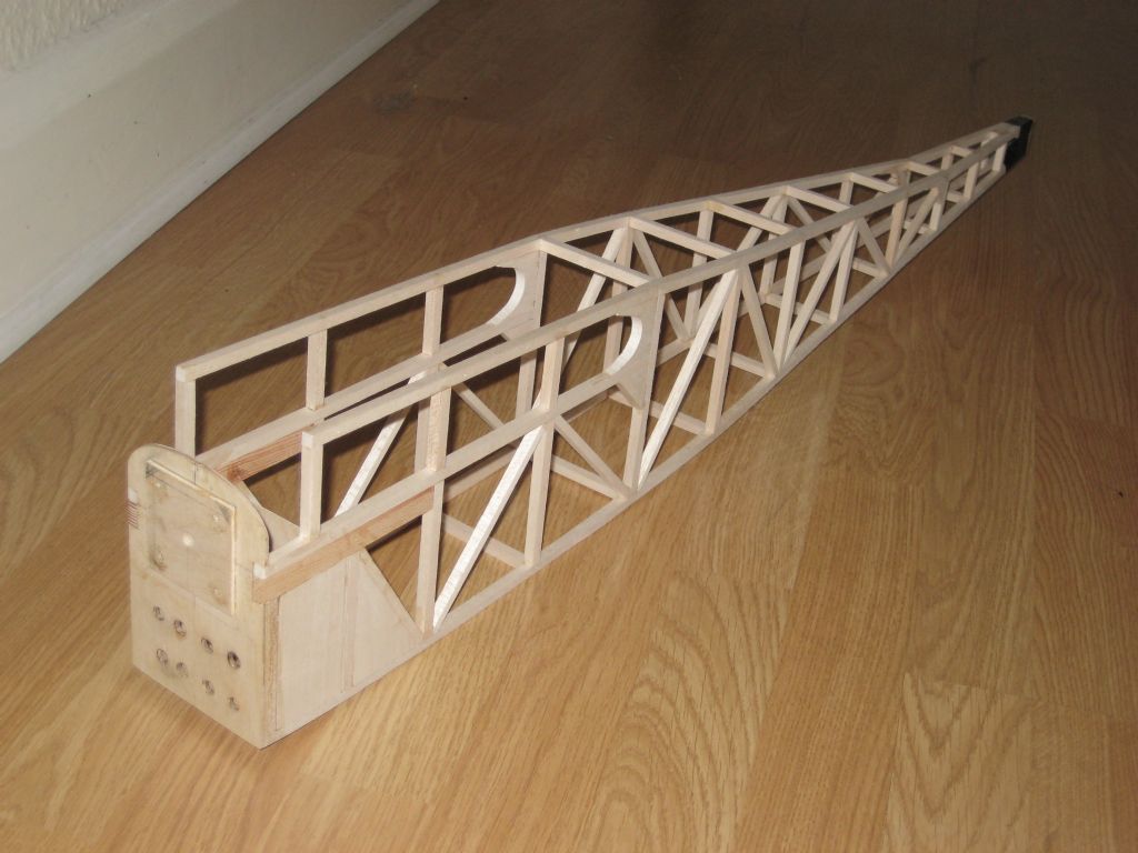

propogandhi Posted February 14, 2011 Author Share Posted February 14, 2011 Here's my progress from the last couple of evenings. I'll get the 1/4 cross braces in tonight then hopefully my extra long motor mounting bolts will arrive in the post in the morning and I can get on with that. prop. Quote Link to comment Share on other sites More sharing options...

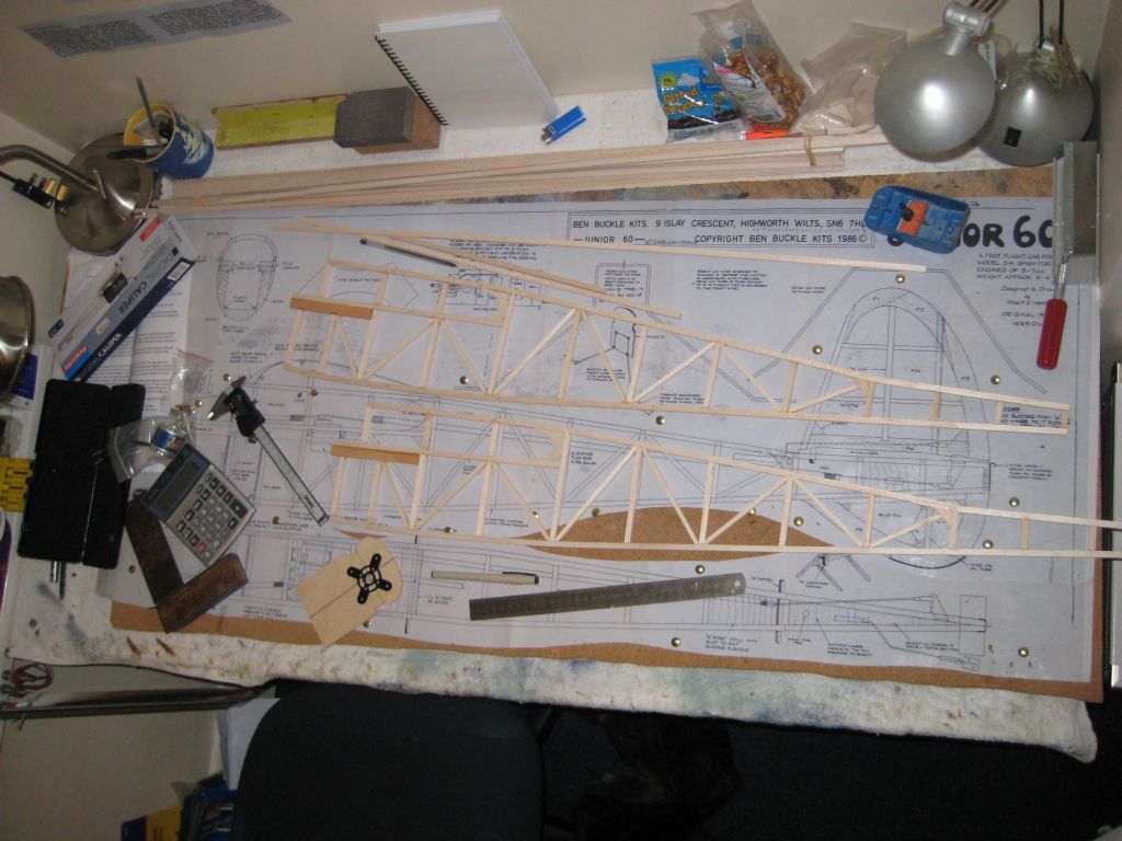

propogandhi Posted February 27, 2011 Author Share Posted February 27, 2011 Been a while since I was last at the work bench due to a busy schedule at work, but found some time to progress today. The Fuzz has been completed as much as I'd like to for now and I have moved on to the wing. I need to have the wing build so I can figure out exactly my idea for retaining the wing to the fuzz. So get the wing out of the way and I can continue with the fuzz etc. One half of the wing is now basically complete. If I'm lucky, I'll find time to have the other half at the same stage this time next week.... prop. Quote Link to comment Share on other sites More sharing options...
propogandhi Posted March 7, 2011 Author Share Posted March 7, 2011 Managed to work on the wing this weekend, and it is now almost complete. As I plan to make the wing 'bolt on' I moved away from the plan some what with regards to the center section. The T/E now has a hard balsa block added and as wing bolts will pass through this section. To give strength I've added 'center spars', upper and lower 1/4 sq with webbing, and one lower 3/16. Solid balsa block will be added to the opening in the L/E and will accommodate dowel pegs to hold the wing to the fuzz through a former that I still need to add.The entire center section will now bee sheeted as per plan. I still have to complete the other side of this center section. Looking at the 'events' calander over the weekend, the first show I notice is the Old Warden Mayfly weekend, which notes 'vintage and electric models prop. Quote Link to comment Share on other sites More sharing options...

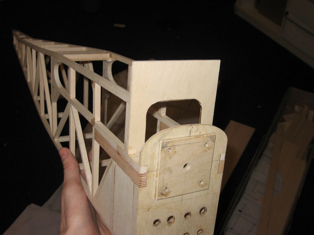

propogandhi Posted March 16, 2011 Author Share Posted March 16, 2011 As I'm making the wings 'bolt on' I've cut and added a former for the wing dowels to rest in, and the balsa block that will hold the dowels has now been added to the center section of the wing. I can now align the wing to the end of the fuzz and drill holes for the wing bolts and wing dowels. Once I have the wing fixings all sorted I'll move onto the tail and then the cowl and then installations and finishing prop. Quote Link to comment Share on other sites More sharing options...

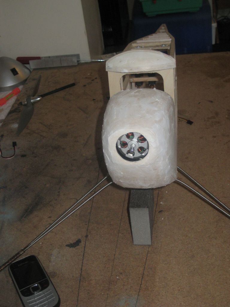

propogandhi Posted May 8, 2011 Author Share Posted May 8, 2011 Haven't found time until recently to work on the J60, here is some progress below. Cowl is held in place firm with rare earth magnets, and has a nice 'snap' to it when put on, so I don't think it will be going anywhere in flight. Motor now mounted too and the U/C was soldered up last weekend and bolted directly onto the bottom of the fuzz, held in place with saddle clamps. Next once I've sanded back the filler on the cowl, I've go over it with sanding sealer and once that is cut back I'm hoping filler primer, then primer will be enough to stop the grain showing through, then I can just spray it without messing around with glass/epoxy finish. Time will tell. Installation of electronic this week, then I hope to be ready for covering by the weekend. My aim is to have the model test flown and ready for Bickley at the end of May! prop.Edited By propogandhi on 08/05/2011 17:43:31 Quote Link to comment Share on other sites More sharing options...
