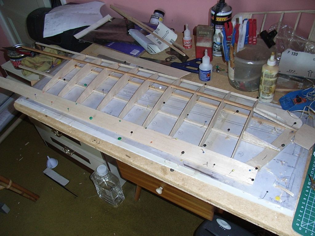

David Davis Posted May 20, 2012 Share Posted May 20, 2012 I have been impressed by the workmanship and camera skills on both Big Bandit and Andy Green's Super 60 build logs. My own workmanship is not as good as their's and if anyone wants to know how to build a Super 60 they could do worse than to look at their threads. My own version is a bit of a hybrid; the fuselage has been built off an early single channel plan while the tailplane is the flat-plate Ben Buckle version. I said in an earlier post that I would use balsa for the wing spars but when I checked I found that none of my balsa that I had in stock was hard enough so I used some spruce which I had to hand. Some of the joints were not as tight as those of Big Bandit or Andy Green's but I have made them good with scrap balsa cyanoed into place. Furthermore I cut out the wing ribs from the plan but did not get the taper at the rear at all right so the trailing edge is a bit thick. I have made three minor modifications. 1.I've let in some sheet balsa between the longerons at the exreme rear of the fuselage to provide a bigger glueing surface for the tailplane to adhere to. 2. I have added some balsa block to the leading edge of the centre section of the wing to match the cabin top in the style of a Junior 60. 3. I have positioned the undercarriage slightly more rearwards than indicated on the plan as I'm told that these models sometimes ground loop with the undercarriage in the stock position. I enjoyed carving all of that 1/2" block in the nose and have arranged to mount the engine on a paxolin plate. I shall probably use my Irvine 30 instead of the Merco 35 simply because the carburetter sits a fair bit higher on the Irvine and it's not necessary to file a groove in the nose to accomodate the main needle which would be the case with the Merco. Finally I don't intend to cover my model in silk or nylon as it's far too time consuming and I have a fair bit of Solartex in stock. The pictures show th tailplane under construction; the starboard wing on the building board, note the spruce spars; the starboard wing being attached to the wing centre section, note the tidy workshop (!) and the completed basic construction of the model minus elevator, undercarriage and rudder. I've found that I have 2.5" under each wing tip rather than the 2" or 4" measurements shown on the BB and original plan respectively. Still, I expect it'll fly alright. Edited By David Davis on 20/05/2012 20:20:50 Edited By Steve Hargreaves - Moderator on 22/05/2012 09:56:33 Quote Link to comment Share on other sites More sharing options...

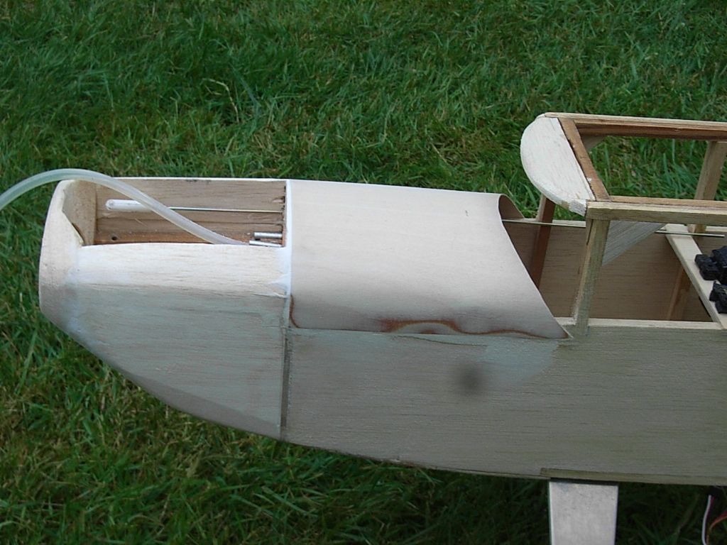

David Davis Posted May 22, 2012 Author Share Posted May 22, 2012 Having renamed the photo "tank," the system seems to have worked. Having said that, it is far more complicated to upload a picture to this site than it is to upload one to RC Groups or RC Universe. Very unuser friendly. The picture shows the tank installation. It is held in place by silicone sealant as well as the cable tie. I have subsequently covered the tank bay with 1/64" ply. I've made a bit of a horlicks of it as I found it difficult top glue the edges to the fuselage structure. However, I once worked as a decorator and given enough sandpaper and filler I can get most things to look right! Quote Link to comment Share on other sites More sharing options...

David Davis Posted May 24, 2012 Author Share Posted May 24, 2012 Perhaps Andy but is there as much as this? The picture below shows the filler before final sanding, the other two are pictures of the forward fuselage ready for covering. Edited By David Davis on 24/05/2012 08:56:43 Edited By Steve Hargreaves - Moderator on 24/05/2012 09:16:11 Quote Link to comment Share on other sites More sharing options...

Steve Hargreaves - Moderator Posted May 24, 2012 Share Posted May 24, 2012 Posted by David Davis on 24/05/2012 08:56:05: Or do I have to start naming names? . Go on David....you know you want to....... Don't worry about the filler.......this can be attributed to "irregularities in the grain"......I use this excuse all the time..... I'm very impressed by the pictures...you seem to have got black diesel smuts onto the model already....this will surely gain you extra marks with the die hard vintage fraternity.... Or could it be that your camera lens needs cleaning.... Quote Link to comment Share on other sites More sharing options...
Andy Green Posted May 24, 2012 Share Posted May 24, 2012 Thats not a lot of filler, take a look at my build. Andy Quote Link to comment Share on other sites More sharing options...
C Norton Posted May 24, 2012 Share Posted May 24, 2012 That's interesting. My DSLR (Canon EOS350) has a dark blob like that on all photos using various lenses and despite cleaning the sensor a few times it remains. If anyone knows how to remove it I'd be very grateful? Sorry, straying from topic here.... Quote Link to comment Share on other sites More sharing options...

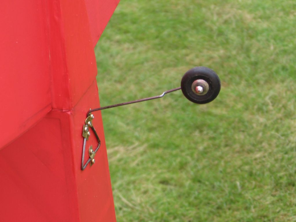

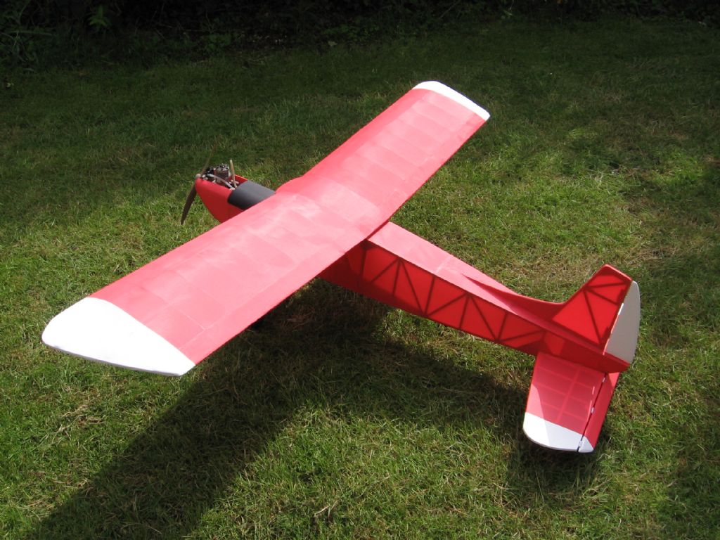

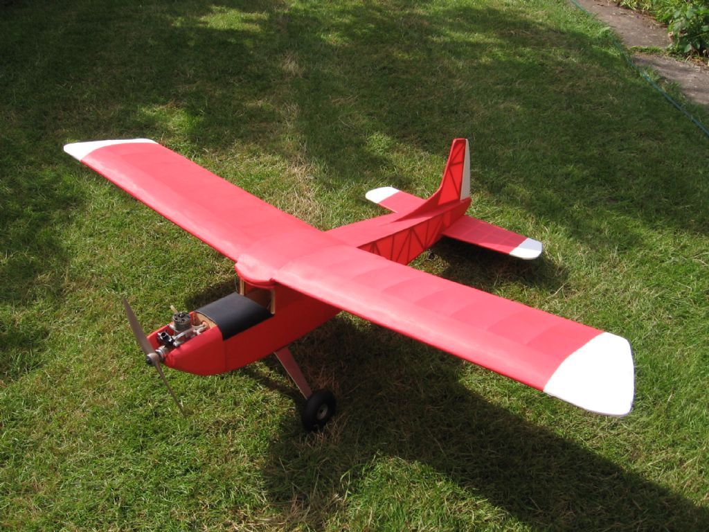

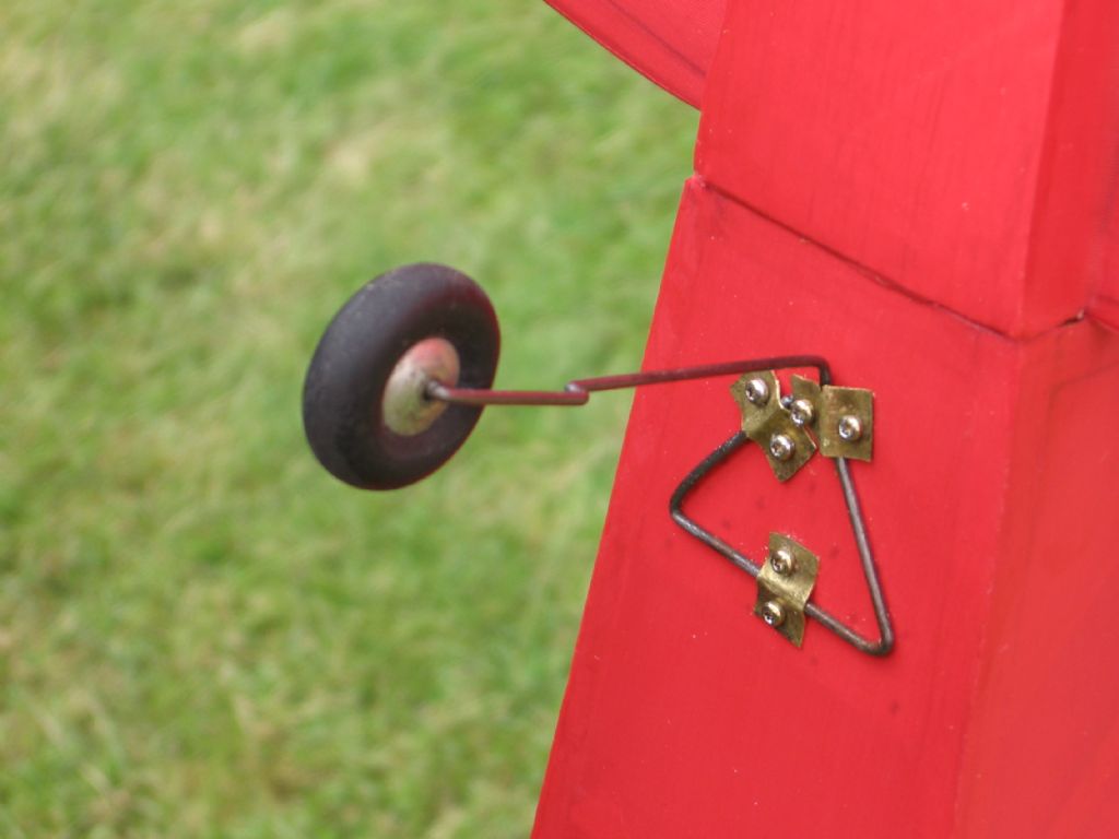

David Davis Posted June 4, 2012 Author Share Posted June 4, 2012 This is as far as I've got. The model is built and covered in Solartex, mostly Vintage Red. The white wing and tail tips and rudder are to assist orientation as I can see me using this model as an ab initio trainer with elderly novices. I still have to; glue and pin the hinges; connect the control surfaces and throttle control; fit the cabin glazing; the spray the model with Clearcoat and apply the decals. The close ups show the tail wheel retained by a small nut soldered to a piece of wire and the wire attached to the model with small screws and brass strip. I hope to maiden the model next weekend weather permitting. Quote Link to comment Share on other sites More sharing options...
