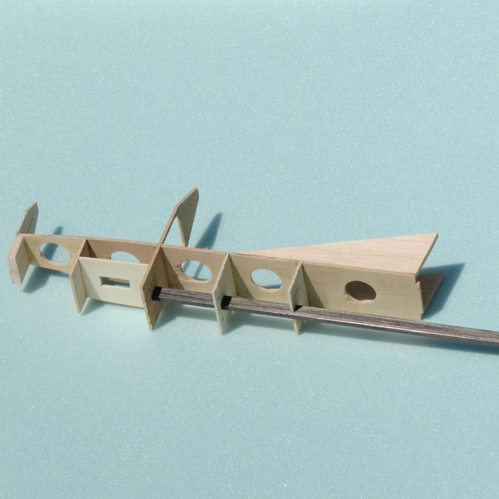

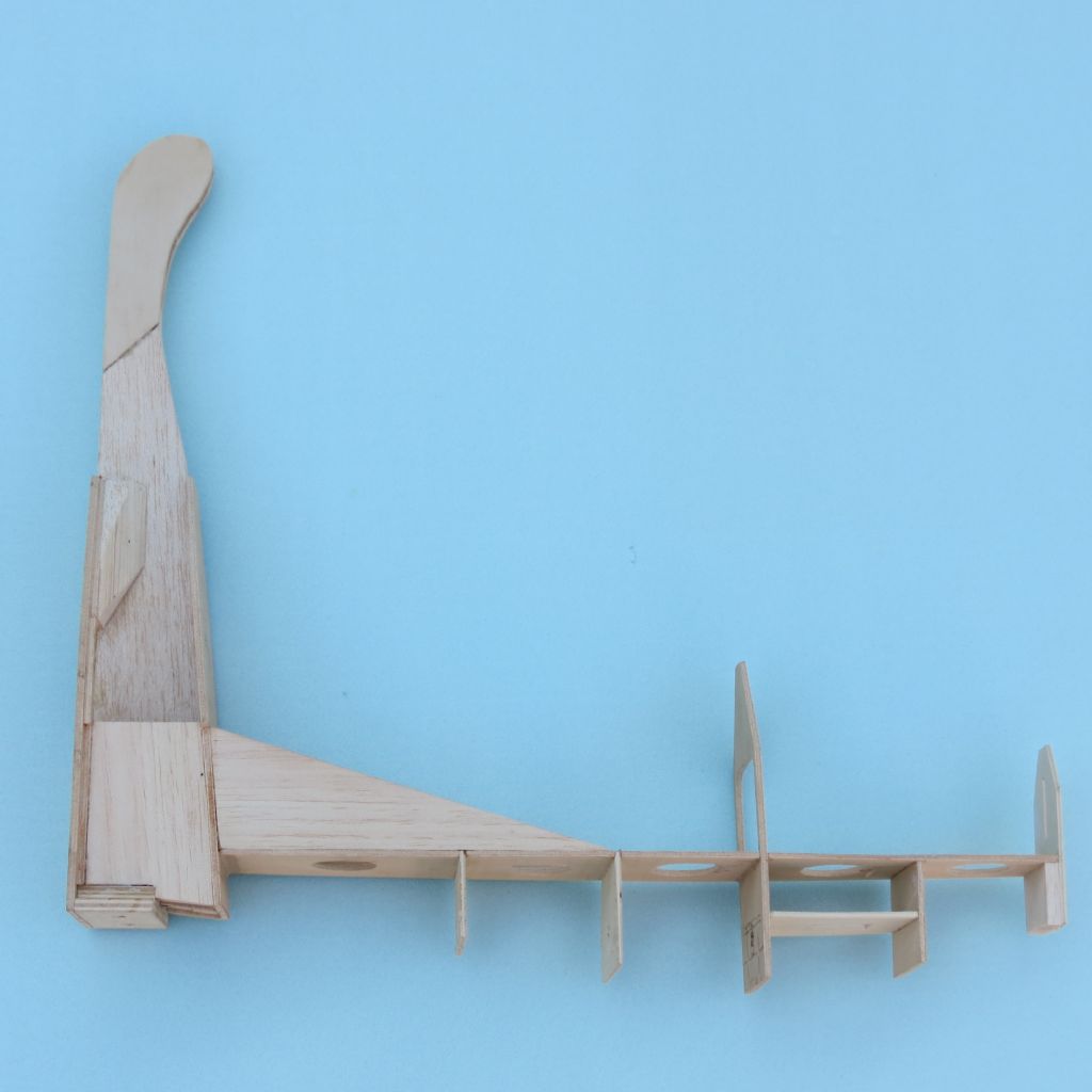

I have added a few more formers which slot into place, before I cmmited to glue the boom was trial fitted and checked for alignment. The boom is a length of 6mm x 13mm carbon fibre box section, this seems pretty rigid and is very hard to twist by hand.
Also, I have glued into position the two rear inner triangular strengtheners (R2) which double up as an aid to align F3.

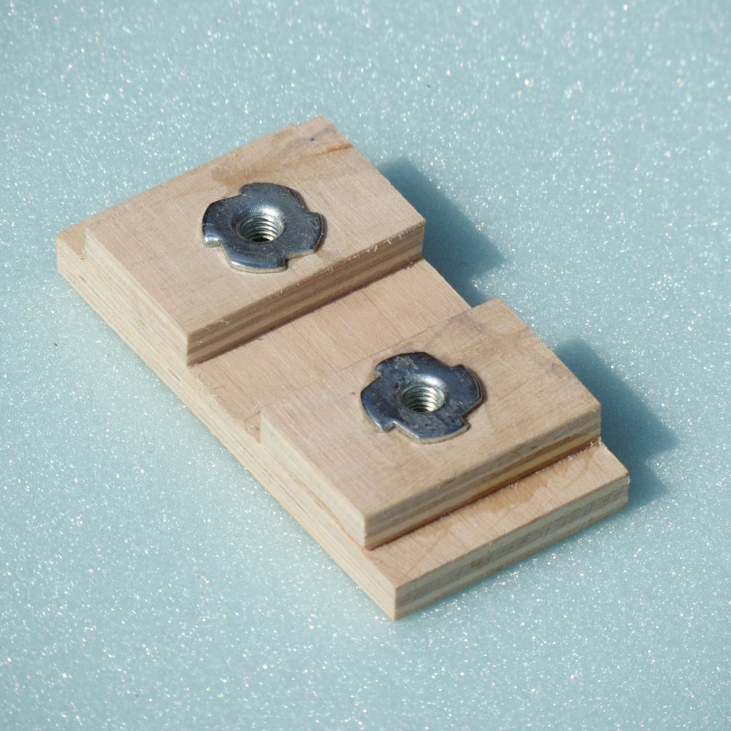

U/C plate assembly is made from 3 pieces of 6mm birch play (I have laminated 3mm thick as I don't have any). Pressed into these are 2 M5 captive nuts. The gap is infact a location slot for the base of the mast, but it will all become a bit mre obvious as the build progresses.
The bulk not only has the motor bolted to it but also the servos mounted into it. I have doubled up this assemby with 3mm lite ply creating a slot for the mast and a bit of extra 'meat' for all the screws to bite into.
At the bottom of this laminated bulk head is a gap, this if for the U/C assembly to be epoxied into which is checked for squareness.
F3 was then glued into postion which slots into the battery plate right at the back and butts up to the 2 triangular doublers (R2).
On to the rear of F3 are glued two 6mm formers (R1), you will note that the grain is infact running vertical as the U/C plate assembly will be mounted at the bottom of these.
Rich

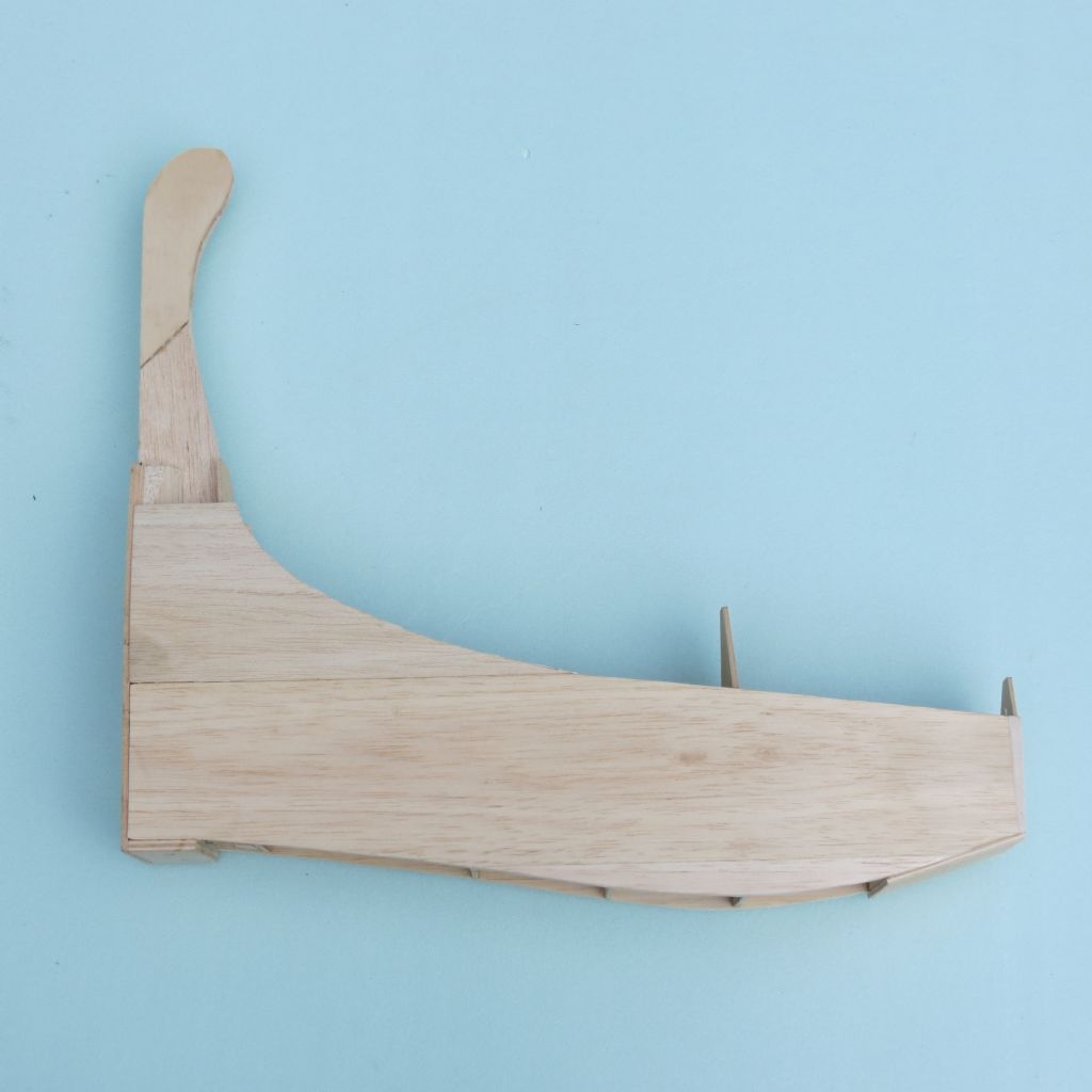

OK, I have progressed a little more this evening with a few bottles of Hobsons finest wink 2
Mast has been again laminated with a 6mm balsa core plus it has a carbon fibre strengthener which is the off cut from the boom. Two birch ply plates are epoxied at the top to creat the female hinge. This was then slid into the pre made bulk head then glued, I also added some triangular balsa section I had kicking around.
Now I had two inner sub assemblies, the front and the rear. These were mated together with epoxy for strength.
Before adding the 6mm balsa fuselage sides I installed a couple of 4mm plastic tubes as guides for the closed loop rudder cables.

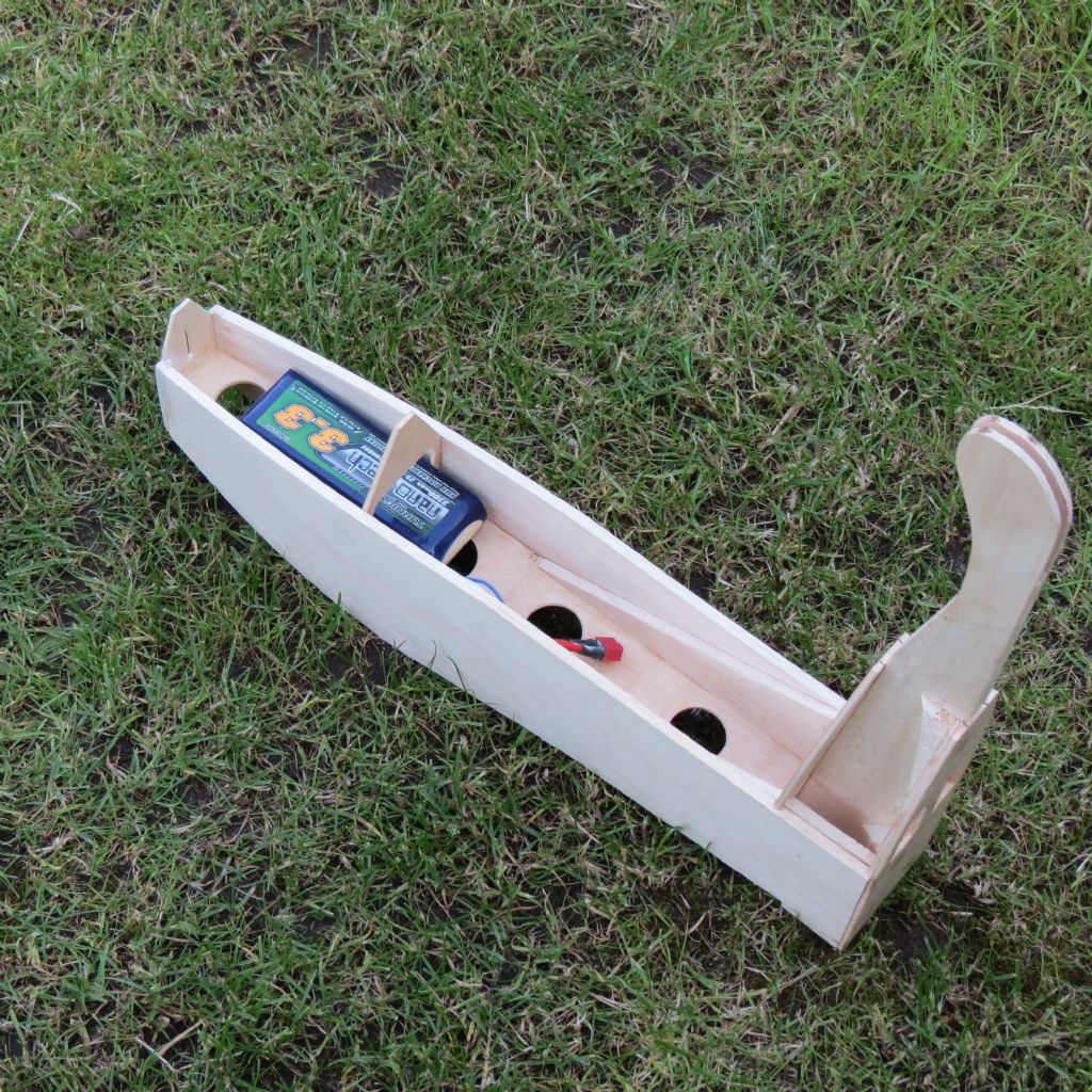

Last for tonight was the fuselage sides and a quick check that I have my dimensions right for the 4s 3300 A Lipo.
Rich

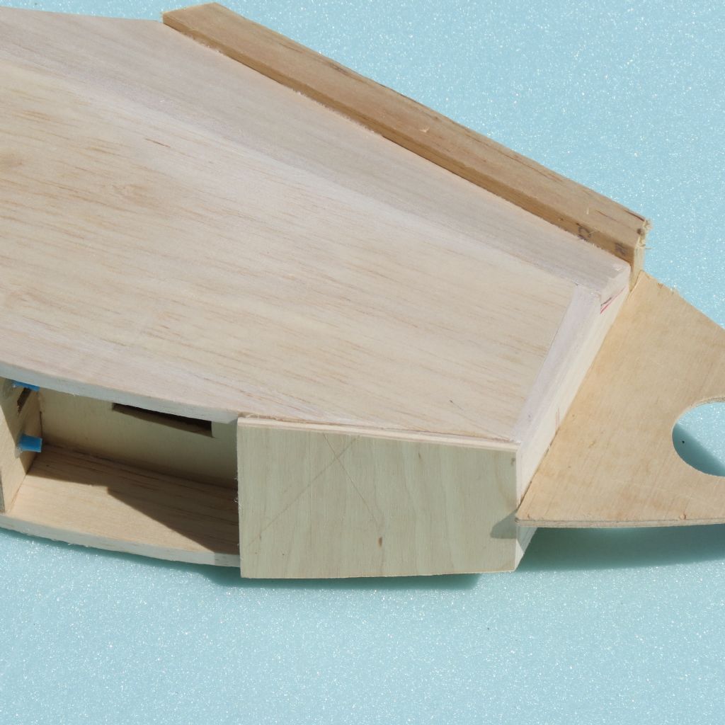

Having been called into work at 6am due to a fault on the fire system I was back at hme for 8 twidling my thumbs so had me a couple of hours adding the top decking .
Rear first......
Followed by the front.....whilst I was in and around that area I slotted into place the centre nose section. This will double up as a guide to get the shape correct when I attack it all with the sanding block. Before that I will need to infill each side of it with scrap soft balsa block.
Below is shown the first 3mm thick birch ply nose wheel mounting plate in position, this will be doubled up with another. I have stuck with 3mm as it has a bit of flex in it to follow the slight arc.
And to finish off the early mornings session a soft balsa spine has been added to the top of the front decking sheets (which were sanded flat first).

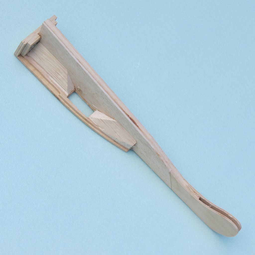

After filling in the nose area with soft balsa block and sheeting the underside I had an hour outside this evening with the sanding block. I now have something that ressembles a flying machine...OK , maybe not , more like a shoe!crook
And a snap of the underside, the sheeting was made in segments around the square boom tube. You can also see the exit holes for the rudder closed loop wires as well as open compartment to access the rudder servo.

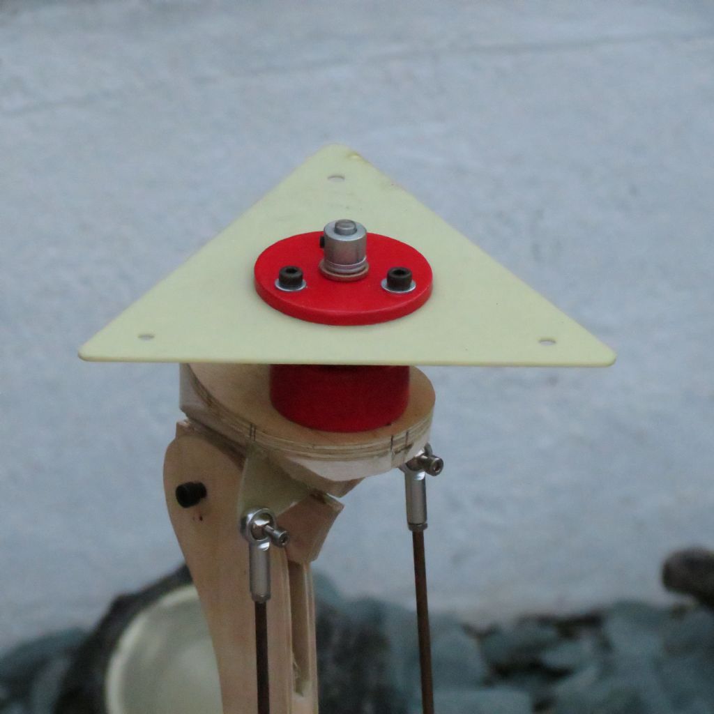

The HK head will be too small I think for this model, it is in fact larger than an RPG but should turn out roughly the same weight as there is a lot more balsa used rather than lite ply.
The head was made up this afternoon so I will give it all a rub down and it is time to start covering. I will fit all the radio in place and weigh it, from this I can calaculate whether the Panther blades will give the required disc loading.

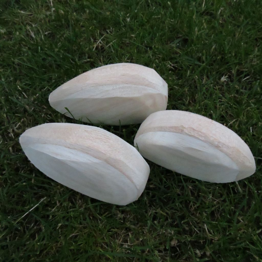

A slow few days progress due to work commitments, the head is finished and I have started to make some spats which need to be final sanded.
Blades are looking like they may need to be a tad longer than Panthers but the same width and aerofoil. I will try Panthers when the time comes to crash test.
Plenty of clearance between motor and push rods, even with the right offset of the motor.
Spats

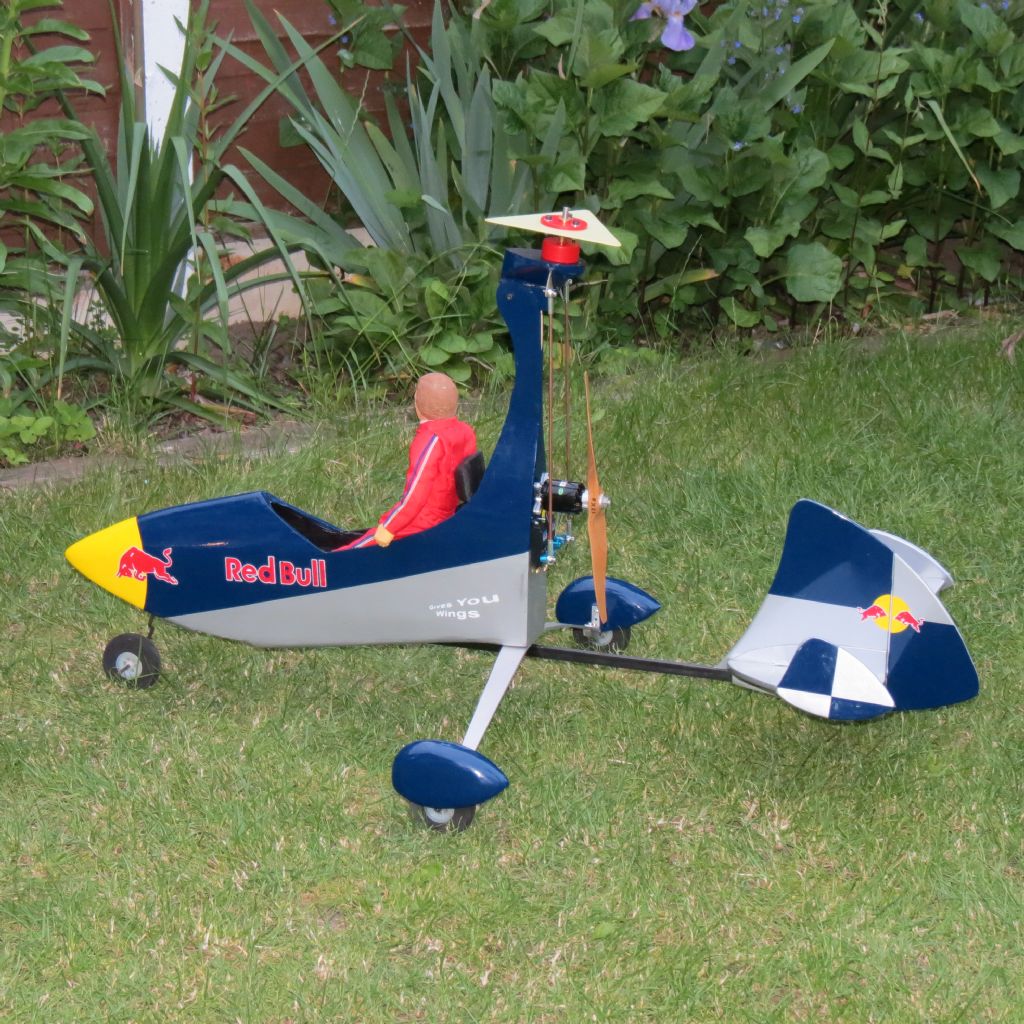

I have slapped a bit of covering over it going with a RedBull theme. Depron tail feathers were also covered but the iron's temperature was turned down a tad.
Not much left now , just need some wings and add a few finishing touches. Should be good to go this coming weekend if the CG turns out favourable.
