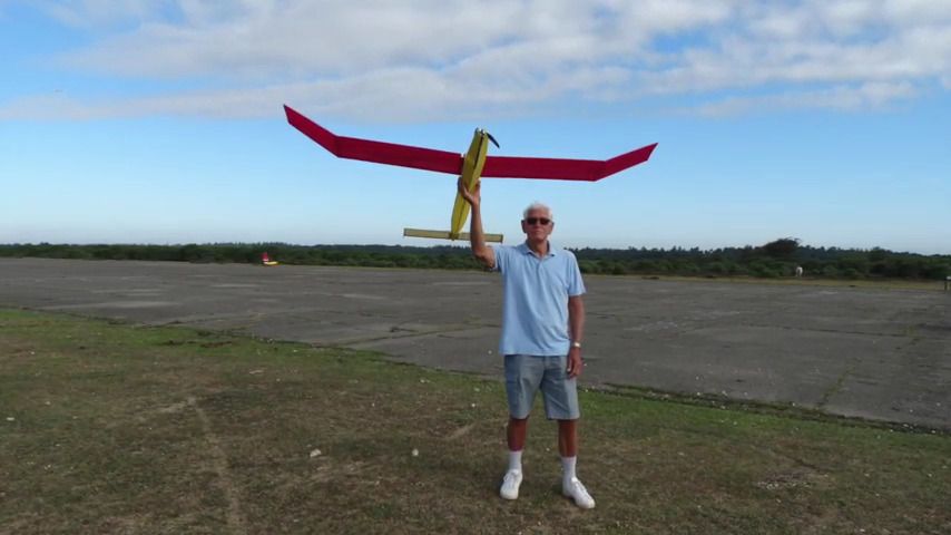

Here is my scaled up version of H J Nicholls 1952 glider design, the Mercury Marauder. That's a metre stick shown for scale
Span is 88" and power a 200W brushless motor. More details are on my summary build log on RcGroups vintage forum here

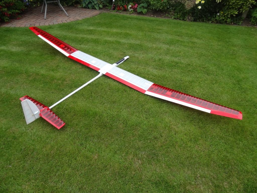

I took this glider up to the field today for the maiden flight. 3.6m wingspan "Element" glider by TopModel CZ. Weather was not really up to checking out its thermaling capability, just flew some gentle launches, a couple of full power motor runs and landings getting the mixes set up for launching and crow braking for spot landings. Flew very well, the sink rate was good and it could fly very slowly with a few mm of down flap. Runs on a 3S 3350mAh battery through a Turnigy Glider Drive 3858 4.6 840kV motor and YEP 80A ESC, 14x10 carbon prop pulling just under 600W. Total weight 2.1kg = 4lb 10oz. No one with a decent camera at the field for some in flight shots.

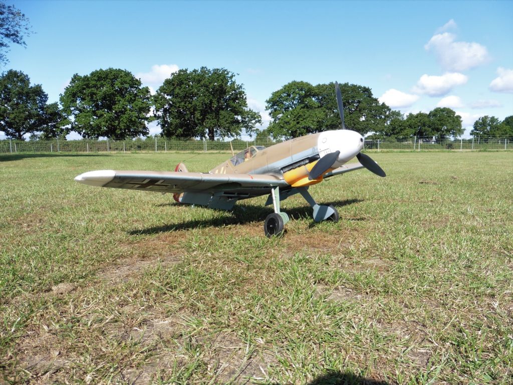

Just posted these on another thread, taken at the field this morning at its third flying session. Foamy ARTF obviously, it's the FMS 1400mm Bf109F, flies nicely on 4S. It is beyond my modest modelling skills and patience to create such a thing, I stick to building simpler designs, but I did enjoy applying weathering and replacing the rather small pilot with one to the correct scale. Now I look at the photos, I must do something to improve the wheel hubs!

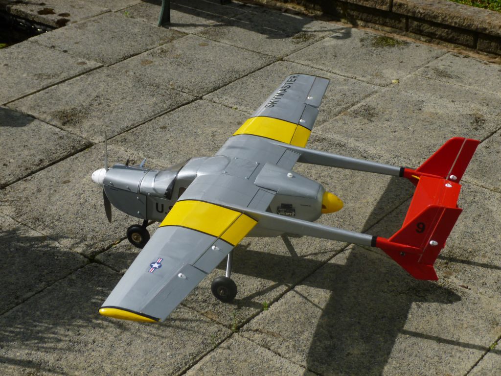

Hi this is my latest lockdown project --- A Cessna Skymaster .
I used Simon Delaney's plan of May 1993 as a basis .
I've modified it a bit .
The cabin is now fully glazed .
It now has working rudders and flaps . The elevators and rudders are driven by snakes in the booms .
The ailerons and flaps have their own mini servos in the wings .
The wing struts are non load bearing and are plastic loose leaf binder clips pushed over small ali . brackets on the fus .and wing .
The under carriage is a bit too long as I am concerned about prop clearance on take off . It's currently sporting a10"prop .I could go for a 9" three blader as previously suggested but I'll try this out untiI get a feel for things.
It is powered by a Thunder tiger Pro 40 and uses an in cowl silencer .
I'm waiting for some decent weather to see how it performs . To balance the plane about 3 grammes of lead was necessary at the end of the booms giving a high wing loading of about 29oz.. per sq.foot .
Oh well we shall see ! ! !

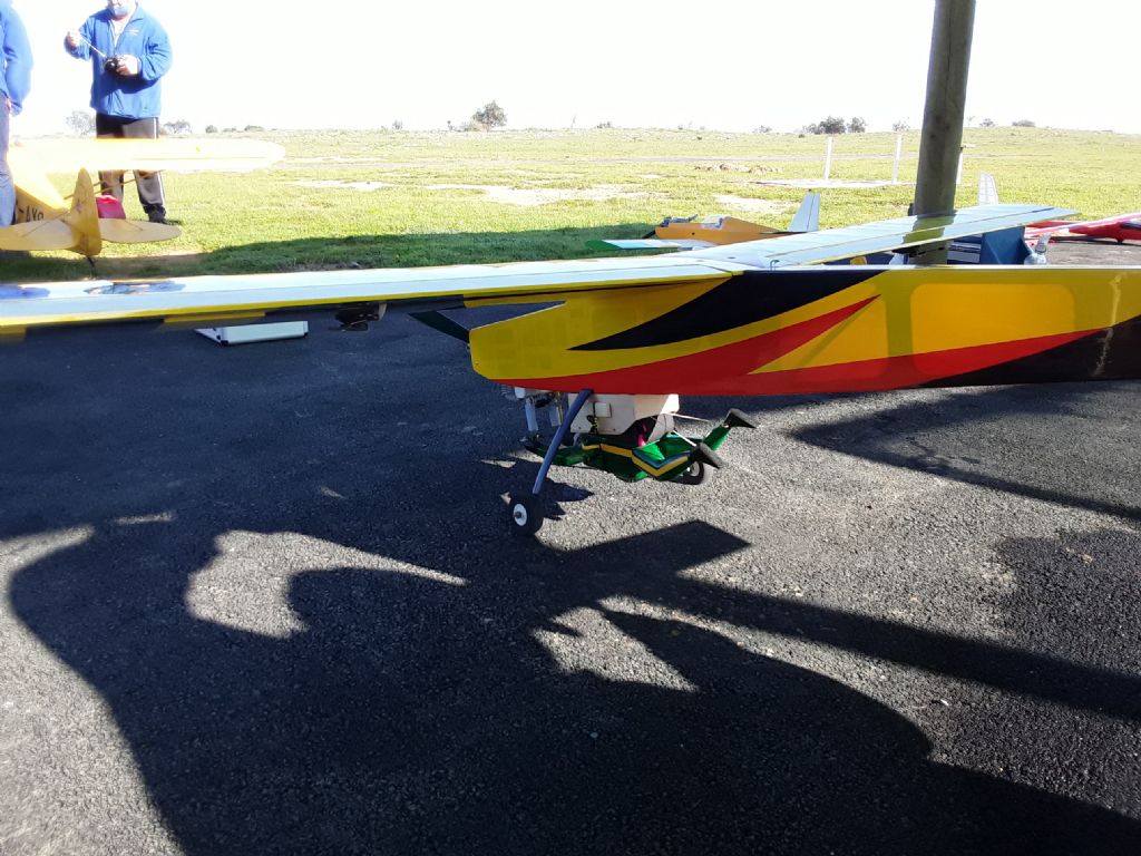

This is not a new model in the strictest definition of new.
In that the model was completed in Novemberish, the weather then intervened in delaying the first flight, immediately followed by the Corona Virus and subsequent restrictions.
The first flight took place approx two weeks back. It was most fortuitous that that the grass on the field had been cut, albeit with the cut grass left to be dispersed by the sun to dry it and the wind to finish its removal. My test pilot checked out the model for control surface movements. The model placed in the centre of the field, throttle opened, the model raced across the surface with all the urgency of a racing slug, on Valium. Finally it was eased into the air, swinging left, which was arrested by the pilot. Slowly the model gained height, where a number of checks were made. Firstly response to ailerons, rudder and elevator, secondly stall characteristics. The test pilot then called for a landing, as the power was only just adequate to stay in the air.
We then had a discussion, where it was decided that the model was vastly underpowered, secondly that the CG was probably a little to far forward. I decided that the initial change would be to re-battery from 3s to 4s. I would then move the CG to the mid position (by removing the nose weight) If the power was still inadequate I would re-motor.
A check of the motor on 3s was showing a little over 200w pulled, on a 4s this went up to 360w (approx 1/3rd improvement).
The next good day had us back at the field, a bit blowy. On attempting to arm the model, I discovered I had left the conversion plug at home. At present I am going through my collection of models and converting them from Deans to XT60 plugs, which mainly involves the ESC, in this case the ESC was done, this old, seldom used Lipo was still on Deans.
This week-end was yet another good day. Back at the field the model was once more prepared and checked. This time the model raced across the field like racing Pony, on its 360w. My pilot did say, you know with a horse up front or 760w it would be a real monster. Who remembers those lectures with respect to James Watt his horse and deciding that a horse power would be 33,000 ft lb per minute? The good news is now the model takes of with authority, no tendency to swing left being on the stall. The roll rate is adequate, inverted flight good, loops good, spins reluctantly entered in both directions, stall turns fine.
So + 6 months down the line the model is OK. Just about ready for me.
Edited By Erfolg on 27/07/2020 12:20:17
Carl, what is that? looks a little bit like the Webbit (which I destroyed a few years ago) If so than it has a wingspan of approx 110cm. Mine was totally overpowered, could fly vertical.
BR Vecchio
Gerhard, I call it a Kunststoff Flugel, It is a foam wing bought at our clubs Bring and buy sale, It was intended to have dihedral, soon got rid of that.
The body is a totally novel concept, being a 36" long sheet, by probably 3". Everything else is by standard proportion, and what I had in my vast array of lovingly collected artifacts (some say junk).
I have now managed to squeeze a second flight in before the weather broke. As the Mutti would say "ganz einfach, gewohnliche. It does fly very well, then again, it is ordinary, so no surprise.
I may rename it "Toll", but I do go over the top, sometimes.
