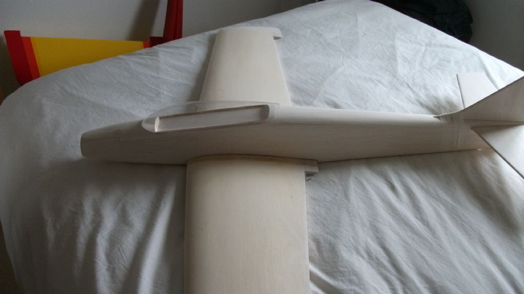

Hi Ian, Not sure if it's clear from the pic but it's worth adding strips of balsa along
the canopy base to increase contact area a bit.
Also consider adding an internal piece of balsa near the apex at the back of the canopy.
Not completely necessary but that joint position can get thin with all the planing & sanding.
The bullet is a very therapeutic model to build - especially if you're keen on planing
& sanding fuselages.
This fuse was eventually covered with medium tissue & Poly-C.
