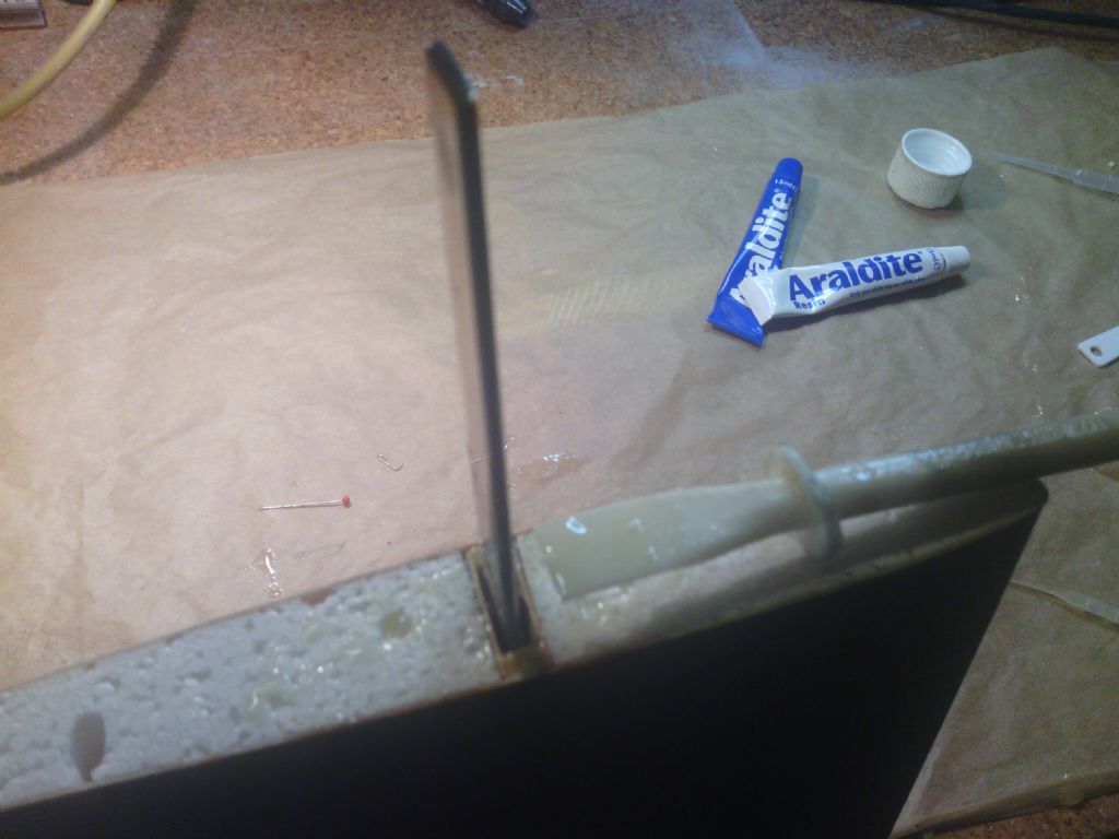

Well tonight and today I attempted to secure the wing steel rod and brass square tube. I was using a new tube of 5 minute epoxy which one smears on the bottom of the rod and tube. Unfortunately the hardener did not come out so the glue didn't set. So I tried again and there was not enough to sercure the rod, so thired time lucky. What a phaff.
So then it was time to fill the voids round the rod and tube with epoxy. Advisable to use 1 hour it said. I found some Araldite - even stronger. I decided to dilute it with meths - bad move as it was too runny. I also tried the syringe method as suggeted - didn't work as the tube got air into it and wouldn't squeeze through, so I abandoned that idea and decided to push it in with a paired down glue speader - worked img_20150708_210156.jpga treat. So now I am waiting for it to dry. I think I will put another layer in once the first layer is dry - will take overnight.

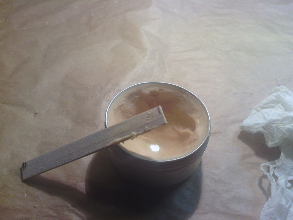

I had to block off the brass rube.with something to stop the epoxy from leaking inside, so I made a piece of balsa and covered it in mould anti release wax.

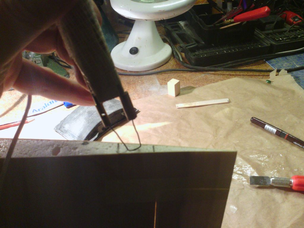

Now is a good time to check whether any of the Gorilla glue has found its way into the flap hinges. Hopefully you will be okay since your hot wire cutter gives you more control over the depth of the hole than my scalpel and screwdriver hacking method!

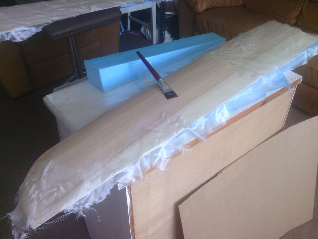

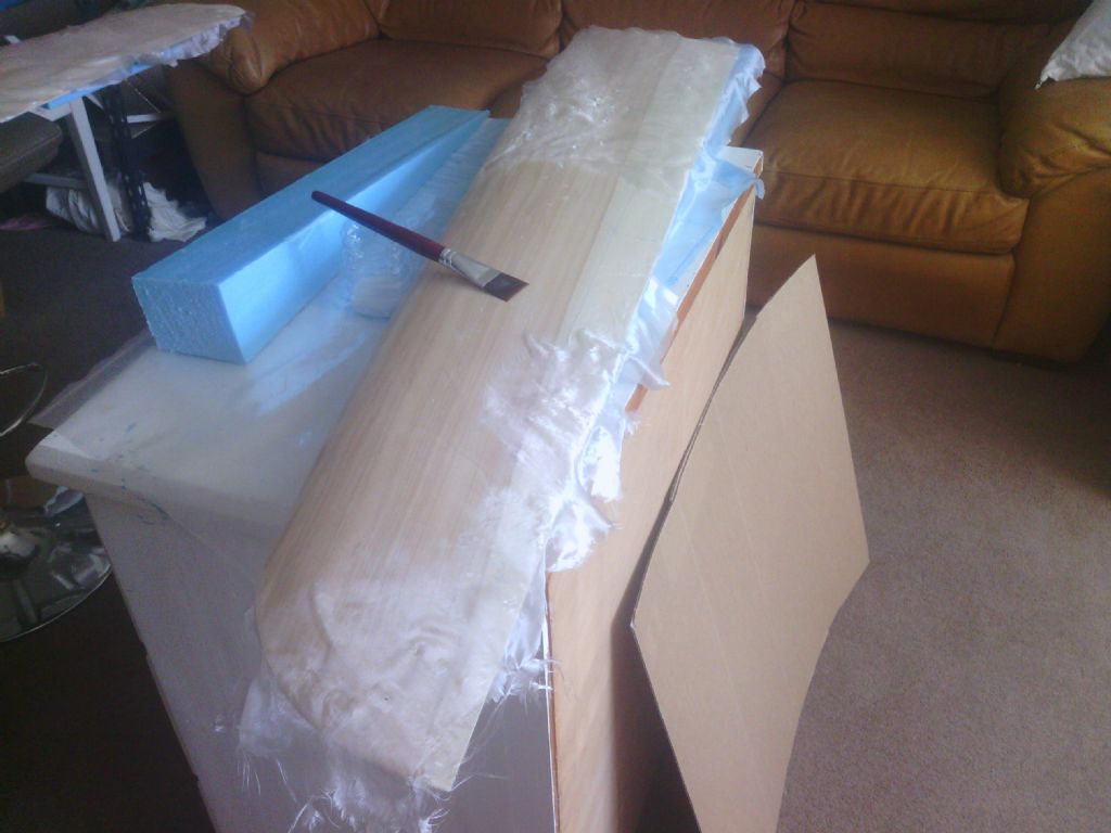

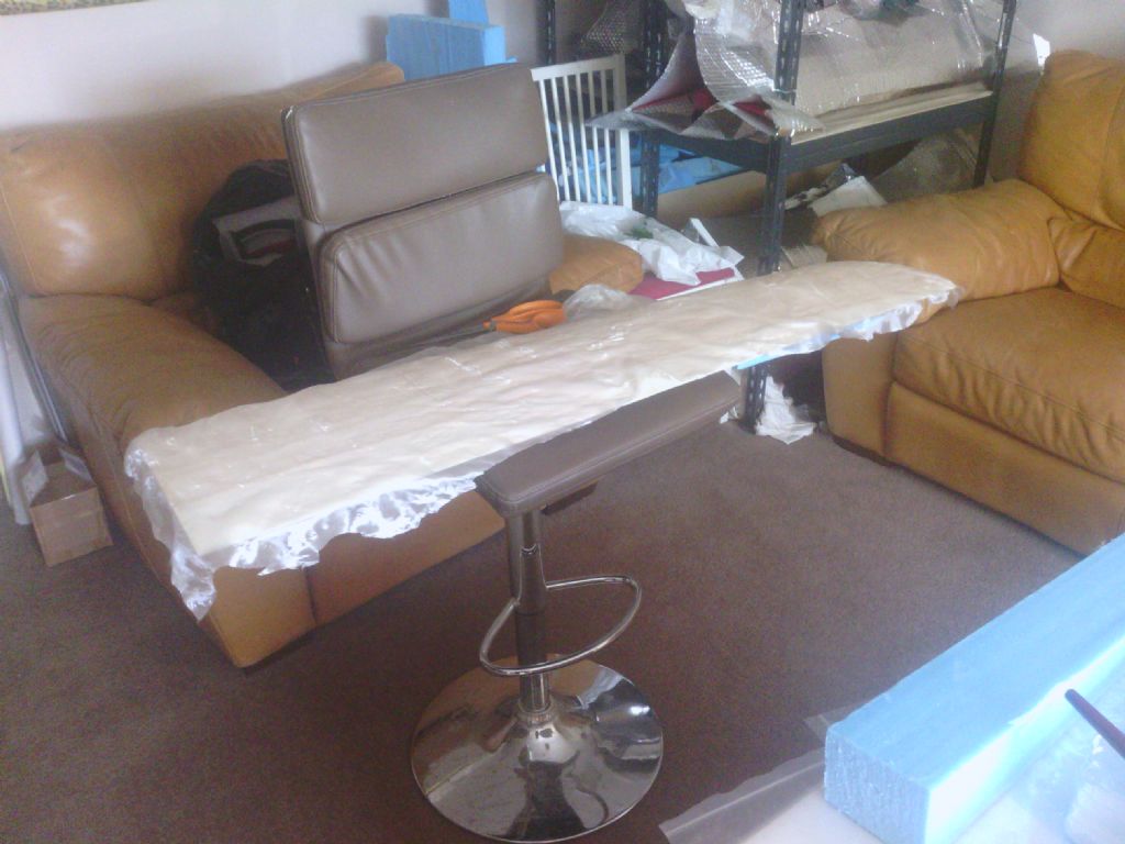

I decdided to cover the wings with 25gram fibreglass cloth and Eezecote the water based resin. Need quite a lot and have seen a debate which says Ronseal Hard Coats Floor Varnish is much cheaper.
I reckon that the varnish acts a bit like balsaloc and helps the film stick. Also it is going to be the same weight as paint?
Have added the top sheet of fibreglass cloth now and the wing pin locators, which are not supplied with the kit remarkably, so I used up some left over short lengths of 4mm carbon rod. Will probably be OK as they are just intended to line up the wing halves when joining them.

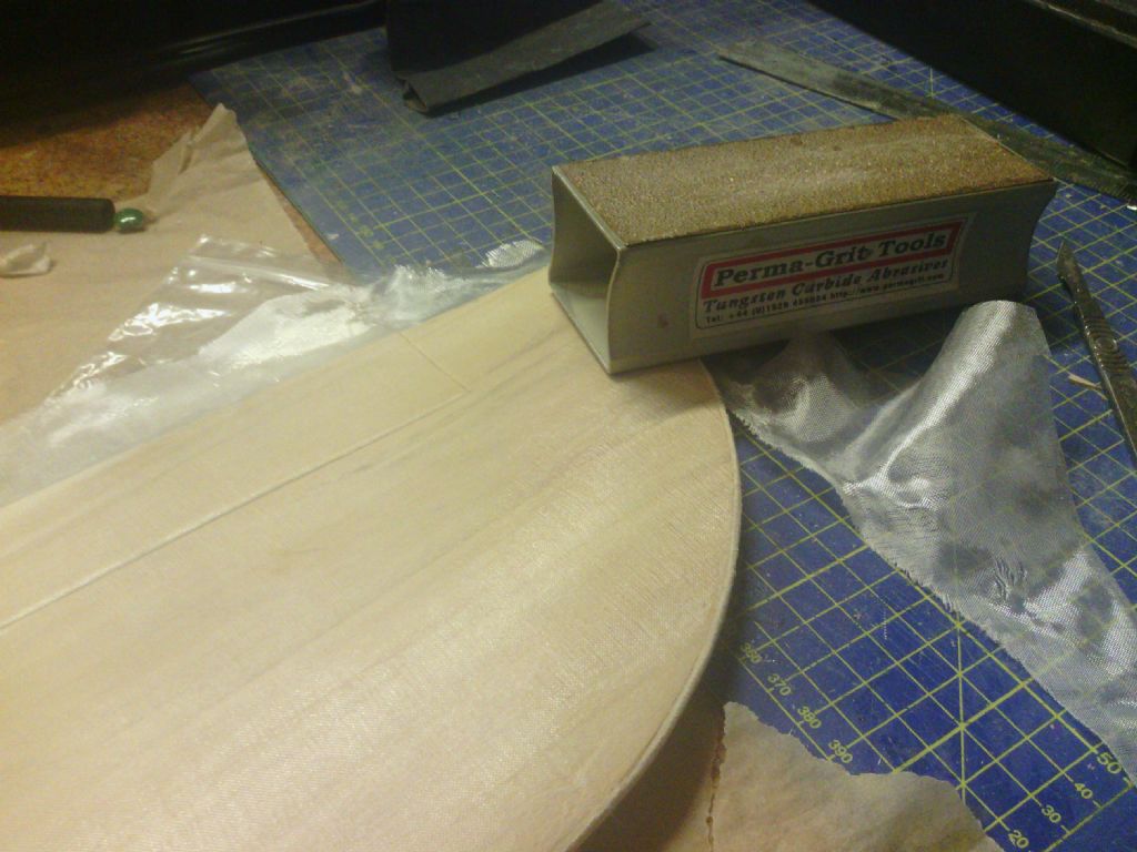

To finish the fibreglass cloth edges one just sands off the cloth. Have now given it another coat which will be enough with film on top.
