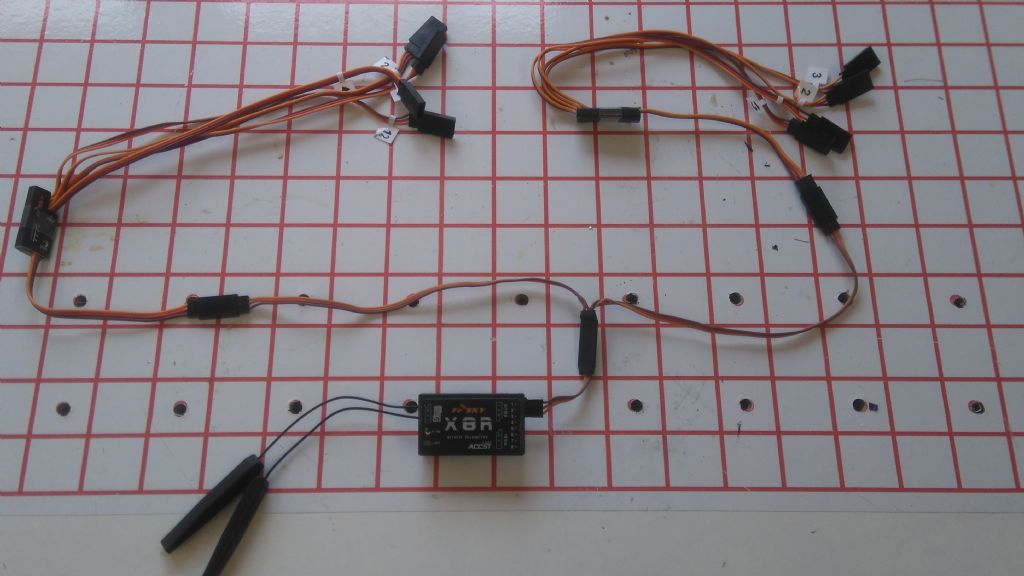

So here is a proposed schematic wiring diagram for the model. You can see the X8R as the black box in the lower centre. We plan to take six channels out of the standard 8 servo outputs, namely: rudder, elevator, throttle, mode, gun sound and aileron M. These are shown coming out of the left side of the X8R box. At this stage don’t worry about what all these are, I will explain them as we go along.
The SBUS connection is shown coming out the top of x8R box (simply for convenience) and heading towards the wing which is represented by the orange dotted box – so this shows the single servo lead connection to the wing that we want.
This single lead is then connected to Y-lead which splits the SBUS single so it can enter both the right and the left wing. Note that both these righ and left versions of the SBUS signal have all 16 channels on board at this stage. We will discuss what then happens to these in the next post…..

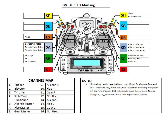

Here we are going to discuss how will set things up inside the wing, but before we can do that we need to assign all the channels we will use. I do this with a Tx planning template – this shown in the picture below, again you might want to click on it so as to see it clearer:
As you can see this details exactly which of the 16 channels will carry the left aileron signal, the right aileron, the left flap, the right flap, the left retract and the right retract. Look at this alongside the wiring schematic in the previous post it becomes obvious that the right wing leg of the SBUS Y-lead will be delivering channels 9, 10 and 11. While the left wing leg of the SBUS Y-lead will be delivering channels 12,13 and 14. All very good, but how? How, especially as we will be using standard servos – not specialist high cost SBUS servos?

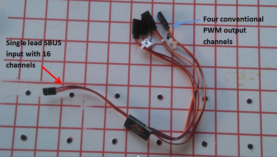

The answer is that we will use two of these, one connected to each leg,…
These are SBUS to PWM decoders, the SBUS signal enters on the single lead side and we get 4 conventional PWM channels out. So this will give us four channels in each wing. But how do we control which 4 of the 16 SBUS channels appear on the outlets? Easy, we use one of these gadgets, a SBUS channel changer,….

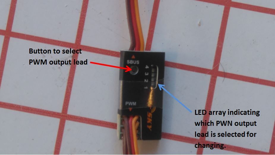

The upper number, with the red arrow pointing to it, tells us what channel a particular PWM outlet on the decoder connected to the changer is currently set to. The lower number, indicated with the blue arrow, tells what channel number it could be set to by the changer. We can change which channel it would be set to by toggling the wheel on the left hand side of the device. We can select which of the four outlets we are operating on via a push button on the decoder shown in the picture below,…
Each push of the button takes to the next outlet of the four.
