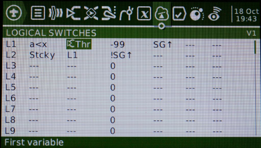

MattyB Posted October 18, 2016 Share Posted October 18, 2016 Logical switches example 1 - the sticky throttle cut OK, so as promised here is a simple example of how logical switches can be cascaded in sequence to provide more advanced functionality. Since BEB has already outlined the basics of logical switches in previous posts above I will assume you’ve read that, know where the screen is and are comfortable with the idea that OpenTX uses Boolean operators (AND, OR, NOT etc.) extensively to define how the switches are triggered. I am also going to assume that you will do this in Companion rather than on the TX itself, though of course the process is fundamentally identical (I just can’t take screenshots from the TX!). What example shall we use? I have chosen a “sticky” throttle cut for electric models. What’s one of them then?! Well a traditional throttle cut is useful for electrics, but has a dangerous failure mode – if you flip it by accident when the throttle stick is raised the motor will go instantly to the throttle level set by the stick with potentially nasty consequences. To avoid this we will setup the throttle cut so that two conditions are required for the throttle to become active – throttle cut switch is off AND throttle stick is at zero. If you look carefully there is a clue as to how we will do this in the previous sentence! So, off we go … Like all problems in OpenTX it’s best to break it down into manageable stages. In this instance they are: Setup logical switches to test for the target activation condition (throttle cut switch off, throttle stick at zero); Setup a logical switch that can trigger enablement or disablement of the throttle; Link the logical trigger switch to the relevant lines on the mixer screen to actually make the sticky throttle cut work. Edited By MattyB on 18/10/2016 15:16:41 Quote Link to comment Share on other sites More sharing options...

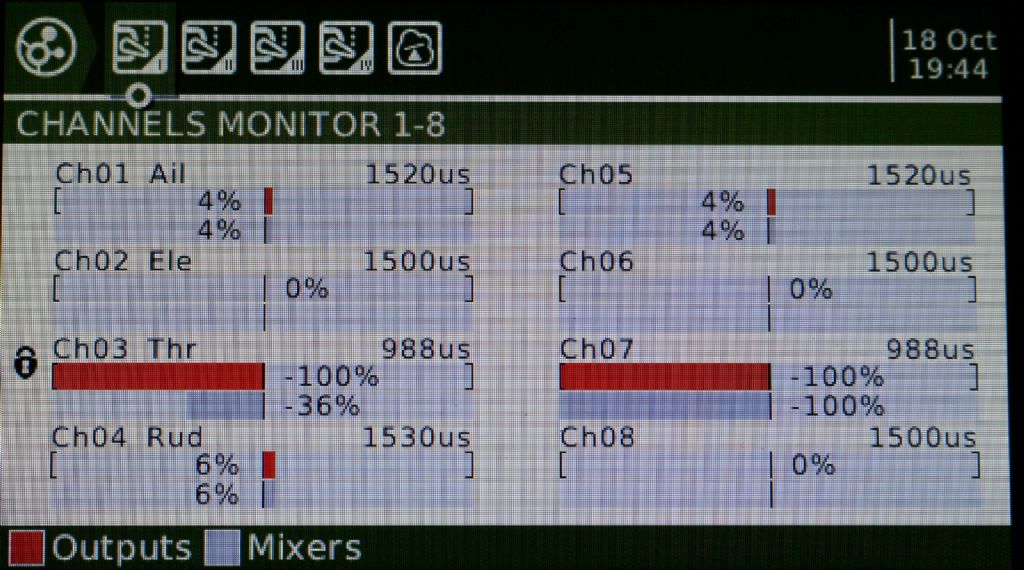

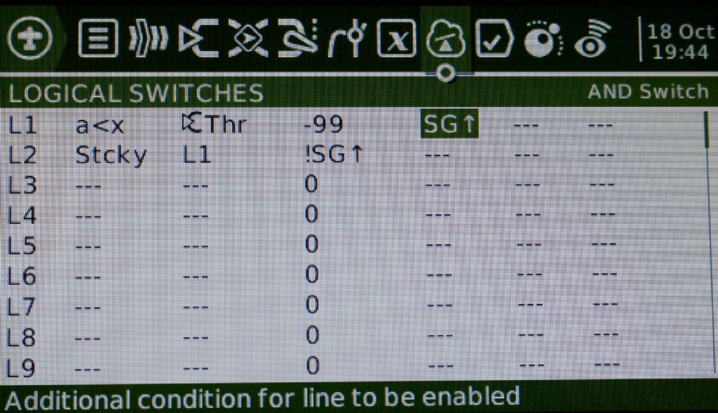

MattyB Posted October 18, 2016 Share Posted October 18, 2016 Let’s setup the test conditions first. I want the Throttle stick position (Thr) to be at the very bottom, and switch SF to be up (towards me). SF is just my choice; if you want to use another physical switch and/or the alternative direction, feel free. Because all logical switches have an optional AND operator at the end of them in addition to the other variables in the switch we can actually do this in a single switch line: Next we need to setup the logical switch that is used to activate and deactivate the throttle. For this we use a special type of logical switch, the “Sticky” switch. Sticky switches are activated by one specific condition (which can be physical switch, another logical switch, flight mode change etc.), and stay on until they are deactivated by another specific condition. In this instance we want the trigger to activate the throttle to be the logical test we configured as logical switch L1, and the off condition to be flipping the throttle cut switch SF back (away from us). The Logical switches screen therefore now looks like this: Important note – In this setup the throttle will be activated when L2 is ON, and inactive when L2 is OFF. You could of course reverse this logic if you preferred by reconfiguring the switch to one based on a>x, V2 = -99. That’s it for the logical switch screen, but before we go click the Simulate button and validate that L1 and L2 trigger when SF is down and Thr stick at minimum, and are both turned off when SF is flicked back to its original position. Edited By MattyB on 18/10/2016 15:19:27 Quote Link to comment Share on other sites More sharing options...

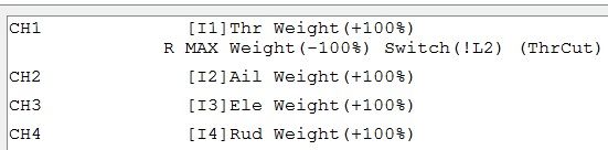

MattyB Posted October 18, 2016 Share Posted October 18, 2016 Now we need to do step 3, linking L2 to the relevant mixer lines. Go to the mixer screen and drag down the existing throttle mix line to create a duplicate, then double click it to open the window where we set the parameters. Name it “ThrCut”, set “Source” to MAX (this is used whenever you want a servo to move to a specific position and stay there without moving) and “Weight” to -100, like this: Now the clever bit… We want this mix line to REPLACE the one that allows the throttle to work when switch L2 is NOT on. How do we do that? First click on the “Switch” parameter and you will see there are two sets of switches – one set scrolling towards the bottom without an exclamation mark in front (i.e. L2), and one scrolling up with an exclamation mark (i.e. !L2). The one with the exclamation mark denotes it will be one when the specific condition is NOT true, so select !L2. Finally under “Multiplex” select Replace – the dialog box should now look like this: Click OK. Your mixer screen should now look like this: That’s it! Click simulate and you should have a working sticky throttle cut which can only be activated when the throttle is at minimum AND SF↓, and is deactivated when SF↑. If you like you can also have the TX play voice alerts when throttle is activated and deactivated – trigger them off SF↑ and SF↓, or L2 and !L2. Not too hard! That’s all for now, but next time we will build on this with an advanced version of the throttle cut linked to flight modes. That may take me a bit more time to explain though… Edited By MattyB on 18/10/2016 15:14:57 Quote Link to comment Share on other sites More sharing options...
