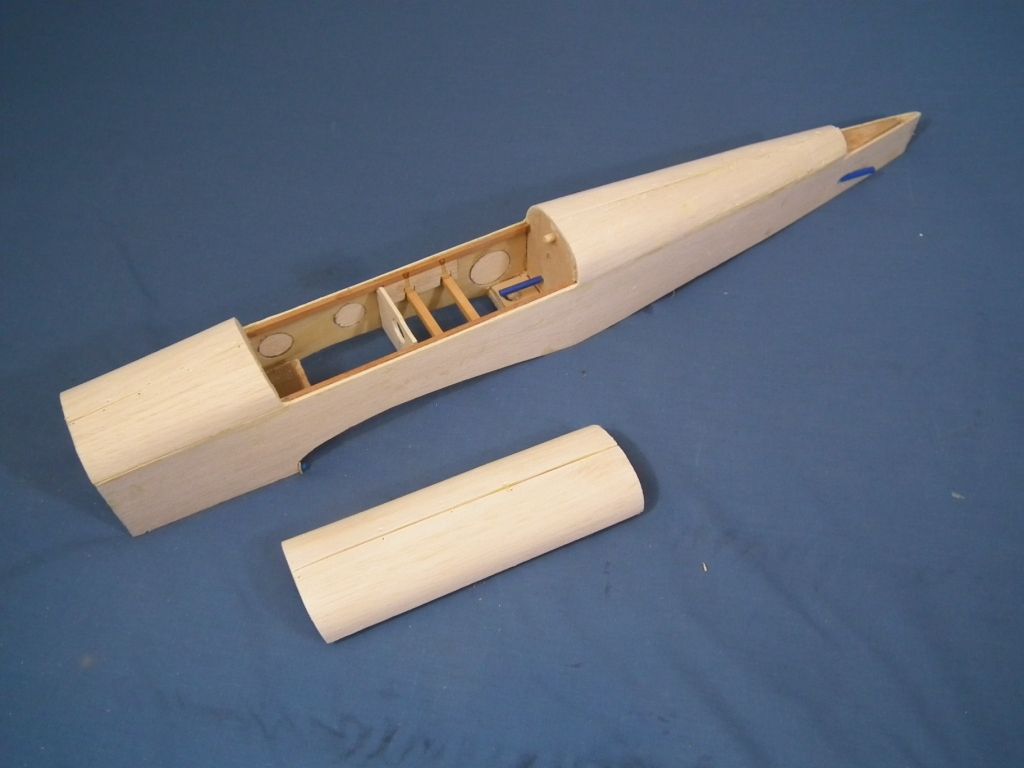

The fuselage is pretty conventional. I did cut lightening holes in the 1/32" ply doublers and selected very light wood where possible
The styling is basically Ryan STA influenced.
The battery platform is well forward, Hope that is not too far forward.
I found that the leads were not long enough so had to open the hole in the firewall up so the ESC could go in through the front.
Under carriage mount is my standard arrangement but only using 10 SWG wire

The rolled sheet decking has now been added.

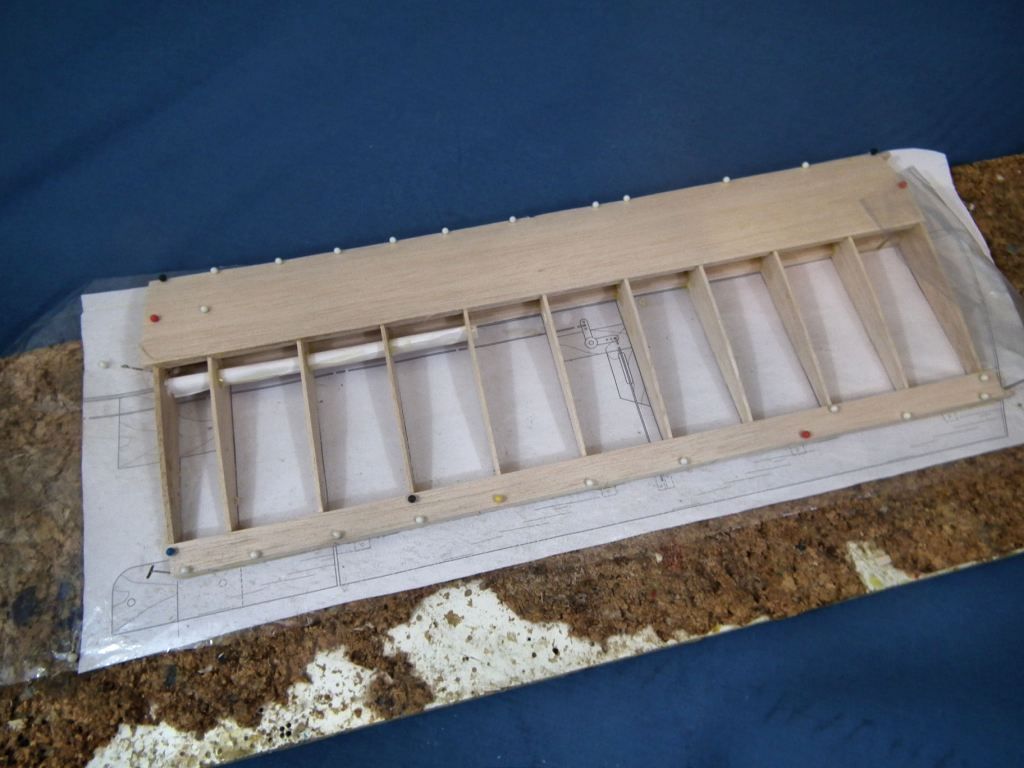

The wing follows my standard sequence which guarantees a warp free wing. Built over the lower sheet.
The right wing is then covered with the top sheet before lifting from the building board.
It is joined to the left wing and then the left wing has its top sheet added.
Note the use of clamps to hold the sheet to the spar. That is why my webs go in front of the spar.
