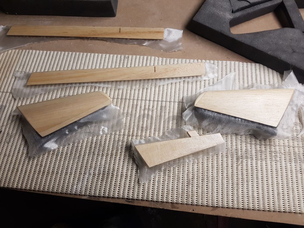

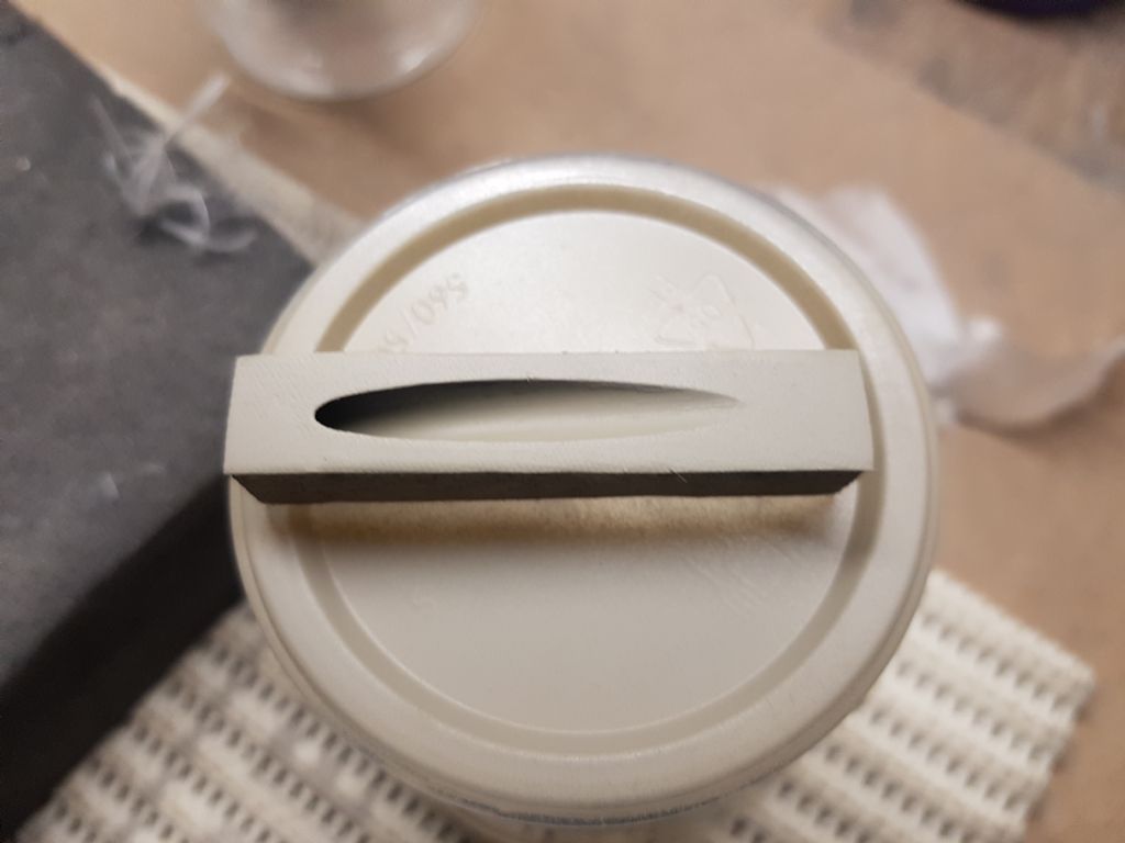

cleaned up the glassing of the test gunport and to my surprise it worked out very well !I had doubts that the epoxy would be hard to sand where the glass stops.With a little primer on top they seem indeed smaller !

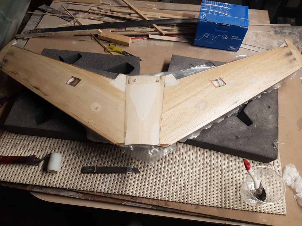

With enough time left i took a shot at the glassing of the bottomside of the wing.I prepared 30gr epoxy and cut the fabric oversized. I allways place the glasscloth on a dry covering surface and once positioned secure it with dots of resin brushed on.I then continu dividing it with a spunge roll.Do not roll in one direction because you will pull the fabric away,instead roll back and forth until the resin has ''filled'' the cloth.Don't try to cover the 90° angled sides , like the inside of the aileron cove.This just needs a coat of resin. Wrinkels in the fabric can be rolled out by rolling in one direction,pulling the fabric to the edges.Leading edges are best done with the roll perpendicular with the wing. Everything past the centerline will be cut or sanded away.The same for the wing- tips.
All these tips are based on experiance and i'm sure there are other way's to do this job,it's just my opinion on the matter...Take your time for this,it can ''make or brake''your model
Last tip :Use slow curing epoxy ,it gives you more time !(like 1hour drying time)

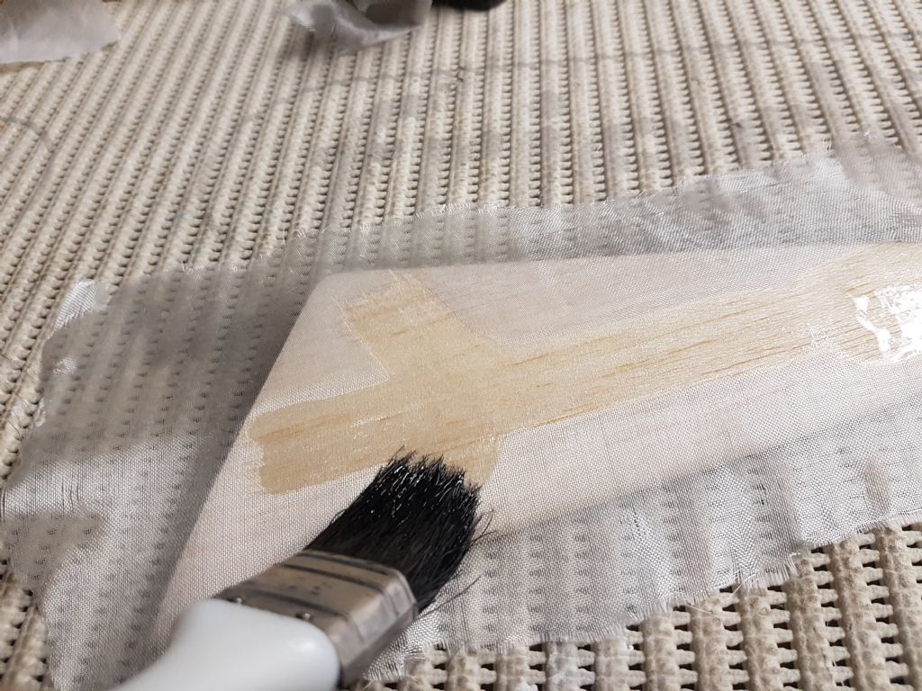

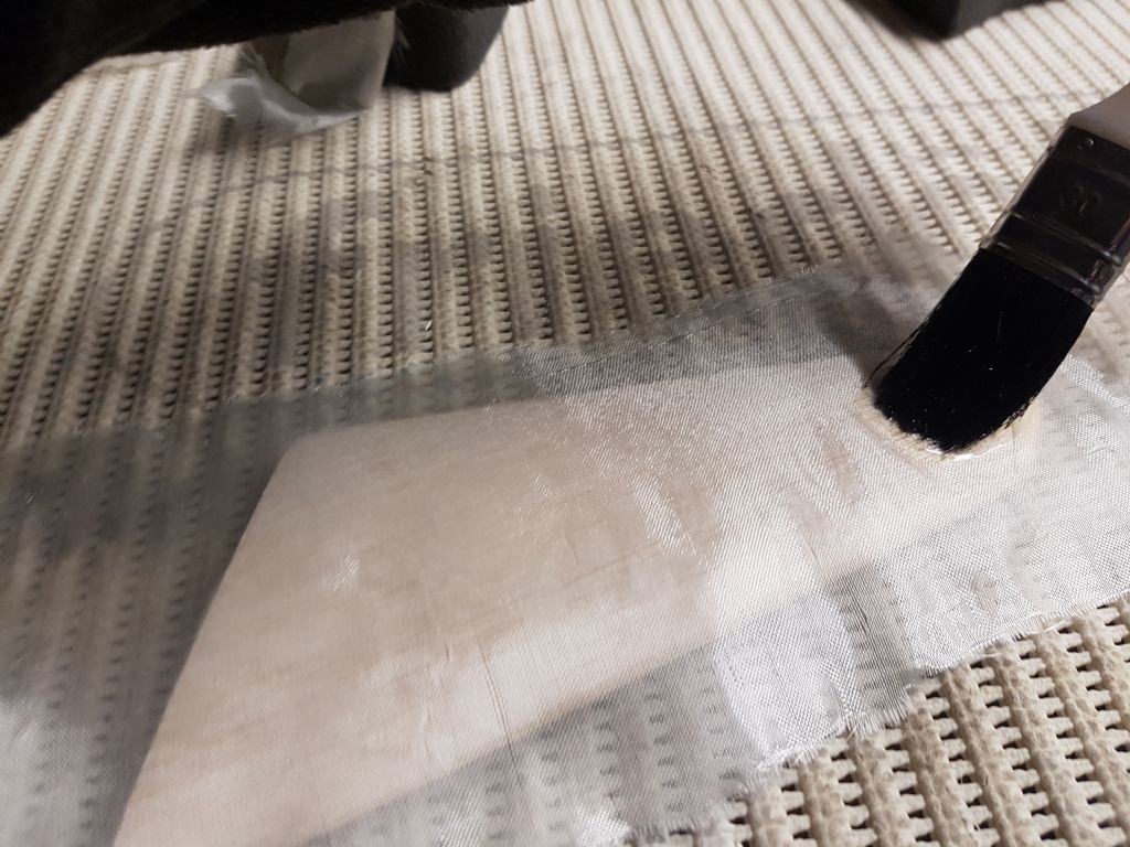

Just a little detail on glassing parts
Positioning the fabric on a dry surface and securing it with resin
Roll the resin out ,don't be economical with it,the roll wil absorb most of it
Get the wrinkels out by rolling to the edge. Take the part in your hands and roll the edges,using enough resin,you need to roll it into the wood!
When dryed overnight ,sand the loose fabric away and brush-on some resin on angled sides and places where there's no fabric like aileron tips,hinge slots etc...Use enough resin and go over it with a rol ,done
Hope this helps the ones who never did it....glassing i mean !!!embarrassed

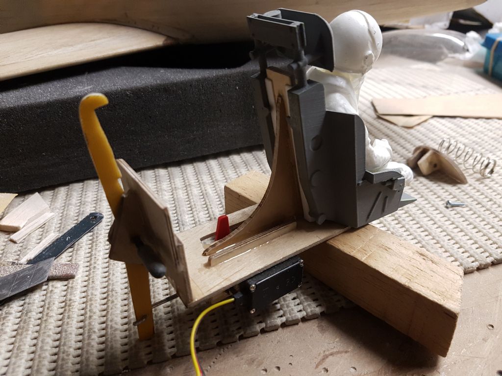

Anyone who's installing a pilot will find that the jockey needs surgerie on his legs ...Mine did anyway ...

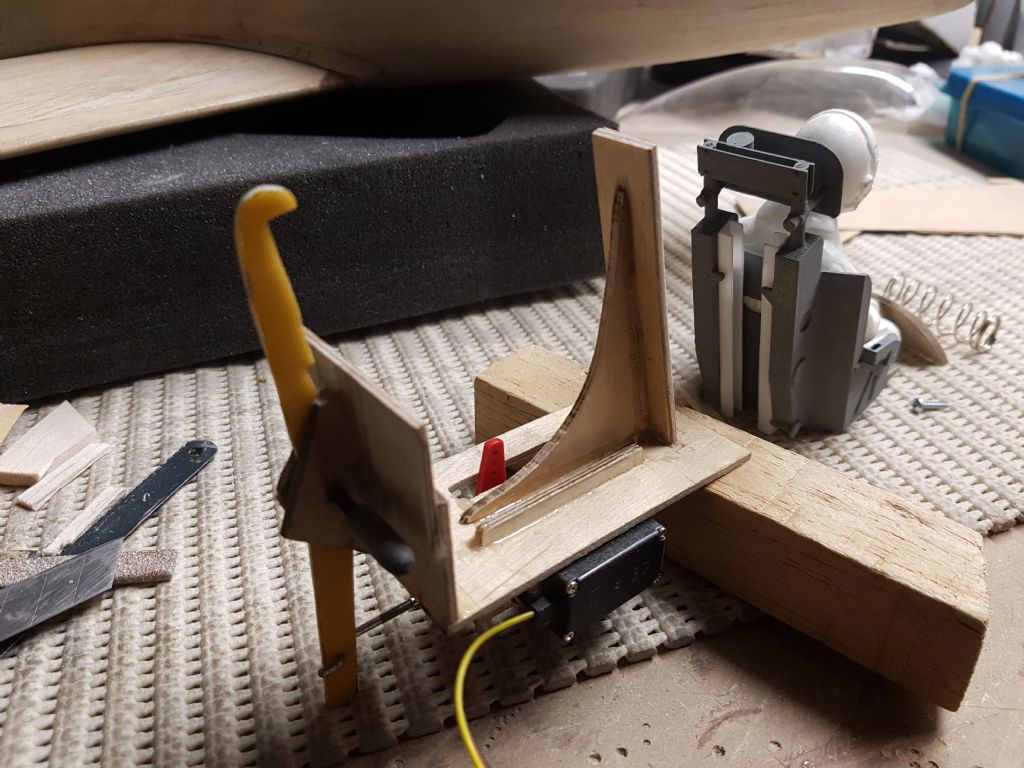

In the back of the seat i placed two U-shaped sliders (ABS)to guide the seat out...
The ply sliding plate is glued to the eject installation and gets supported by a ply triangle.When everything is complete and working i will try to lose as much material as possible to get the weight down.
On the red servo-horn comes a pushrod right trough the spring loaded seat (bottom )to prevent the seat being ejected.On the opposit horn (out of sight)comes the pushrod who releases the canope via the epoxy hinge(hook)

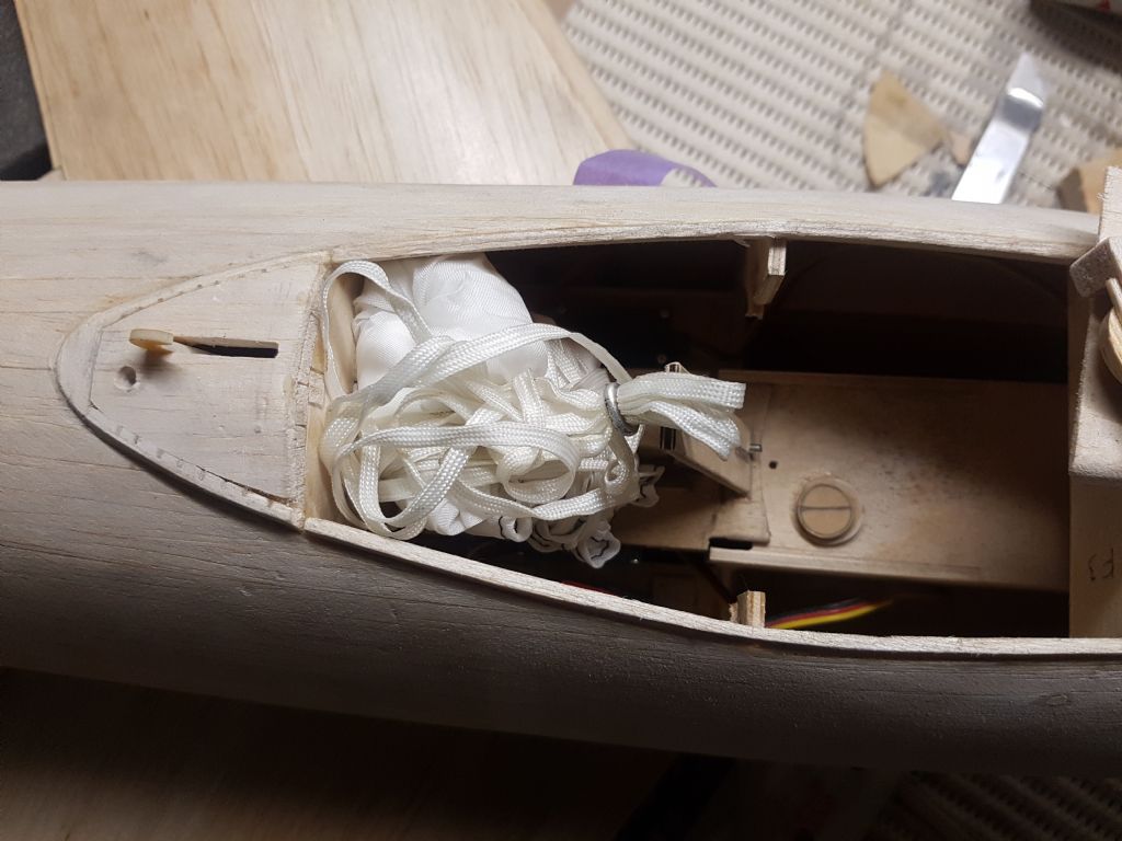

The area behind the seat will be closed by the canope base and contain the parashute.Once the canope is thrown-off ,the shute will hopefully be pulled out by the seat embarrassed!!
Remember ,this is just a try-out ,and when it gives too much problems it stay's on the shelf.

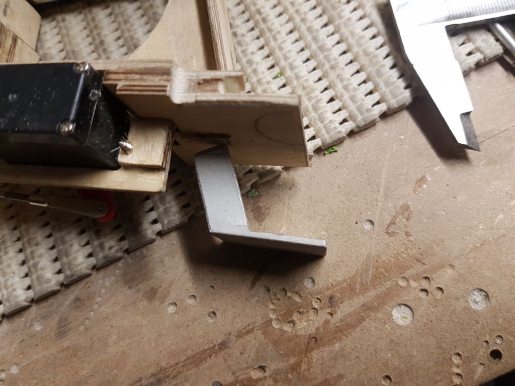

More work on the bang seat :
I made a little reinforcement in aluminium to take away the stress between the ground plate and the sliding plate
In it's place it looks like this :Just needs a little rivet to hold on to the sliding plate reinforcement triangle20200318_213900.jpg

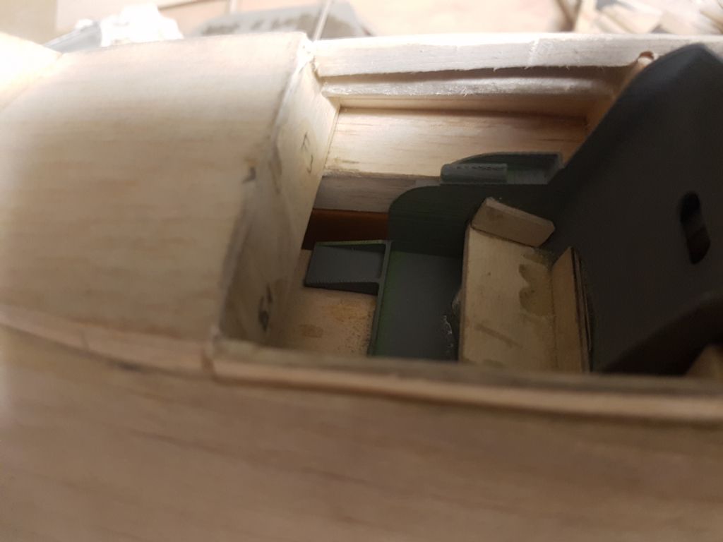

The canope base ends just behind the seat ,so there's some room for some furniture
The hole at the rear is the housing for the spring who blows away the canope once the hook has released it,i hope...At the far end you can see a carbon dowel glued in to keep the canope in the right position.
Under this base is the room for the shute.You can see here (at the far end)the hole that houses the carbon dowel.Left of it is the canope release hook operated by the servo.
The little round piece on the battery box holds the seat-spring in the right place,under the right angle(oblique)At the bottom you can see the servo -operated pin that holds the seat(now withdrawn)
The last work in the cockpit area is to put in some side panels,left side with a throttle.
Blank on the right side.These will get a decal with some nobs and things...
