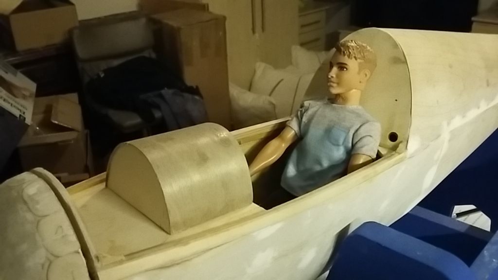

This shows the assembled canopy and cockpit with Barbie Ken sitting on a seat made of 3mm balsa at the right height. A tailored pilot would at 1:5 scale be a not inconsiderable sum of money whereas Ken was £11 and I thought good enough. The problems are that he is wearing a T Shirt and I want him to wear a coat. Also I want a cap for him. My wife has kindly agreed to make one for me. I am going to fabricate some headphones and a microphone.
I was trying to bend his arms to hold the joy stick together but got the heat gun too close and singed both his T Shirt and some of his face. I have done my best to touch it up with acrylic but he looks a bit dodge.
I am going to velcro him to the seat and leave this until painting time. Obviously, when painted white and the instrument console finished, I can add the clear canopy as recommended by Chris using thin masking tape to mark the outside line.
I have ordered some 8mm x 3mm magnets.

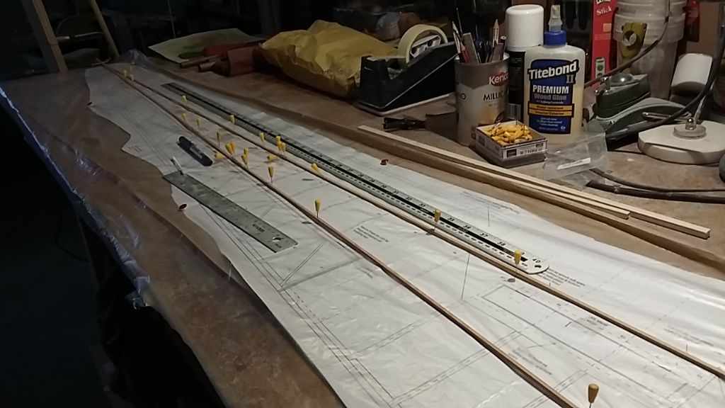

As the wings are so long and wood usually comes in 3 foot lengths one has to join the spars making sure that the join is between ribs so it can be reinforced with the .8mm wing webbing (grain vertical presumably as usual). Epoxy is recommended.
I lined up the pieces over the plan to make sure they are straight. Incidentally this is the full size plan which Chris kindly sent me. The Sarik Version is on the 4 sheets as per the Free Magazine entry which is fairly challenging as the wing is over 4 different sheets.

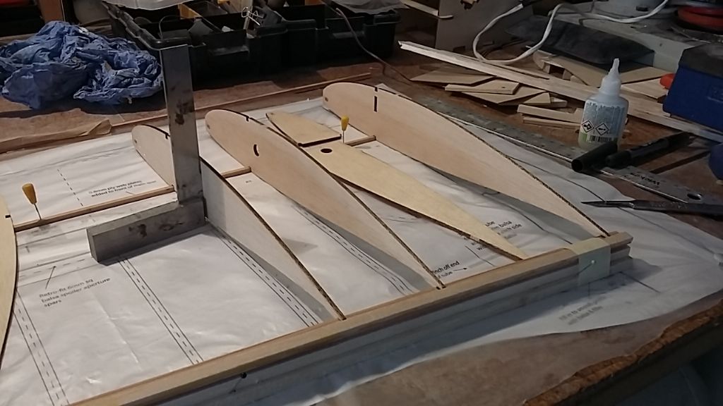

Starting at F1 and working up the wing one uses cyano to fix the ribs which are undercambered at the trailing edge and not really flat anywhere. I marked the position with 2 pen lines on the spar and TE as you only get one crack with cyano.
Also makes sure the TE is lined up. It is so packed up by 15mm that eyeing up the edge is tricky.
I used engineers squares to keep the ribs vertical which are such a great tool. I also have a tailor made plastic thing but it can move the rib when you pull it off if you are not careful.

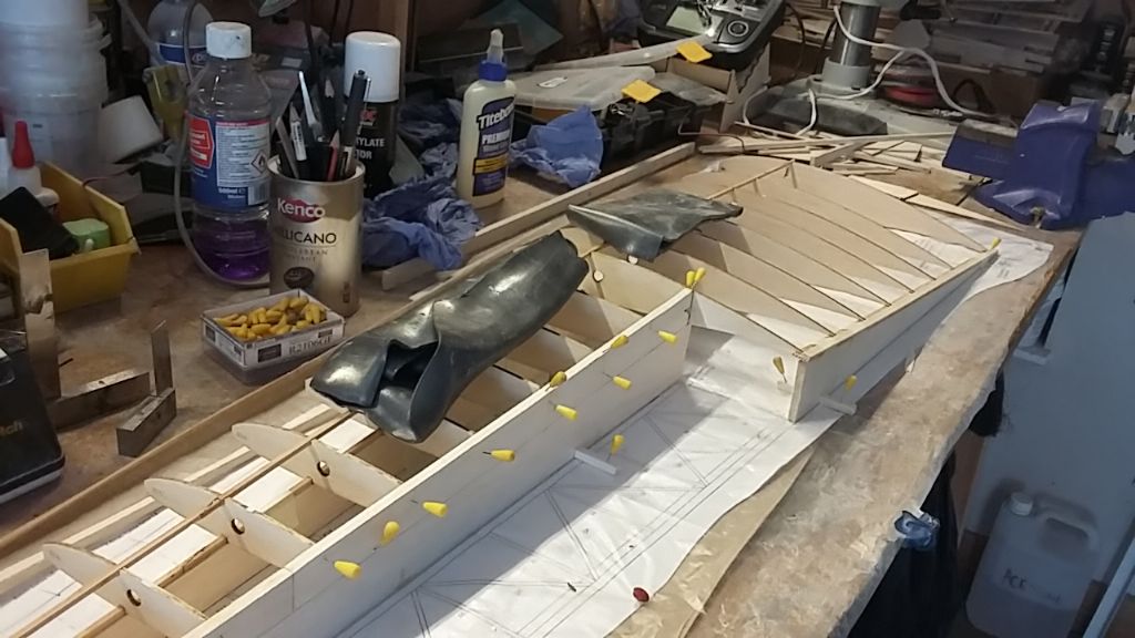

This shows the gull break at R9 where one is advised to glue in some wing webbing - incidentally with the grain running vertically not horizontally as usual. I am also going to bridge the joint in the balsa false leading edge with some 3mm as advised.
This picture also shows the extra half ribs R8A and R10A glued in place to take the piece of sheeting which spans this gap later on.
This shows the tip of the wing, some selected webbing glued in, and the overlap of the spars for cutting off when set. I know this is pretty obvious but it is worth saying. To cut them to size, I rested the spar on some block balsa then used a razor saw to avoid an unclean joint.

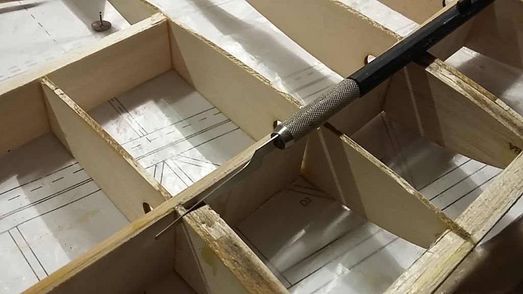

So to the sub spar which only sits to the front of the main spar outside the webbing and ends between rib 21 and 22. I found there were not enough 3mm square spruce lengths in the wood pack so have ordered 8 extra. This may be slightly too much but better to have too many etc.

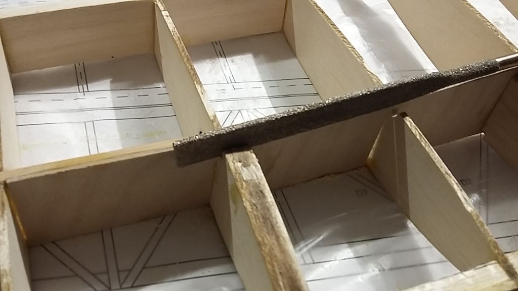

First I used my handy Tamiya saw to cut the edge of the notch on each rib by lining up an off cut of spruce.
Then my handy 3mm Permagrit file which I use a lot - don't know how I used to manage without it.

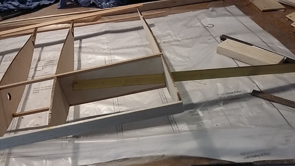

Chris advises that the bending of the spruce spars can distort the wing thus a straight edge should be clamped to the aileron spar in order to keep the structure true. I used a piece of angle aluminium which worked a treat. The pictures show clamps to hold the sheeting down but there is so little to grab that I found pins better - the Graupner pins have such sharp points that one can make them stick in the spruce. Masking tape at the front is best to hold the aliphatic until it dries. This is the underneath of the wing which one covers first before jigging up from underneath..

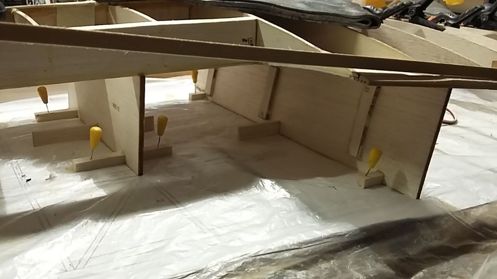

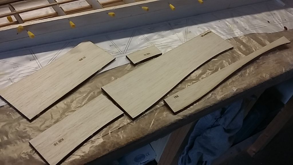

Not mentioned on the plan as far as I can see but referred to in the RCM&E article is reinforcement of R2 which serves to strengthen the mounting of the 3mm brass tubing to take the incidence pin. You can see here that the undercamber of the wing means a straight edge just won't do.
So I got out the laser cut scarp and drew a line on the 0.8mm ply so as to trace the correct shape.
Glued in place but first of all drilled with 3mm - also R1. Not altogether clear is that R1 will also be capped with 0.8mm ply - much needed for strength. The brass tube will be reinforced on all sides with 3mm and 2.4mm balsa and lashings of epoxy.
In this photo one can see the slightly bent with steam to follow the curve 6mm x 6mm balsa reinforcements top and bottom which dictate the edge of the 1.5mm sheeting top and bottom. For now all sorts of detritus have to go into the wing before the top sheeting such as wires for the servos, and here 2 x 3mm ply blocks (plan say 3mm but I don't think that will be deep enough - I used the discarded F1 to F4 3mm ply parts rather than throw them away) for the wing retaining hooks to screw into.

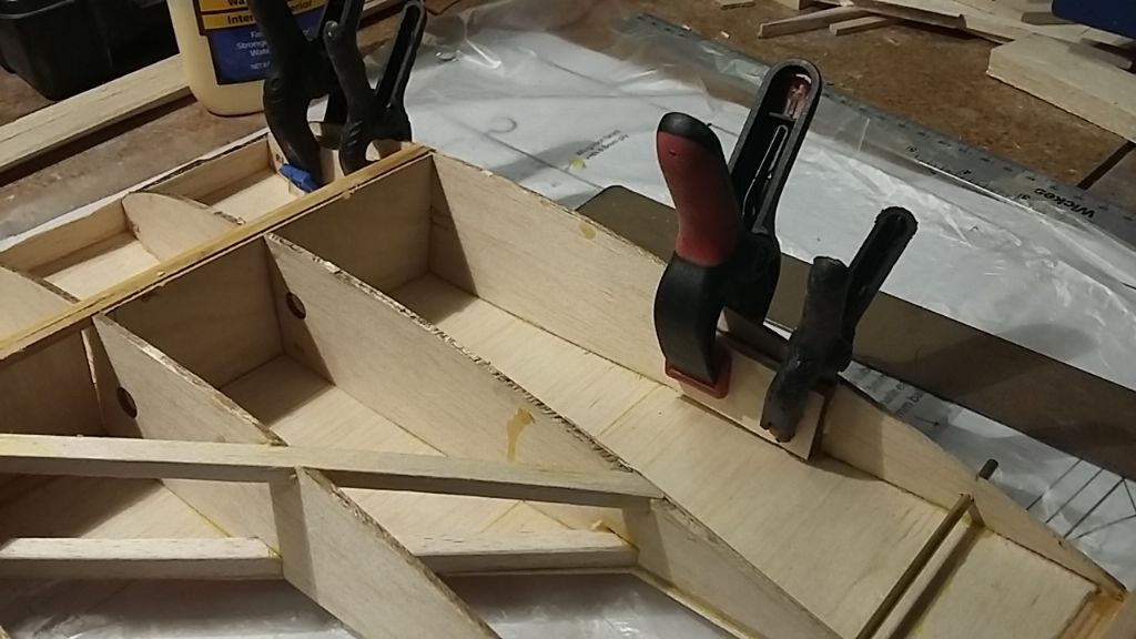

Whilst Chris's photograph showed this underneath sheeting missing when jigged up, I decided to glue it in to provide a full rest for the wing when on the jig. Otherwise there would be a 1.5mm gap.
I also installed the capping strips under R18, and 26 which is where the 4th and 5th jig supports sit for the same reason.
I am going to reinforce the jig sitting under R9 as that takes the most weight and can snap under the weight. I am also going to attach 6mm x 6mm legs to keep them upright as you will see next.

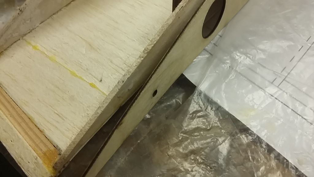

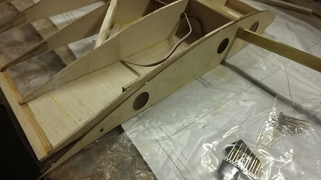

I was intrigued about the wing root profiling part that was in the kit of parts. It is 1.5mm rather than .8mm which is the thickness shown on the plan to line the end of the wing. I wanted to check, however, that the brass tube I had drilled a hole for was in the right place. When I compared it with this rib you can see it is slightly out by about 4mm. I checked the part against the plan and it was correct. I also measure the plan - again the distance from the trailing edge that I had drilled the hole was correct? Mystery. I can only assume that the undercamber of the wing toward the trailing edge is the culprit.
Anyway, I filled in my hole with P38, attached this part to the wing with spots of cyano and drilled the hole in the right place. It is also not half way up the rib but slightly off centre to take account of the positive incidence of the wing - 1.5 to 2 degrees.
There would be no point unless the distance between the wing joiner and this incidence pin tube was correct.
When the top sheeting is on, I will draw round the wing root onto .8mm ply and attach it. Hopefully everything should line up then. The part curiously isn't included in the kit.

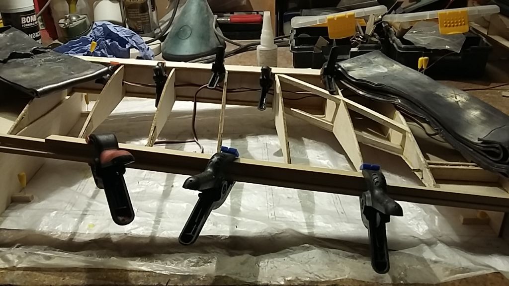

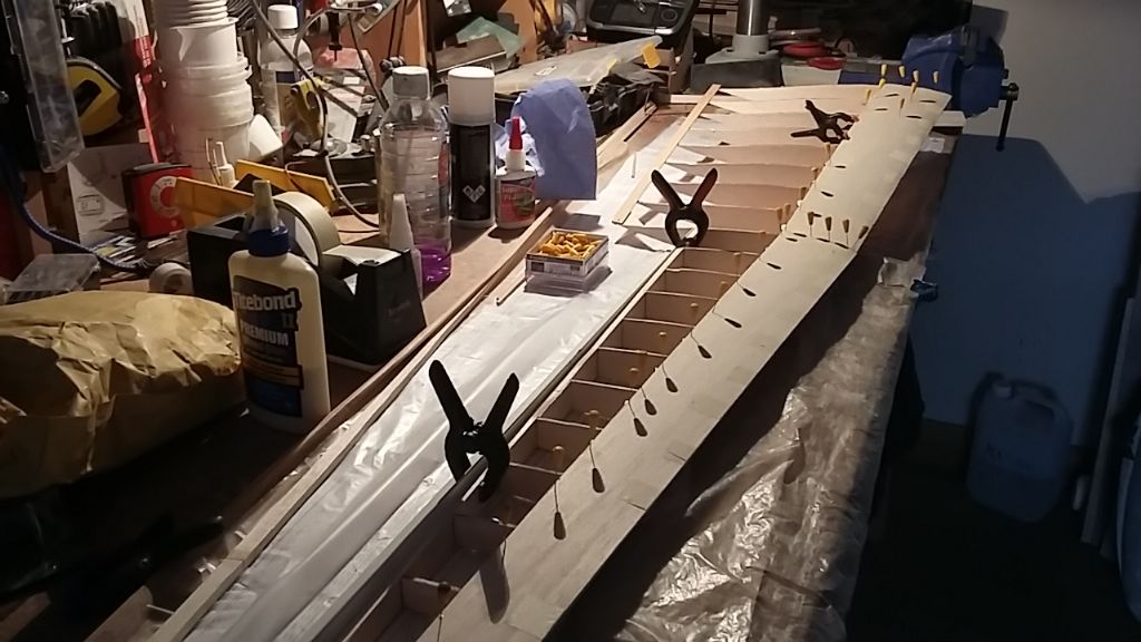

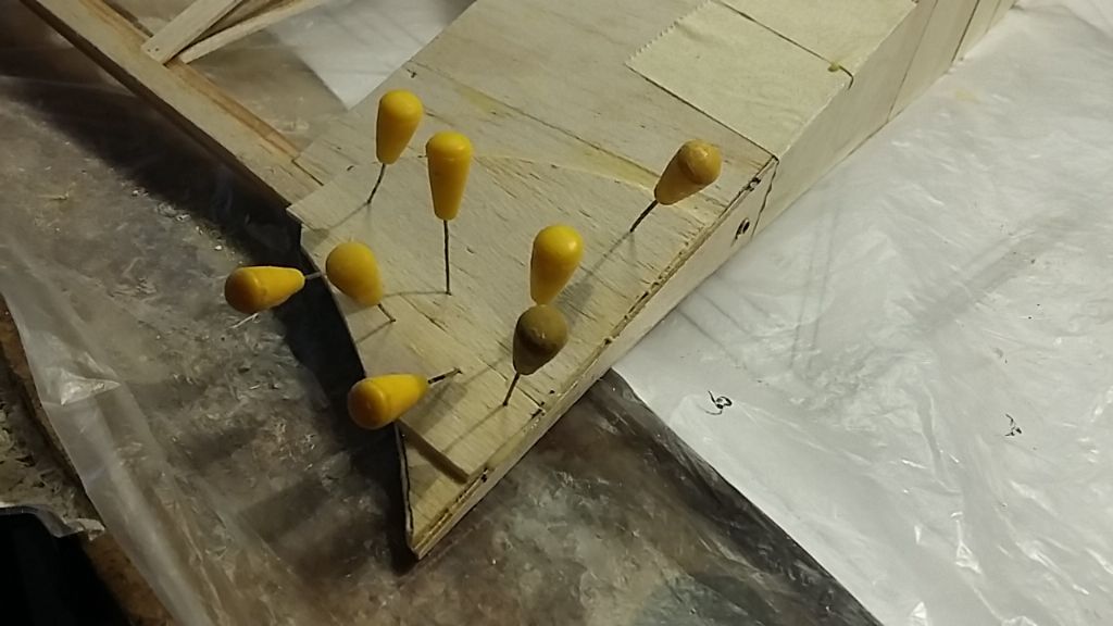

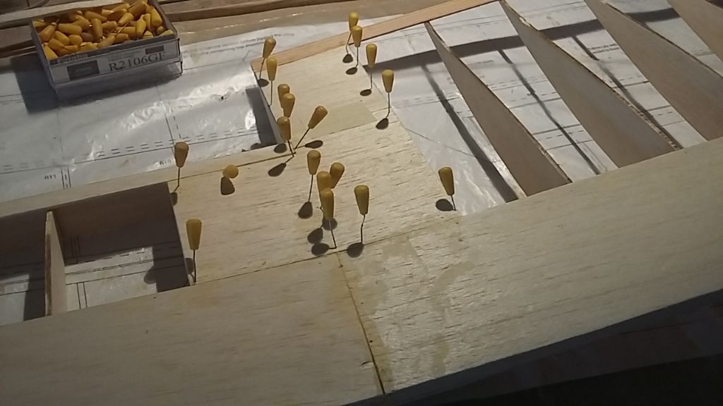

So....to the wing top sheeting. I had read Sussex Soaring Blog about this stage which I was not looking forward to it. I did a few trial runs and it was tricky to keep the wing in place on the narrow jigs under ribs 1, 8, 10, 18, and 26. So I decided to not only reinforce jig under R8 with 3 pieces of 3mm balsa (as recommended in the very good blog - here is the link - **LINK**) but also to make feet for all the jig supports - essential so you can pin them down first in position over the plan.
You can see the amount of lead needed to make the wing sit on the jigs. Here are my tips
  1. Clamp a piece of hardwood to the trailing edge near the root as otherwise the weight needed will buckle it.
  2. Pin the jig supports down with pins before you start. Otherwise you will not be able to pin in the supports because the wing will restrict access - especially at the tip and root where it is closest to the bench.
  3. Start at the root with the top l/e sheeting glued down first. I used a combination of clamps with one of the flat pieces removed to catch the piece of 3mm square spruce. Even so they leave a bit of a mark on the balsa. Also many pieces of masking tape which glue well to the sheeting underneath.
  4. Attach the long piece of top sheeting to the tip 2nd making sure you use enough masking tape to seat it properly and weight it down. I used a large piece of lead, and a pot of paint. Chris in his pictures show several batteries.
You can see the reinforcing pieces here and the feet out of 6mm square. I also used pieces of 12mm x 3mm
You can see here the piece of lead placed on the middle of the gull join over R8 to 10 and the reinforcing pieces of hardwood I used.

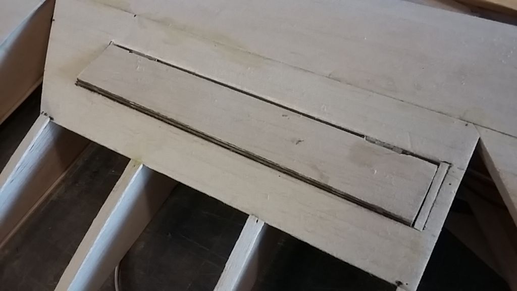

So on with the spoilers - they are 2 pieces of 1.5mm balsa either side of a piece of .8mm ply with cut outs for the hinges - don't make the same mistake as me - fail to check if the square cut outs in the ply are big enough for the hinges - they weren't for my hinges so I have had to cut down the hinges - do that before you assemble them. This is the plan for the other wing.
Here you can see underneath where the servo and connecting rod will be installed. You can see that the hinge is angled down and lined up so that the top of the spoiler is flush with the top of the wing - about 2mm below the surface.
There is a 6mm balsa frame that is inset into the ribs and lines the spoiler hole. The ribs have to be recessed about 2mm to let in the spoiler.
Cap strips still to go on also a balsa surround for the servo and rails for attachment.

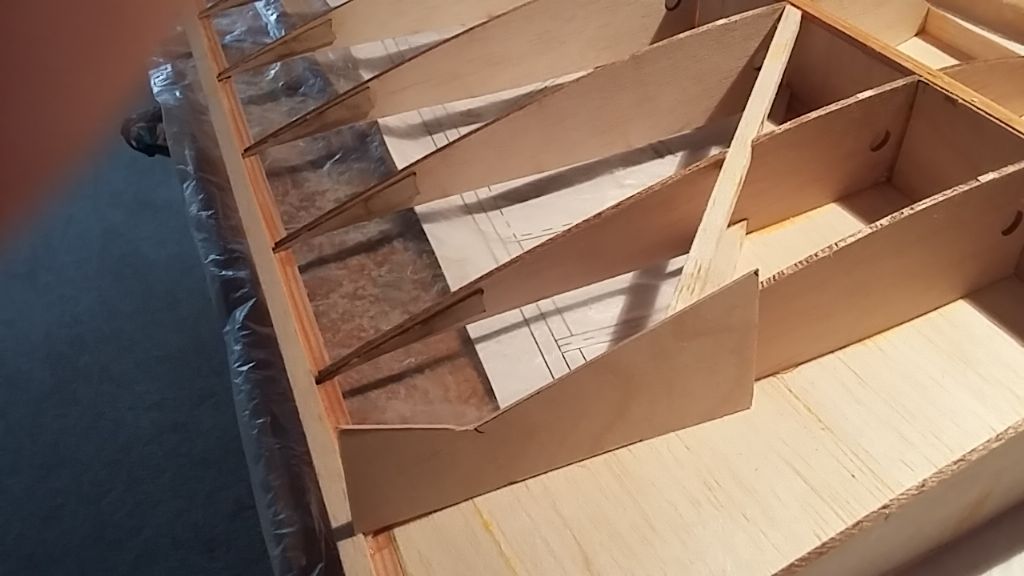

Finally before adding the root ply facing rib, we need to add the leading edge out of 6mm balsa. Fortunately I had some spare 12mm x 6mm strip which I used. I laminated 2 pieces of 3mm x 6mm for the rest of the length which I also had lying around. Not enough 6mm from the woodpack left.
I know this may sound obvious but I always line the sheeting adjoining the leading edge with masking tape to protect it from chipping with the plane. When I take off a strip of masking tape I know I am down to the level and do the rest with sanding paper having removed the tape.
You can see in this picture the ripped masking tape which means stop planing.

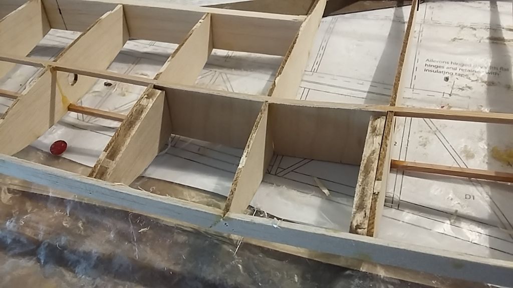

Well, onto the aileron which is all built up. What I didn't realise was that the leading edge is angled inwards to create an angle for the top hinging which is very clever. I was worried that by the time I chamfered the edge to suit there would be no width left.
What it does mean, however, is that the bottom edge of the leading edge spar has to be chamfered to take account of the angle.
First one pins down the trailing edge and attaches 3 ribs, one at each end and the middle with some cyano or Superphatic as I used.
Note the judicious use of engineers squares to ensure the ribs are vertical, and Superphatic which was great.
I then pinned the leading edge to the ribs and left it to dry.
I returned to glue in the intervening ribs all the way along
Then one inserts the cross pieces from 1 to 19. They do not have to be an exact fit.
This was reasonably easy in comparison to what has gone before.

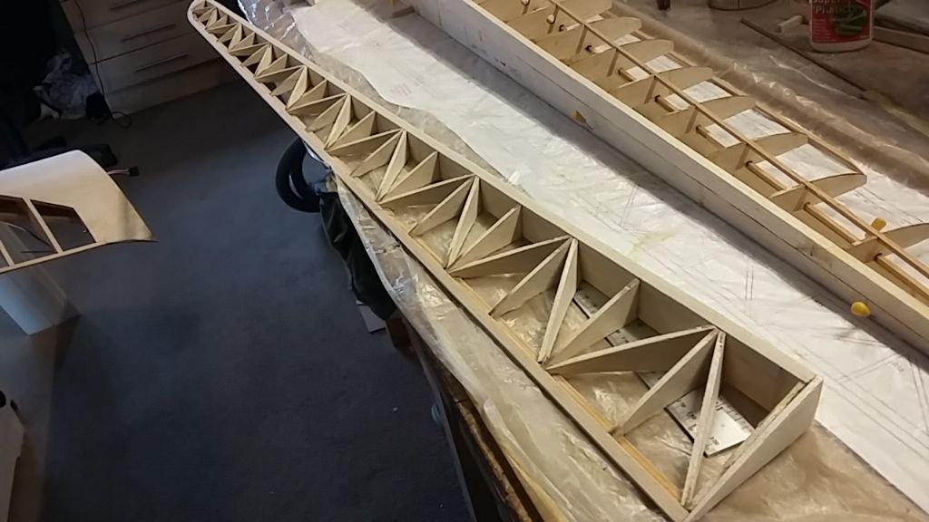

This is the finished aileron or nearly as it needs blocks for the horn and some trim pieces on top in .4mm ply on the joints since I am using clear matt film. In order to cope with the change in angle at the root one adds a sheet of 3mm balsa which can then be sanded to fit the join in 3 dimensions.
The wing tips have been added so the port wing is more or less, subject to the above bits finished. I still need to install the servos for the aileron (Corona Metal Geared Flat Wing Servo) and spoiler (An Emax MG 9 gram servo).
