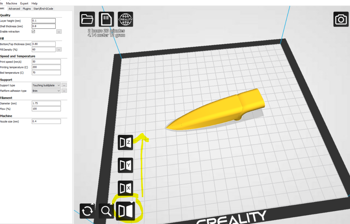

  4. Before I do these things, I want to mirror/reflect my design, to create a handed version, for the opposite wing in a two servo wing design.
1. Yes, you do all the slicing in Cura.
2.The most typical model file is an .STL file, though there are other formats.
3. I don't use Fusion so can't help there, sorry.
4. You can mirror your design in Cura easily enough, Just click on the object, then on the Mirror button (circled in yellow)  -which expands into three buttons for a mirror in X, Y or Z - pick which mirror you want and hit the button.
Then save as a new file name, say something like servocoverl.stl and servocoverr.stl.

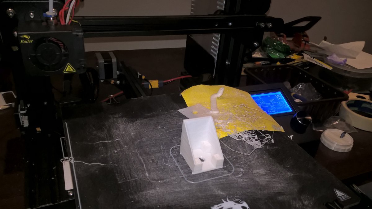

I did manage to print the servo covers with what I think are called a skirt, an additional area of print outside of the print, which is easily removed later, whilst providing support helping adhesion. There is a problem in that i do not know how i selected this option.
The issue now is I am trying to print a print with very little faceplate contact area, where the print is tending to lift. Not knowing what the option is called is at best a nuisance, in reality is preventing a successful print.
Please tell this Drrrr brain what I need to know☺️
Well, I am still learning big time.
I have tried Brim settings on a wing servo plate (opp. hand0 that i have deigned and then made. My brim did not apply as per the pictures.?
I have tried the "Hair Lacquer" route, which does not work for me. The adhesion is very poor. Applied wet, allowed to dry or just damp.?
More positively, I am slowly improving my design knowledge with "Fusion". I now sketch, extrude, then sketch and extrude and so on. How do others undertake the designs?

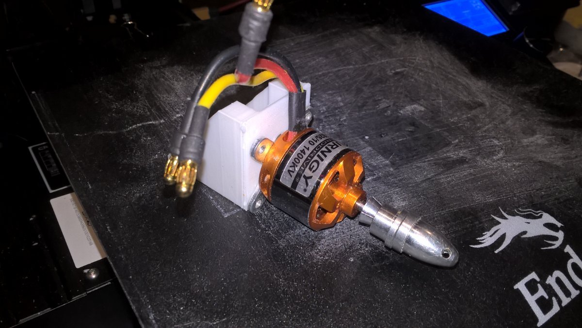

Any way a few pictures to show a motor mount I have designed and printed, what had gone wrong. Plus roughing up the bed inproved adhesion. What else can I do that is a little better? A different Brand?
Brim is important for two reasons. The first is to make a bigger area that has more opportunity to stick to the bed. The second, less obvious, is to round off sharp corners. For example, your motor mount is quit large, and one would expect that there is plenty of area to stick. However sharp corners pull up harder when they contract a little as the printed material cools. Adding a brim will help, or alternatively rounding the corners of the part when you design it. Some parts designed for 3D printing will be rounded in the base layer and transition to a sharp square outline in the first few mm.
