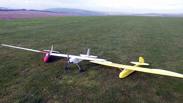

Although a little heavier than the Skylark, the Wot 4 had no problem towing her up, and five or six hundred feet seemed a sensible height to which to tow with gliders of this size. One 3S LiPo turned out to be good for around six tows before a battery change would be required and, as we were fitting the micro-towing around our larger activities, two batteries were completely adequate for a day’s flying.

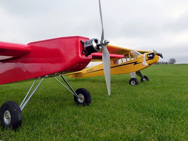

Business end of the ‘Williamsley’ tug, with the Hangar 9 J3 Cub behind, both fitted with Turnigy G60 motors.

The Wot 4 comfortably tows the smaller of the Wolfs.

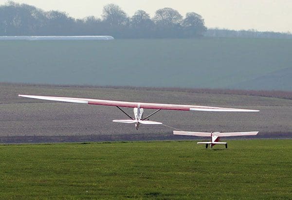

On a roll now, I pondered ‘What next?’ and set to designing a fifth scale version of one of the most iconic of British gliders, the Slingsby Petrel, again recently a plan feature in this magazine. With its sealed ailerons and total lack of struts and windscreens the Petrel proved to be on another efficiency level altogether and now flying comparable to that of the larger stuff could be obtained. The Petrel will soar in the lightest of conditions and, despite the narrow wing tips, is perfectly safe at the stall.

The Williamsley with the 1/5th scale version of the Wolf.

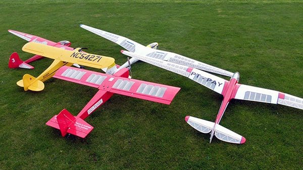

Almost all the current fifth scale fleet.
The wing, boasting a symmetrical section, was as straight as a die. The CG was well forward. Yet several divots in the surrounding area testified to the results of any episodes of Dumb Thumb Syndrome.

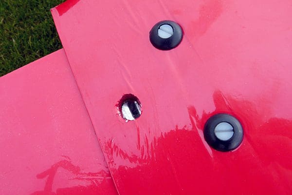

Tow release on the non-scale tug.
By this time, we had all built up a healthy mistrust of the machine, bordering on fear, and now, when the First Flight beckoned, we shuffled about, not looking at each other. Three straws appeared, and I was relieved not to have chosen the short one. We needn’t have worried, as it turned out, as the tug was now as stall-proof as it was possible to be, and the incontinence trousers were later sent off to charity. This time around I had opted for full length ailerons and, again a glider procedure, they were programmed to come up for landing. This produces a nose-high attitude, thus increasing drag and thus far it seems to work pretty well.

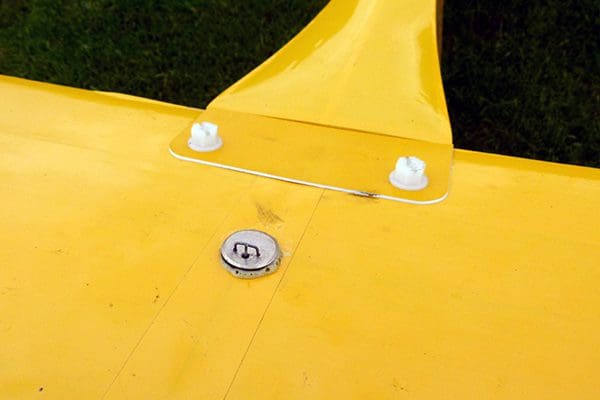

Not content to keep the status quo, Smallpiece recently turned up with an ARF Hangar 9 J3 Cub, again fitted with the trusty G60 motor and two 5200mAh 3S LiPos. Also, based on his theory that any plane without a tow release is a waste of space, he had fitted same. Now we were talking – scale tows! The Lad has a lot of Cub history behind him, having campaigned a 1/4 scale Cub for many years, so this was a case of déjà vu for both of us. As I lined up the Petrel behind it, I noticed his face turn white and small tic fired off behind his right eye…

Tow release on the Cub.
Back in the present, Smallpiece was obviously having some species of flashback, so I kicked him hard in the ankle, whereupon he shook himself and opened the throttle. The Cub proved itself to be an excellent tug, with about the same power as the Williamsley (John Greenfield, designer of the Greenley, declared that it could no longer bear his name, what with the new wing section we had fitted) and the French Fiasco came nowhere near being repeated. (It still had its occasional excitement, though!)
