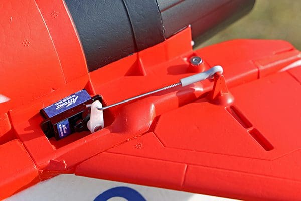

With a myriad of schemes to choose from Arrows opted for the colourful Russian Air Force ‘Swifts’ aerobatic team livery, one that’s nicely applied with neat masking lines. Small scale details are dotted around the airframe and, importantly, plastic parts are used in higher stress areas. The all-moving horizontal stabilisers are a case in point, where ball bearing axles rotate smoothly and accurately in moulded plastic channels to provide the necessary rigidity.

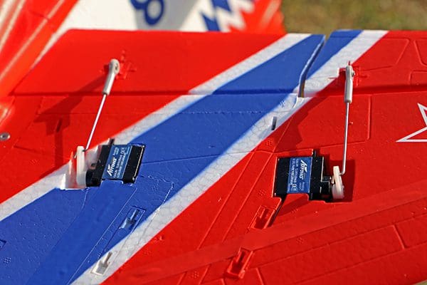

As we’ve come to expect at this price level, ball link servo push rods provide slop free connections to strong control horns. I particularly like the nose cone that’s magnetically retained – so easy to pop off for storage and transportation or replace if damaged.

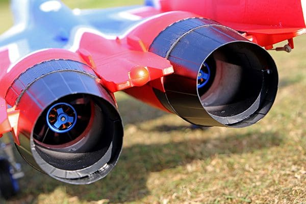

This 12-blade pair sound very fine indeed.

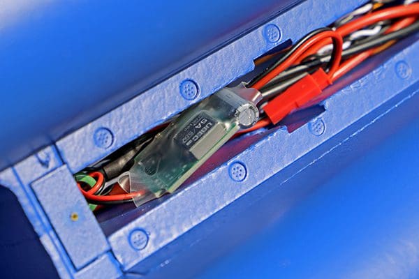

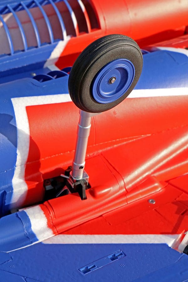

The undercarriage is nicely done too, sprung metal oleos all round, with wheels large enough to cope with short grass runways. Twin 64mm fans are coupled with 2840-size 2280kV brushless outrunner motors and sizeable underside cheater vents supplement the main air intakes. There’s distinct separation between the MiG-29’s engines and the model uses this space to house the twin 40A ESCs and a 5A UBEC under a long vented hatch. The UBEC provides the receiver with a separate power supply as a sensible safeguard against ESC failure. Nine 9g servos do the pushing and shoving and your receiver and LiPo battery live under a canopy hatch that’s retained by a secure sprung latch.

A 5A UBEC supplies the receiver.

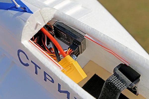

The web is a great source of info these days; plenty of videos and forum chat is just a click away and this MiG is no exception. I’ll come to some of the points raised a little later, suffice to say that the second batch of models in the UK reflect an alteration made following feedback. Under the hatch you’ll find a compact battery bay where a foam shelf has been reduced in size to allow the battery to move further back as a way of helping users achieve the suggested C of G. If yours is an earlier version, then it’s easy to trim the shelf yourself. That shelf should still be large enough for your receiver, which is just as well as it’s going to impede the battery if placed anywhere else.
feb21migtwentynine10
Your Rx must live on this shelf. Six-channel units shouldn’t have a problem.

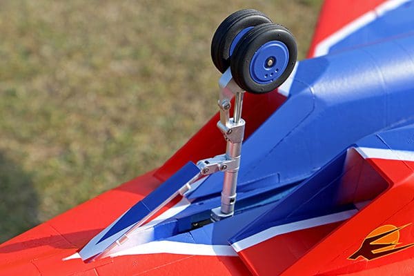

The nose leg is nicely done although a small mod (see text) will improve its effectiveness.

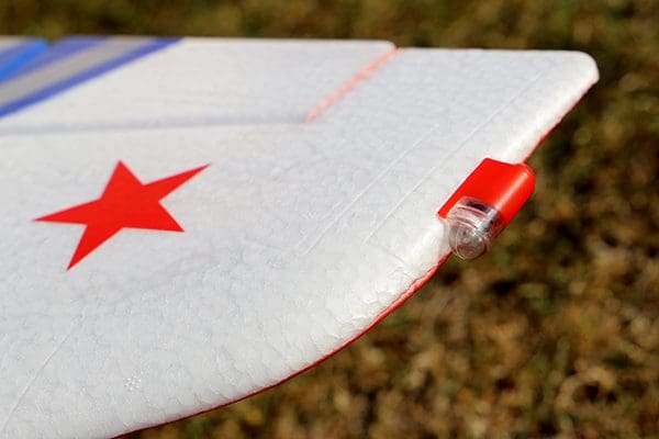

The wing tip LEDs are visible in daylight.
Now to the C of G. Arrows suggest 85 – 95mm back from the wing leading edge root, but you need to aim for at least 95mm and possibly a little further back depending on the weight of your battery. 85mm is too far forward. There’s one very good reason for that. The nose leg strut oleo spring is too springy – too soft in other words – meaning the forward C of G point Arrows suggest places too much weigh forwards during take-off, so the strut compresses, the nose drops, and the model is unlikely to unstick unless a shade of flap is deployed, there’s a decent breeze and your take off surface is very long and super smooth (think tarmac). Even if those stars align, it’s still a bit marginal.

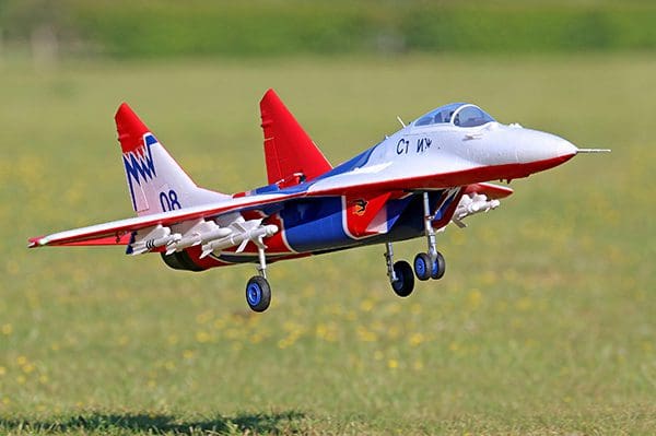

You’ll notice the drag from ordnance; it’s the reason why I rarely fit the stuff.

Leave the ordnance off for the first flight, it adds a little drag. NATO gave MiG’s 29 the reporting name ‘Fulcrum’ and I wondered if my light battery, a hint of flap and a 7mph breeze would be enough to… ahem, lever this one off the deck.
feb21migtwentynine12
The ‘mains’ twist and turn, retracting forwards.
Everything was fine though. The trike undercarriage tracked well and as the model seemed to reach its maximum speed (and the end of the strip), a good pull of elevator was enough to raise the nose and get it away. I hadn’t quite yanked it off the deck but as is sometimes the case with trike EDF jets, it hadn’t revealed a desire to unstick without positive intervention.
It feels safe and predictable in the air, the sound from those twin 12-blade fans is superb and a decent turn of speed is evident. The usual jet manoeuvres are there to be enjoyed and it’s very forgiving at the slower end of the speed range.

All control surfaces use slop-free ball link connections.

An all-moving stabiliser could have been a weak point but it’s all nicely engineered.

Strut Mod
So, let’s talk about that nose leg oleo. A range of possible improvements suggest themselves as a way of stiffening the strut’s spring in order to make take offs and landings easier.
I started by removing the top part of the nose leg wheel assembly. That’s achieved by undoing the single crosshead bolt that faces forwards halfway up the leg. The wheels and trailing links then lift away, revealing the oleo interior and the spring that can be removed using tweezers. Some replace the spring with a stiffer example, but I inserted a 7mm spacer (to compress the spring) made by cutting down a 4.7mm diameter nylon wing bolt.
To finish, I reinserted the wheel assembly, pressed down on the spring and popped the bolt back, adding a touch of thread lock to secure it. A stiffer oleo is the result.

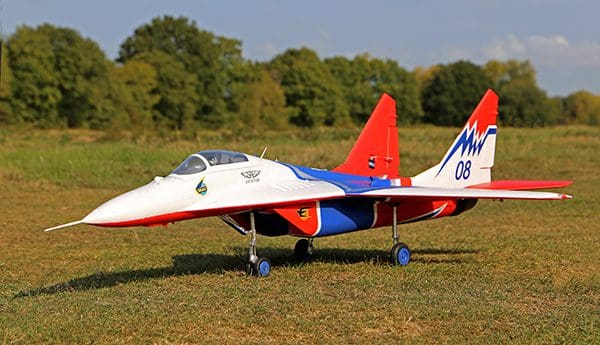

Replicating the Russian Air Force Swifts aerobatic team, it’s a very pretty model.
But don’t let that put you off. This MiG-29 has plenty going for it. It’s nicely finished, the retracts are good, it sounds superb and flies well. That this isn’t a model for first-time EDF or inexperienced pilots is obvious. But it’s a straightforward and enjoyable flying proposition for those with a few electric jets under their belt.
