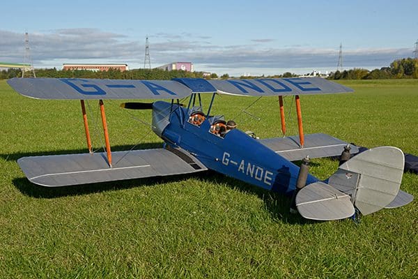

Andy Bowman’s delightful Flair Tiger Moth.

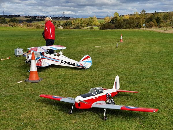

The next event was two weeks later at Pontefract, a couple of hours up the M1. I duly entered and flew the Chipmunk again. This time the wind was stronger and perpendicular to the runway. Normally I would have not flown, but, heck, others were going to. So, I set the model at the end of the runway and went for it…
 feb21makeitscale5
My Black Horse Chipmunk, with Richard Crapp’s Stampe in the background.
My lack of practice was still evident and the fact that all the models had gyros fitted, apart from mine, meant I was at a disadvantage. But I held my own and again finished in the midfield, which I was incredibly pleased with. Graham and his Dad Alex were once again judging, and again their feedback was very helpful.

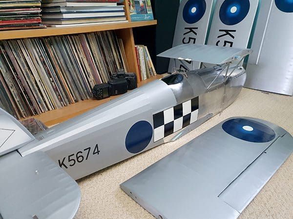

We last saw my Fury with silver painted wings, tail and rear fuselage. Following completion of the wing rigging (shown in a previous column), I was able to continue with painting.
The litho panels under the tailplane were fitted for a final time. These had to await the tailplane fitting and elevator pushrod connections. I left these in a brushed alloy finish. I fashioned leather looking gators for the area where the struts emerged from the fuselage with small sections of 0.5mm Vector Board painted a satin brown.
 feb21makeitscale7
Even just sprayed in primer, the fuselage is starting to look like a Fury.

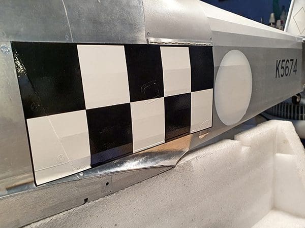

I created the artwork for the dreaded check pattern in Adobe Illustrator. The difficult part was the 1mm black outline that had to be applied. The problem was going to be keeping that accurate over all the lumps and bumps of the fuselage, including footholds, stitching and changes in surface from fabric to alloy panels (using alloy tape in this instance).
The footholds were created in Illustrator too and the alloy foil cut on the plotter. These were aligned and stuck down. I was happy with the tissue definition of the rib tapes on the fuselage but concerned that the Klass Kote would eliminate the ridge and make the tapes invisible. I need not have worried.

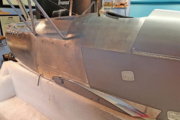

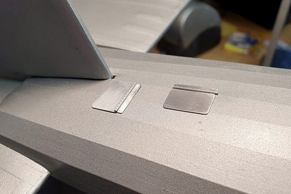

While I was looking at the small alloy details, I thought it a good idea to make the small access panels on the top of the fuselage, just in front of the fin. I decided to make them from lithoplate, with notched lengths of 1mm K&S alloy rod to create the appearance of a piano hinge. When buffed with a sanding pad a nice effect was created.
 feb21makeitscale8
Access panels were created from lithoplate, with notched alloy to simulate hinges.

Black applied to the check pattern on the fuselage. Even the footholds are still visible.

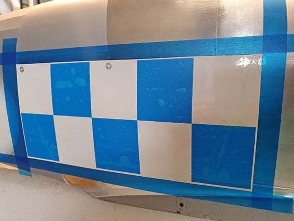

Once the white had thoroughly dried, I masked and sprayed the black. This includes the registration lettering under the wing, on the rudder and the fuselage sides. I was very pleased with the way the checks came out; the outline was even and looked really good.

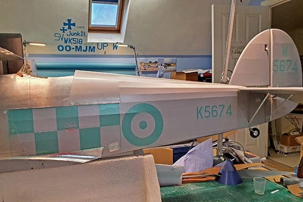

Rather than attempt to get the shade of red correct I opted to try Tamiya flat red acrylic on the fin, roundel centres, spinner and the wheel disks. An arrowhead mask was created to expose the white underneath and another mask created to achieve the fine black line around the border.

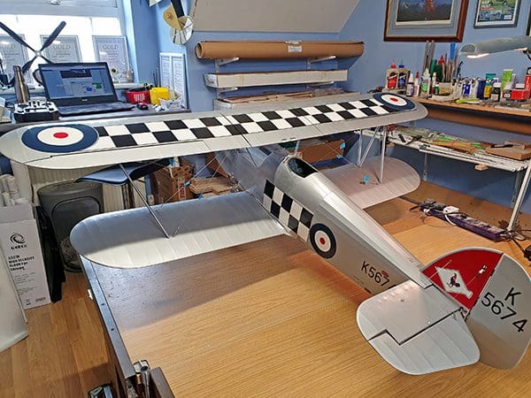

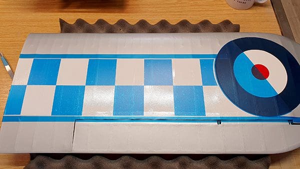

I was not looking forward to attempting the checks across the top of all three wing panels, with the black again outlining the white and the blue edges of the roundels. I decided that a cup of coffee and taking an assembly picture was a good diversion…

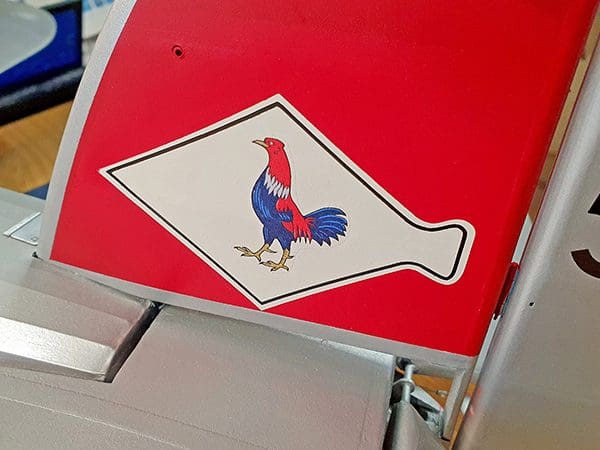

The cockerel decal was printed on to clear decal paper.
I also took the time to create the artwork for the fighting cockerel in Illustrator, starting with a very sharp photograph of the full-size artwork. This was printed on clear decal paper, but my printer does not have permanent ink and when the decal was dipped in water to lift and transfer the artwork to the model, the ink ran. To stop this, I sealed the print with a coat of Humbrol clear acrylic aerosol, which cured this issue.

Running out of avoidance measures, I had to finally face up to doing the check pattern on the top wing. To ensure everything was perfectly aligned I rigged the wings and set out the edge of the white areas. I ran tape from tip to tip and then I made masks that were 1mm larger diameter than the blue of the roundels, to help get the gap even. It took several hours of lifting and replacing the tapes until I was happy. Once that point was reached, I could dismantle the wings for spraying.
Once the white was painted – you’ve got it! – I had a 24 hour wait for that to dry! Rather than completely waste the time I then started to look around at other areas I could work on in the meantime. The oleo covers had a very distinctive stencil, so I made a mask for the white rounded rectangle and some decals for the very small text. A layer of KlearKote sealed them in place.

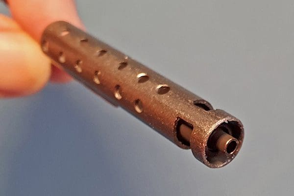

Whilst looking for something else to busy my idle hands I moved to the guns. I managed to find some drawings that gave some dimensions; these were scaled to 1/6 and the guns made from a few sizes of styrene tube. Gunmetal paint was applied, and they looked okay, if a bit shiny.
 feb21makeitscale22
The guns are made from styrene tubes.
I fitted the two machine gun barrels to the troughs in the upper cowling and they did look the part. I attached them with clear silicone sealant. This works well as it provides a firm bond, while still being slightly flexible.

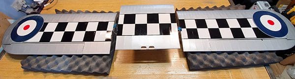

After a day and more coffee, I faced the upper wing again. I was dreading this bit! I originally made up sections of chequer mask that could be applied in one go, but a thou’ out anywhere and it all went wrong. In the end I applied each paint mask individually, one square at a time, with an outline guide for the black 1mm stripe that borders the white and the roundel. This was very slow going but an error here would stand out like the proverbial sore thumb!
I do not know how many times I checked and double checked that I had the sequence black/white right, but all was well and the checks really do look fabulous. It shows what you can achieve if you are careful and methodical.

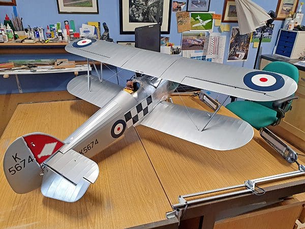

Final Flourishes
 feb21makeitscale24
And the big reveal!

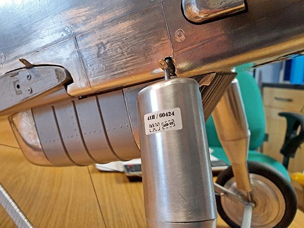

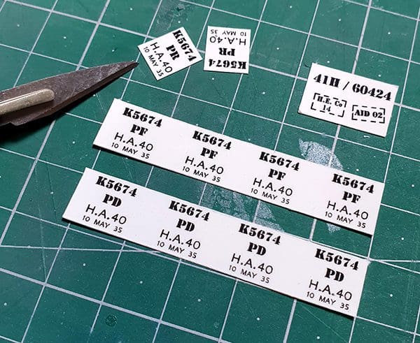

The Wireless Telegraphy (W/T) labels all around the airframe were done using masks and airbrushed. For the markings on the struts, because of their size, I decided to make decals. These were duly printed, sealed and applied, as I had done for the oleo covers. I had to use Micro Set and Micro Sol to get them to conform to the underlying shape of the central struts, which were wrapped in torn silk, if you recall. But all went well.
 feb21makeitscale28
Once clear coated the oleo covers really look great.

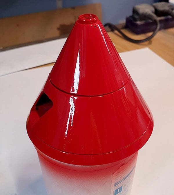

The final few tasks were to clear coat the exposed decals and to change the colour of the spinner from silver, which was just a test (as you saw in the last column), to red. I rubbed the silver spinner with 600 wet and dry, then used the Tamiya flat red again, followed by Klass Kote clear.

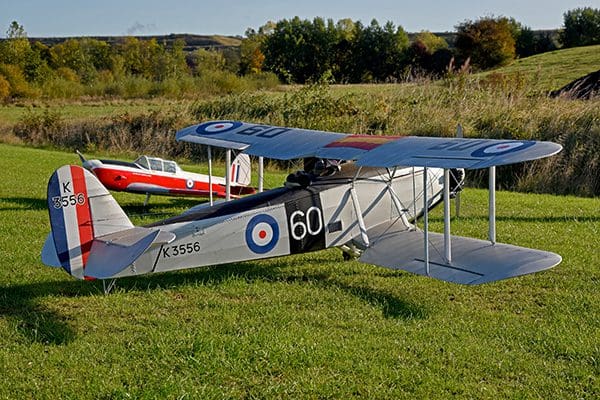

As soon as I can get out to get some nice outdoor shots the better, but I fear we will have to wait for the spring to get some air under her wings.
 feb21makeitscale30
The Hawker Fury in all its glory.
