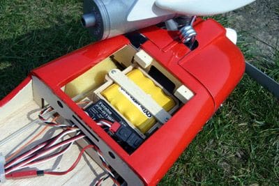

RADIO
The Monsun requires four-channel radio for which a standard receiver / NiCad will do nicely. You’ll need five standard servos since the ailerons require a one each. For those without computer radio this also means you’ll need to buy a ‘Y’ lead. The hatch cut-outs and covers are very neat, but the slots for the servo arms were a bit on the generous side – perhaps German clevises are very fat. A short extension lead is also useful to make connecting the wings and the receiver more convenient when assembling the model at the field. As normal, I fitted a combined Webbs charge / radio switch, but since this is a sport-scale model, I hid it inside with a simple piano wire pushrod to operate it. Coincidentally, this very switch and this same ‘workaround’ is pictured in the printed instructions. A slight departure from the normal ARTF fayre was the separate radio hatch. This is because the neat and deep scale cockpit (which comes complete with nifty detail mouldings) restricts radio space above the wings when the model is assembled. I shamelessly copied my old mate Paul Strawson’s idea and fabricated a small box out of liteply to locate the NiCad in the forward radio compartment. This is much neater than carving a block of foam or padding out the whole compartment. As per Paul’s design, I also made a liteply strap, retained by screws, to hold the NiCad in the box. This is a cunning scheme and works well. If you get it neat, it really looks like its been CNC’d!

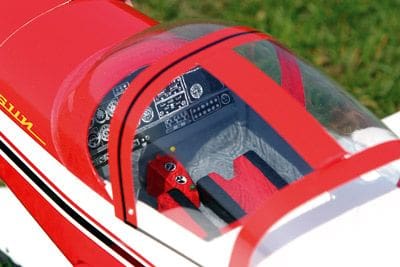

COCKPIT
Definitely a model for cockpit-fanciers. With such a large office and crystal clear canopy, it made sense to take a little extra care. The supplied seats and cockpit interior are good and, painted up, really add zest to this important area. One curious departure was that the tape supplied for lining the canopy framework was red and not white as per box lid, or indeed, as per prototype. Perhaps it was destined for the spats. Anyway, the canopy is a superb fit on the fuselage and retained by self-tappers, though you could easily dispense with these and glue / tape it down, for scale effect. Likewise, you could paint all the visible screws that hold the canopy and cowl as I did after the test flight. Since I was unable to find a full-length pilot for the office, I made one from parts of a dead soldier, hideously grafted Frankenstein-like onto a Graupner pilot bust. Truth is, in the end I think he looked much more convincing than he deserved.
