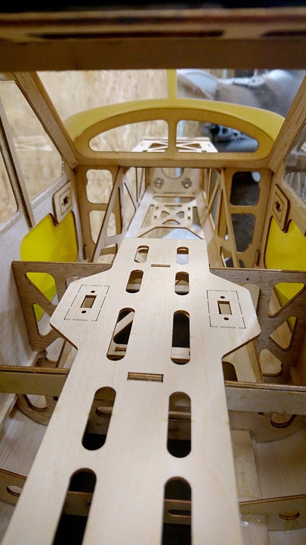

A vast cave of lovely bits and lots of fresh air inside the strong fuselage structure.
Bumblebee is an innocent looking VW Beetle that transforms into a huge yellow robot with impressive capabilities. And now that I’ve been flying my Bushmaster for a while the comparison seems appropriate – this innocent, albeit not that scale looking ‘Turbo Beaver’ is capable of flying very gently, but it can also deliver some truly wild antics!

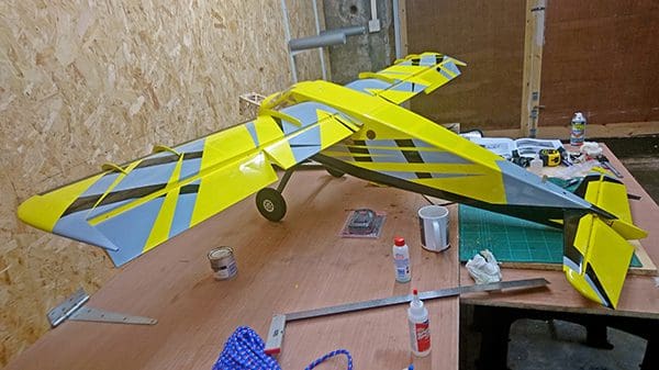

My fold-down work bench was supplemented by a ply panel on trestles.
The manual is detailed, with instructions and photos of matching clarity. Each step is logically thought out so there’s no benefit in altering the order they are tackled in. The hardware for each step is individually bagged and clearly labelled. Again, all of this impresses and inspires confidence.
