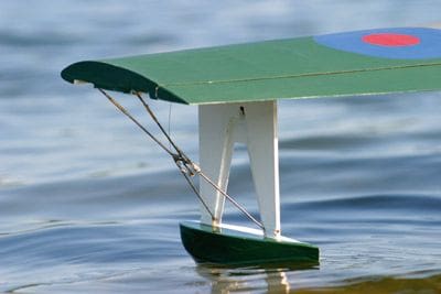

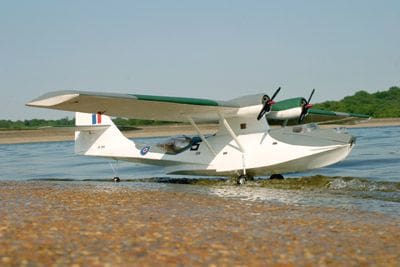

Now bitten by the Catalina bug I couldn’t resist building a larger example (pictured here) with proper operational wing tip floats and that would ROW (Rise Off Water). Having decided on a scale of one inch to the foot, giving a wing span of 104” (2642mm), the biggest issue was motor choice. One option was to use larger brushed motors with sturdier gearboxes capable of handling the extra power, but I was aware of the developments in outrunner brushless motors and decided that this was the route to take. Since outrunners operate without a gearbox and don’t have brushes or a commutator, they offer a significant weight saving.

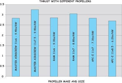

I opted for a pair of AXI 2820/12 motors controlled by M.troniks 40A Genesis speed controllers, each running on a separate 10-cell GP3300 battery. The table shows that the best choice of propeller during tests was an 11 x 7.5” Master Airscrew, turning at 8,500rpm, producing 3.25 lb (1.5kg) of thrust per motor and drawing 30.6A.
Building the two Catalinas with different types of electric motor provided an excellent opportunity to make comparisons. I was quite taken back when comparing the thrust per kW figures for the two types of propulsion system, with the AXI 2820/12 giving 9.4 lb (4.3kg) per kW and the Jamara Pro 480 giving 10.7 lb (4.8kg) per kW. The low weight, small-size brushless outrunner did of course provide a much higher absolute thrust, and avoided the complexity of a gearbox. Brushless motors also have the advantage of being able to maintain thrust levels over time, unlike brushed motors that tend to suffer a falling off in performance as brushes wear and commutators blacken.
Anyway, I was secretly delighted with the figures provided by the two AXIs, weighing only 5.3oz each they provided 6.5 lb (3kg) of thrust between them, which compares well with the brushed motors – 4oz each including gearbox – in the smaller model that generated 2 lb (0.9kg) of thrust in total. One other surprising result was the superior performance of the standard Master Airscrew propeller over the special electric APC ‘E’ propellers, which have received very favourable press reports over the years.
