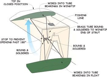

In Part.1 I introduced you to my pair of electric-powered Catalinas: a 76" (1930mm) span version powered by a pair of Jamara Pro 480HS BB can motors for bungee-launching from grass, and a 104" (2642mm) version powered by two AXI 2820/12 brushless outrunners, for operation from water. Whilst the smaller Cat' had its wing tip floats permanently fixed in the raised position, I decided that operational tips were an absolute must on its larger, amphibious sister. By studying photos of the full-size aircraft and the plan from which the model had been scaled I was able to determine how they worked, but I didn't have any information on the internal mechanism. It seems reasonable to assume that some form of screwjack was used, but I didn't feel able to reproduce a scaled-down version of this system and decided instead to simply pull them up with nylon fishing line, using a winch to provide the required 5" (51mm) of movement.
The two winches are situated just outboard of the wing joint, and the lines run through drinking straw tubes out to near the tips where they pass over pulleys and down to the centre of the folding mechanism as shown in Figs 4 and 5. Torsion springs situated at the wing tip end of the folding strut mechanism provide tension in the lines and ensure the floats lower completely such that the struts snap into the straight position – this, of course, avoiding collapse in the event of side loads on landing. The winches are a pair of Futaba 3001 servos that I modified by replacing the feedback pots with 12-turn trim pots from RS Components (RS part no. 187-214). This is a bit tricky, but I had done it before to provide the flap mechanism on a C130 Hercules (see RCM&E Nov. 2005). There's room for the 12-turn pot in the space where the original pot sits, but it needs to be carefully centred in the cavity and jammed in place with pieces of balsa wood, then potted in with epoxy. A short drive shaft then needs to be made for the necessary mechanical connection into the output gear.
