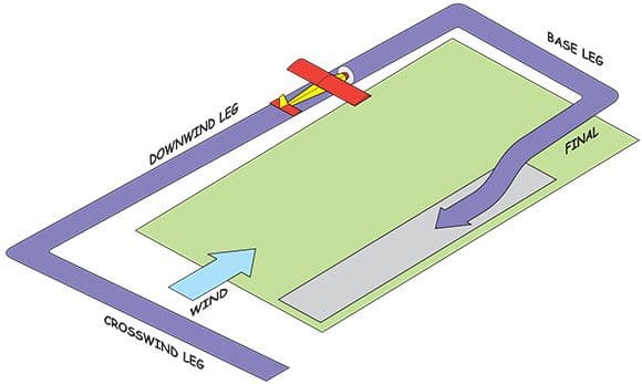

I’m sure that you’re aware of the landing circuit, whereby the aircraft flies a rectangular course around the airfield, terminating in a landing (many pilots prefer an oval circuit, but the result is the same). A landing circuit consists of four legs (Fig. 1): crosswind, downwind, base and finals, the latter being used for the landing approach. Pilots of full-size aircraft returning to an airfield will often be instructed to ‘join on the downwind leg’, and it’s on this leg that downwind checks are carried out, i.e. brakes off, undercarriage down, mixture rich, pitch fine and so on. It’s no bad thing if we modellers use this same point in our landing plans to carry out our checks, including calling out a warning of, “Landing!” to our fellow flyers.

(Fig. 1)
