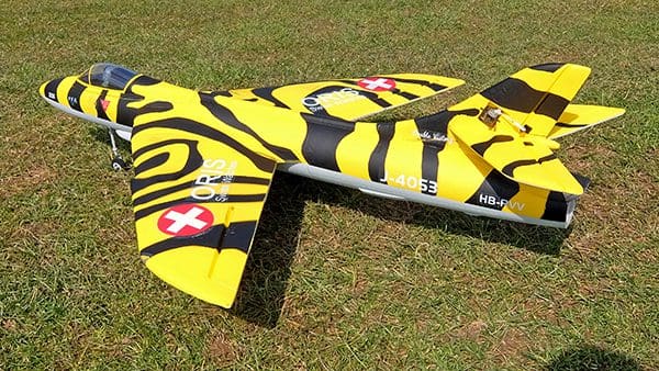

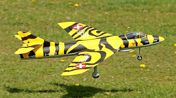

Dynam’s Hunter takes off easily from short grass.
The Swiss Air Force operated Hunters from the late 50s until 1994 and several of their aircraft displayed special brightly coloured liveries. J-4053 was one such aircraft, when it was briefly covered in visually arresting ‘Tiger Stripes’. Ironically, it only made two flights in this bright paintwork – a fact that resonated with me, but not necessarily for the best of reasons, as we will find out later…

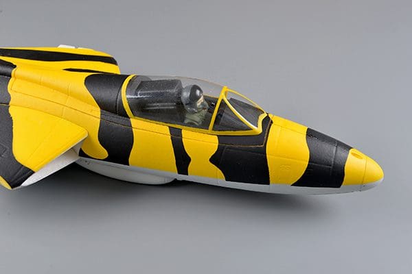

A nicely finished cockpit and canopy covers the battery and radio bay.
Of course, one’s eyes are immediately drawn to that long cylindrical fuselage. The fin and rudder are factory fitted, so assembly really only consists of inserting the carbon wing joiner tube, connecting up the wing wiring harness using the foolproof white connector provided and then securing the panels using four screws, two on each side. Flap and aileron servos are pre-fitted, as are the electric retracts. 9g servos are used throughout, including for the elevators, rudder and nosewheel steering, making eight in total

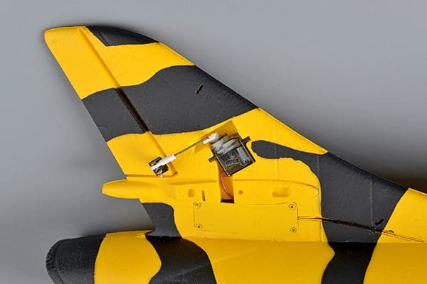

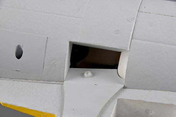

Elevator servo connectors are hidden by the plastic cover just below the tailplane mount. Our review model didn’t need the tail weight found inside!
ncidentally, the rudder and elevator servo connectors are hidden within a compartment just below the tailplane. This is covered on either side by a plastic panel secured using four crosshead screws. Upon opening a lump of lead fell out, which leads one to think that the Hunter could be nose heavy if using the recommended 6S 3300 mAh LiPo pack? I retained the lead for use, if required, after the balance check.

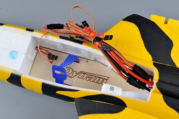

Generous size battery bay becomes a bit of a tight squeeze if using a 4200mAh pack.

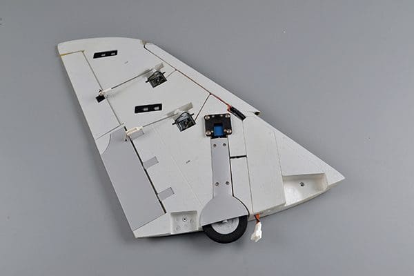

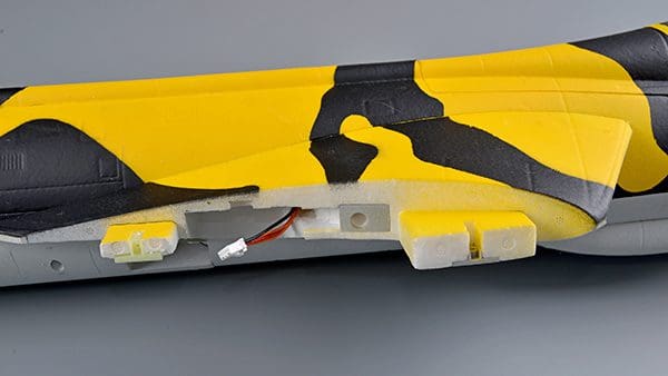

The only point of concern was that I couldn’t find a spot where the wing harness connector for one wing would sit without it rubbing against the wheel when retracted. So, I cut out a sliver of the foam to make sure of a small gap between the wheel and the connector.

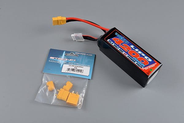

Voltz 6S-4200 LiPo is the next size up from the recommended 3300 pack but adds some useful weight at the front end. Kit ESC comes with an XT-60 connector, so this was exchanged for an XT-90 to match the bigger LiPo.

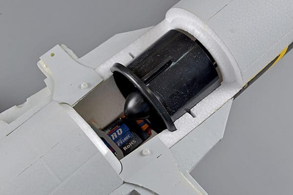

Inside the EDF bay. That 12-blade fan sounds a treat!

Fan cover replaced showing the generous cheater hole, one on each side.
My 3300 packs are well used so I asked CML if they could supply a couple of their 30C Voltz LiPo’s instead. They were out of stock of that size, but they did have the larger 4200 mAh packs, so I ordered two of those instead, figuring out that their increased weight would be handy to rebalance the model anyway. Even with the heavier pack the model still needed a small amount of nose weight, a hole for which I carved out in the foam at the front of the nosewheel bay. After securing it with epoxy the model now balanced within the 140 – 145mm CG range indicated.

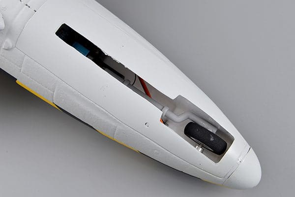

Nosewheel retract is steerable and was trouble free.
The only issue with these larger packs is that the battery bay was now very crammed, so I was a bit concerned that enough cooling air would reach the LiPo and receiver. With only a small slot at the front where some wiring passes through for the nosewheel retract and steering servo, and a small tunnel at the back where the main wiring comes through, I had visions of the Rx cooking slowly as the LiPo heated up in flight. To increase the airflow, I opened up the front wiring slot a bit and was pleased to find that after the first flight the Rx was cool to the touch.

Each wing has several cutouts for servos, wiring and an electric retract. If it develops any cracks or stresses, then don’t muck about repairing it – get a replacement wing moulding!

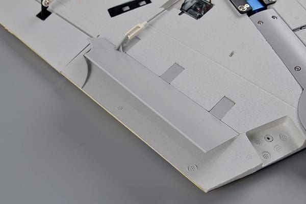

Flaps are neatly moulded and retract cleanly.

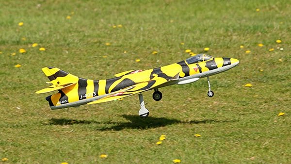

Full power and the Hunter accelerated smartly. In short order there was air between the wheels, but I left the wheels down whilst I got a feel for the model. I am pleased to say that she felt very well trimmed and no tweaks on the transmitter were required, so I retracted the wheels and settled into grooving her around for a few wide figures of eights so that Ray could take his pictures. However, I could tell that he was struggling as by now the sky was quite gloomy, but with only a four-minute flight planned for the first outing it was not long before I had to line her up for a landing. Before I did so, I flew a high circuit to try the flaps and found that the down elevator compensation that I had programmed in was okay, but it was too vicious at full flap.

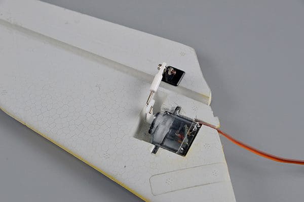

9g servos with ball links are used on all main control surfaces, including the elevators.

I took the wing off and removed the undercarriage unit. This is mounted full depth in the wing so when you remove the mount it reveals a fairly large hole in the centre of the wing, so it was no great surprise to see that the wing had fractured across the leading edge. It had also cracked in a line that followed the wheel bay recess. I repaired both cracks using foam safe glue, backed up with splints made from cut down cuticle sticks raided from Mrs.C’s make up drawer!

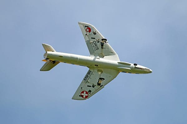

Underside view as the Hawker Hunter makes a turn.
