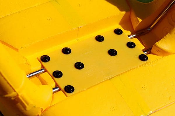

Ten screws hold the undercarriage retention plate and, although not obvious, the short black fixings seemed the most likely items for the task in the absence of guidance.

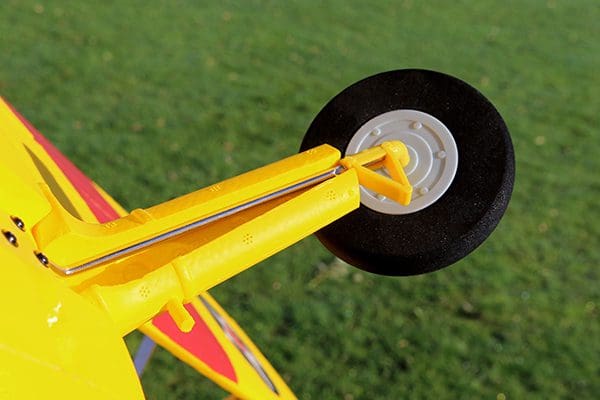

The main wheels required drilling out a fraction to get a friction-free fit over the axles.

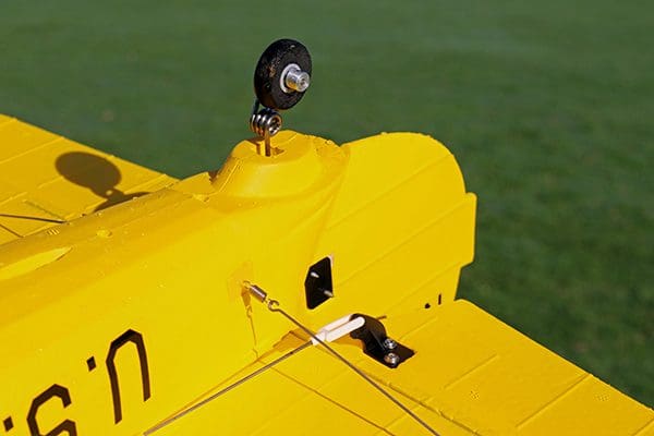

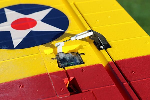

The rudder horn supplied isn’t orientated correctly, calling for a final visit to my spares box for a replacement.

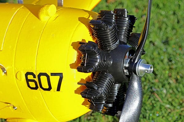

The short nose PT-17 needs plenty of weight as far forward as possible and the nose section incorporating the dummy engine is retained by magnets. It’s a heavy part as weights have been added to help with the C of G. Although those magnets do the job intended, it’s easy to appreciate why some builders have added an extra retention mechanism, just to make sure the nose section doesn’t detach in flight. I relied on the decals to do that, the number ‘607’ spanning the join while providing a little extra security.

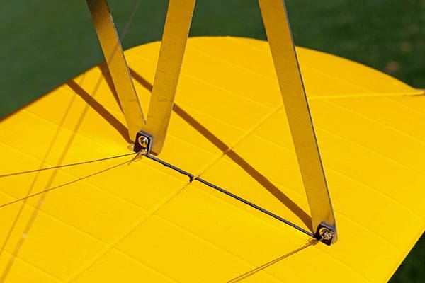

The flying wires, interplane struts and cabane struts are easy to fit, remembering that the retention bolts pass through both the strut attachment points and the wire eyelets. The wing wires looks good but also add some all-important rigidity to the structure. Tension springs hold wires above and below the horizontal stabiliser, although the arrangement is cosmetic.

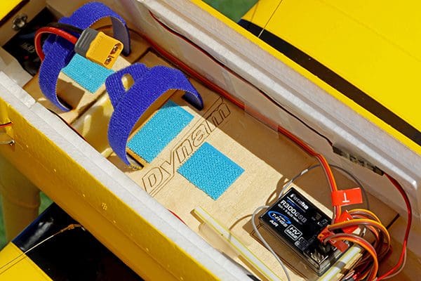

The control surface deflections suggested are fine and the C of G should be achieved using the 4S 2600 mAh LiPo pack recommended. I’ve flown the model using lighter 4S 2200 mAh packs and tend to add a little weight to compensate. All up my model came in at 2120g, a shade under Dynam’s 2150g.
