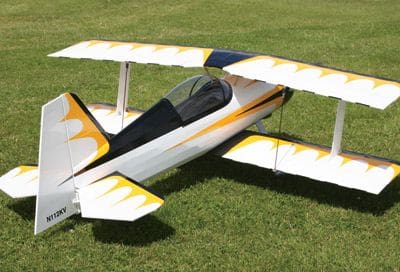

She’s a very pretty aeroplaneBUMF N BUILD

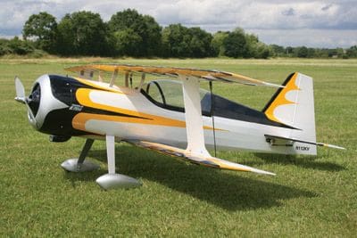

The small wheels and spats make ground handling less than easy – I fitted bigger wheels after this shot was taken which has helped a lotPITTS POWER

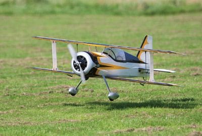

Remember to keep a little power on just after touchdown so as to keep the tail down and the model from nosing over (smaller wheels pictured)SPECIAL?
