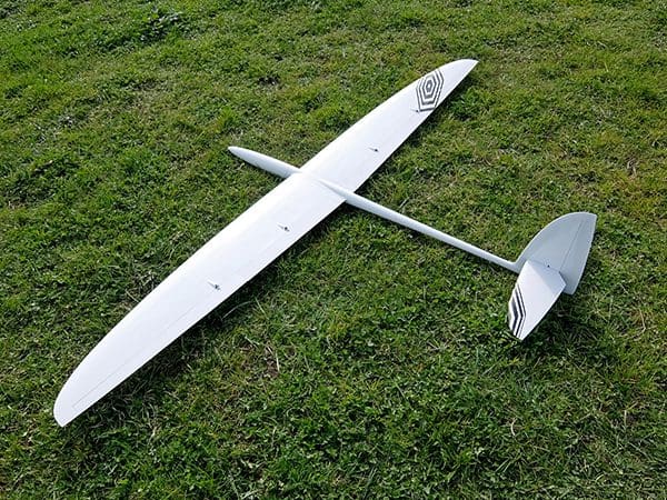

After assembling the model at the back of the car, one of my flying buddies, Jonty, quizzed me about the control movements and the Centre of Gravity position, which I had set at the foremost point of the recommend 86 – 89mm.

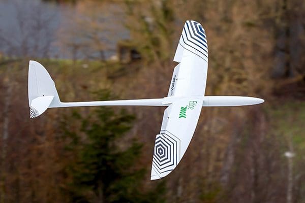

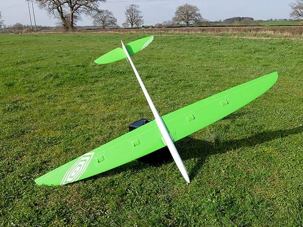

Underside view showing the four-servo wing.

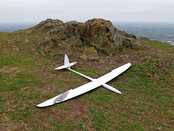

After a final control check I asked Jonty for a launch. Following a firm throw the Edge soared away, straight as a die and climbing well. No trims were changed and Jonty’s advice regarding nose weight was spot on. In mere seconds all my doubts vanished, and I recognised that I had a pedigree model under my guidance. When you know, you know – and from the off I knew that I had lucked in to a real gem for my future slope sessions.

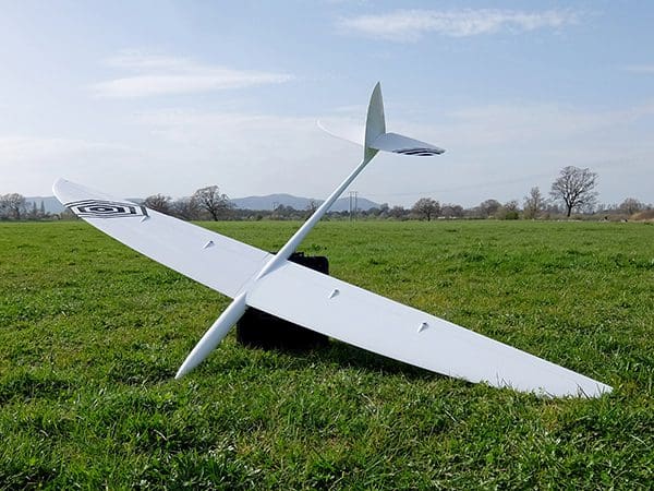

The nicely proportioned design is apparent from this rear view.
The Edge was away and flying really well, and the knowledge that it could be tweaked even further, following advice from Jonty and other experienced owners of this airframe online, was enough to put a big grin on my face.

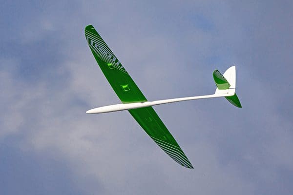

No orientation issues though with the bright green underside!

Back in the shed I stripped off the flap servo cover and could instantly see that the servo mount had parted company from the wing. Still, rather that than strip the servo gears…
I cleaned the broken areas of epoxy away and abraded both the underside of the mount and the wing skin. This time I used 30-minute epoxy to glue the mount into place, to give it a bit more resilience when landing in rough grass on the slope. And just to make sure with the other wing servos, I ran some beads of epoxy and micro balloon mix along the edges of the other mounts.

Crow braking is very effective, and you can happily ‘lean’ on the Edge for a positive landing. Don’t forget to clean the model up just before touchdown or you may pop a flap servo!
