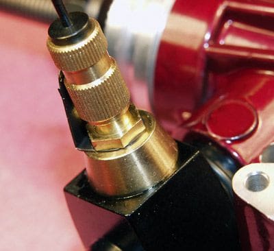

Make sure that the ratchet retaining clip has not come loose on your needle valve assembly.Always use the manufacturers initial settings for the main and slow running needles.
Make adjustments in small increments. Wait, listen, and then proceed slowly, since a click may take a while to show in terms of a change in revs.
Too rich-a mixture is always better than too lean – many so-called poor runners are really just being run too lean.

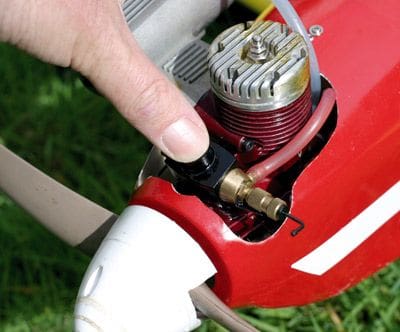

Often the main problem with an erratic carb is unwanted air leaking into the atomised fuel, destroying the correct mixture. This leads to poor starting, unpredictable running, engine cuts and general misery. A thorough visual examination of the carb when running may indicate air bubbles, fuel leaks or both, due to loose unions and nuts.
Is the needle valve clip slipping and thereby letting the valve move with engine vibration?
If the problem is leakage in the barrel of the carb, then substitution may be the only answer, although a quick check that the bleed screw hasn’t come loose, or even fallen off, could indicate another more readily-applied solution.
Ive even experienced leaks at the carb spigot and the carb mounting screws; in one extreme case, on a Russian clag engine, white plumbers PTFE tape cured the spigot leak.
Some budget engines have notoriously poor carburettors, which render otherwise sound designs a laughing stock. Ive even had some impressive-looking budget carburettors, complete with multiple rubber air-seals, which nevertheless ran like dogs just because the mating surfaces were so poor that they let in air.
If the problem is a duff carb on a cheap engine, total replacement is often better than attempting a cure. Ive fitted carbs from completely dissimilar manufacturers to some of my older crash-damaged .45s, and they now run very well. Suppliers such as Just Engines can supply inexpensive but well-made third party carbs for most engines, and they have a canny knowledge of which problem engines respond to which new carbs.
Resist fiddling. Follow the carbs setting up instructions. Better yet, get a knowledgeable mate to help you. Some good carbs don’t stand a chance, since they may have been twiddled well out of tune, and in that sorry state will never run. This is especially the case with the second (slow-running) needle, which should arrive from the factory either spot-on, or perhaps just an eighth of a turn away from correct. Wazzing away with a screwdriver, even for just an idly-guessed half-turn, will spoil the running in many cases. If you suspect that its miles out then either find its datum position from the instructions or phone the distributor. Then get a mate with knowledge to help you set it back to the specified position.

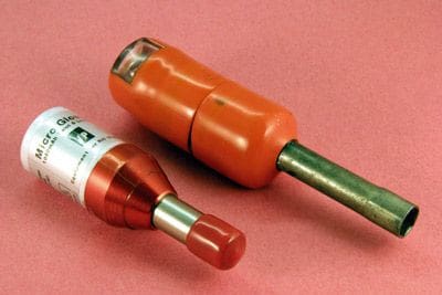

In my own experience, flat glow-starts / glow accumulators / power panel batteries are the most common culprits for duff starting, easily outpacing poor fuel, bad tanks and dodgy carbs. Ive got three glow-starts but they mysteriously seem to go flat all at the same time.
Some glow-starts don’t mate correctly with some glow plugs – a glow-start with an in-line meter will show this straight away.
Wanging up the rheostat on the glow panel and pumping in five amps just isn’t the answer to poor starting. A cheery red-ish / orange glow is what were looking for. A searing white / yellow element is not required.
Plug swapping is a sensible first-line diagnostic. Incredibly, an old plug can glow okay, yet may not start your engine. Thus in some cases, a new plug often effects a miracle cure.
Most engines will run better on a certain brand and type of plug; the rub is finding which one suits your engine.
