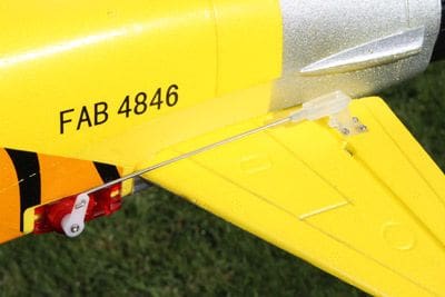

The model is designed to land on it's belly which did prompt me to make an alteration. Viewed from the underside, the elevator torque rods will be the first items to make contact with the ground – this isn't good. The simple solution is to reverse the horns placing them on top of the elevators (see pic) and direct the torque rods across from the servo over the stab' and out of harms way.
