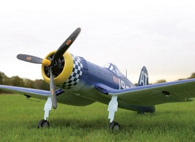

Now, if you ask me, the artwork on the Corsairs box really doesn’t do the model justice. Granted, it looks okay, but you’ve really got to take a look at it in the flesh. Lifting the spray painted, panel-bedecked fuselage from within, quite literally put a smile on my face. For a small-ish (39″ span) model, the attention that’s been lavished on this little warbird is truly impressive, especially for something so… how shall we say… expendable! Perhaps I should justify that: Foam models of this ilk aren’t designed for longevity, they’re manufactured and sold to be flown hard for a relatively short period of, say, a season or two, then replaced.
On this basis, then, you might expect a somewhat cartoon scale appearance with minimal attention to detail. But that’s not what you get. Instead, owners of Art-Tech’s latest are treated to a genuinely accurate facsimile of the full-size. The neatly detailed cockpit was the first thing I noticed, this embellished with an authentic seat and instrument panel that just longs for a full length pilot figure. Panel lines and rivet detail abound, whilst at the front an attractive chequered cowl surrounds a dummy Pratt & Whitney radial. Pulling more parts from the box confirms the level of detail throughout, indeed flying surfaces display similar panel lines, whilst control surfaces are embellished with authentic rib detail. Finally, no Corsair would be complete without the hallmark radiator grilles on the leading edge root section of the wing and, as if that’s not enough, the whole is topped off with – get this – a genuinely authentic-looking three blade prop, complete with hub detail and characteristic domed spinner.

Leave yourself a good hour or two to screw this one together, it deserves not to be rushed. As you can see from the photos, a plug-in undercarriage is supplied for those who are lucky enough to fly from the local bowling green and, again, a creditable attempt has been made to make it look realistic, this with tyre tread, authentic wheel detail and even clip-on leg fairings. Clearly the undercart wont take any abuse but it is at least up to the task that’s required of it. Unfortunately, Ive not been able to test the models ground handling characteristics, although the steerable tail wheel and wide track main legs lead me to believe that it wont present any problems.
