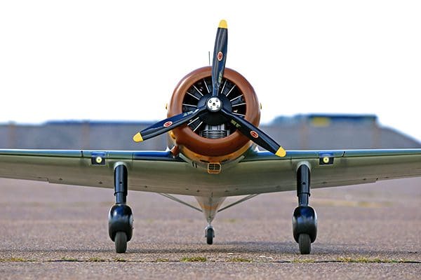

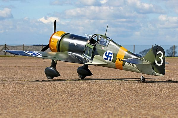

The model is owned by Mark Roberts. He commissioned the model from the shadowy ‘Spartacus’. Spartacus shuns the limelight, lives in the Midlands and has superior craft skills. He is equally happy working in wood, metal and composites. His scale models are always built to an exquisite standard. Many fly on the UK warbird, scale, and show circuits. Hi Fokker DXXI looks good from every angle. She is built to 4.5:1 scale and has a wingspan of 98”. She weighs in at 31 lbs. ready to fly. She is fitted with a DLE 55cc rear-induction petrol engine.

Mark based the scheme of his model on a Finnish example, as featured in the Osprey paperback: ‘Aircraft of The Aces of World War 2’ by Karl Stenman and Peter de Jong (ISBN-139781780960623). This is a monograph in the Osprey series, dealing exclusively with the D21, so it is packed full of relevant facts, drawings and images. We should note here that the Swastika had quite a different meaning in both Finland and England at that time.

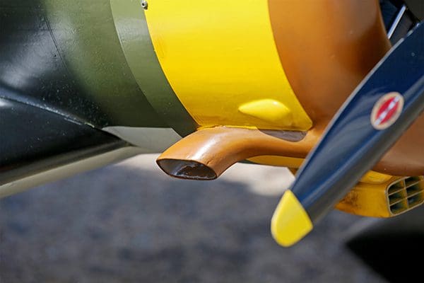

Mark chose a DLE RE 55cc Rear Exhaust petrol engine. This version has electronic ignition.
He flies the D21 with either a 23” x 8” two blade or a 22” x 10” three blade propeller, the latter used for enhanced scale fidelity. She does look very fine with a three blader ahead of her radial cowl.
The D21 easily swallows the standard DLE exhaust.
A fine dummy radial moulding was supplied by Vacforms.

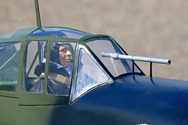

Spartacus is the consummate traditional builder. He hand-crafts each part of the model. For GRP moulded items, such as the radial cowl, the undercarriage spats and the canopy, he makes all his own plugs, masters, moulds and tooling. From these he produces his own scale cowls, canopies and scale details.
COCKPIT DOOR
Besides moulding the cockpit canopy from his own plug, Spartacus set about modelling the D21’s distinctive cockpit door arrangement. This is a significant part of the D21’s character. The opening cockpit door, complete with piano hinge, is a minor work of art.
The fine pilot, with the oddly familiar-looking face, was sourced by Mark from FighterAces.

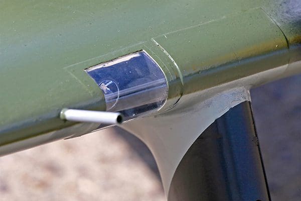

The high visibility landing lights were sourced from BRC Hobbies.
The wingtip lights came from Maplins.
