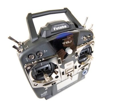

BUYING NEW
If you’re in the market for a new radio then 2.4GHz is what you’ll be buying. The frequency delivers a number of significant benefits not least the fact that it’s far less susceptible to noise and interference. Choosing a system can be a problem for there are so many different protocols out there, each with their own acronyms. In my opinion you have one choice and that is to buy a standalone solution. Brands like Futaba, JR, Spektrum, Hitec and Multiplex to name but a few. You’ll be able to use the standalone system with any aircraft you choose, although a new receiver for every aircraft will be required, and it’s here that the cost of additional receivers will have a significant influence on the system you choose. After you’ve made a shortlist of possible radios, go to your model shop and play with the transmitters to see which you prefer. Oh, and when you’ve done that, don’t walk out the store and buy online! Model shops need your support more than ever.
The modular nature of my faithful JR X347 Tx meant that it was possible to upgrade to 2.4GHz simply by swapping out the 35MHz module for a 2.4GHz unit. While this was the cheapest path, I was left with the X347’s Achilles heel: scant few model memories! As a result, it was only a short time before I made my first large investment in the form of a Spektrum DX7 with its 20-model memories. For most flyers, twenty is plenty.

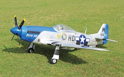

AIRFRAME
You may have some old loft queens still around that you’d like to resurrect. Again, proper checks need to be made as to their integrity. If a new model is on the shopping list then the choice largely depends on your previous ability and how long you’ve been away from the hobby. Don’t be tempted just to jump straight into the saddle again with the type of aircraft you were flying before. You may well be rustier than you think, so a versatile second airframe like a low-wing trainer, a Wot 4, or even a humble high-wing trainer may be the answer. Actually, the latter is a very good bet and will often be capable of basic aerobatics, especially if you increase the control throws.
No longer can you poke your finger and laugh at Chinese ARTFs, gone are the models made from pallet wood, held together with frog spit or covered in gaudy Blue Peter-style sticky-backed plastic. Nope, today’s offerings are made from laser-cut balsa and ply, many being covered in genuine Oracover (Profilm) and, in quality terms are much better than most modellers could hope to emulate. The choice is huge, too.
Don’t be tempted by that multi-engine scale job. Keep it simple and relatively cheap. Alternatively, if you wish to go back to traditional building, then although some kits survive, they’ll be hard to find in the shops such is the popularity of the ARTF example. Look harder though and you’ll see that many are still available, so ask your model shop owner and see what he can get for you, otherwise you’ll probably have to resort to mail order or show stands.

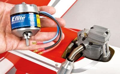

POWER UP
Glow engines remain a valid choice of power but they’ve been joined by electric and petrol. Electric power has become a perfectly viable alternative to glow, indeed, one that can match and even surpass the performance of our favourite methanol burner. Nevertheless, electric has its problems, one such being the ridiculous numbering systems that manufacturers use to label their products, motors in particular. The best advice here is to make one of two choices: Number one is to go with the set-up suggested by the airframe maker. Here, you’ll enjoy a hassle-free installation and be safe in the knowledge that what you fit will do the job well. The downside, in my experience, is that you can sometimes pay extra for this peace of mind. Number two, then (and this is what I do), is to look at the suggested power package and note down a few things:
- The power output (in watts) using the recommended propeller.
- The recommended propeller.
- Current (in amps) used on that propeller or its maximum constant handling.
- Size and weight of the motor
- Type and size of the Li-Po battery.
This, plus a lot of research on the internet will get you close to the required setup you’ll need. Now that’s fine if you happen to have a recommended setup with which to base choices. Sometimes, however, this isn’t the case, in fact you may even wish to convert an existing airframe (one that was originally intended for i.c.) to electric power. Here some established guidelines can help, notably the ‘watts per pound rule’ – a good guideline for starters.
If you choose a lightweight vintage-style floater, then 50 watts / lb will probably be enough. If equipping an aerobat, then aim for 100 watts / lb. Finally, 200 watts / lb will suit 3D and extreme aerobatic machines. It’s worth seeking out your club’s electric guru, tell him what you’re thinking of buying along with the recommended setup and see what he thinks. Alternatively, make use of RCM&E’s friendly forum here at www.modelflying.co.uk.

LET IT GLOW
If you prefer the i.c. route then fear not, engines are still around and even better than you remember. ASP and SC have finally got their act together and are now fantastic value for money. Even four-strokes are wonderfully reliable and fine everyday engines.
The old names are still there as well: Irvine, O.S., Enya and Saito are amongst others that have survived the electric onslaught and if you’re fortunate enough to be able to afford one you’ll not be disappointed. Fancy something bigger? Well, petrol engines are more popular than ever before and no longer the converted chainsaw lumps that couldn’t pull the skin off a rice pudding. Powerful, purpose-made petrol engines are available and at a price you’d never have thought possible.
