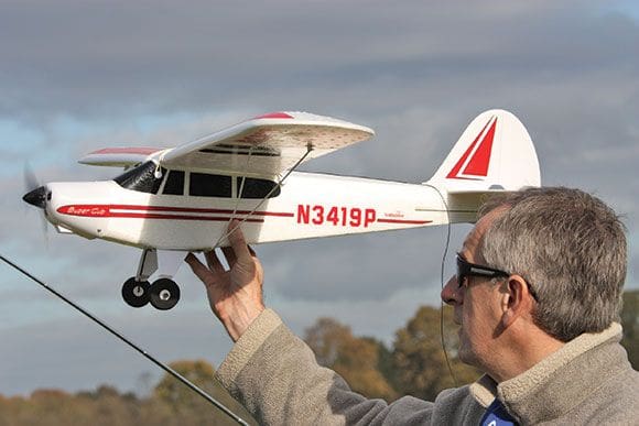

HobbyZone Super Cub. A superb model that’s supplied as a package, complete with everything you need. It flies very well indeed, looks great, spares availability is very good and the model is reasonably robust.

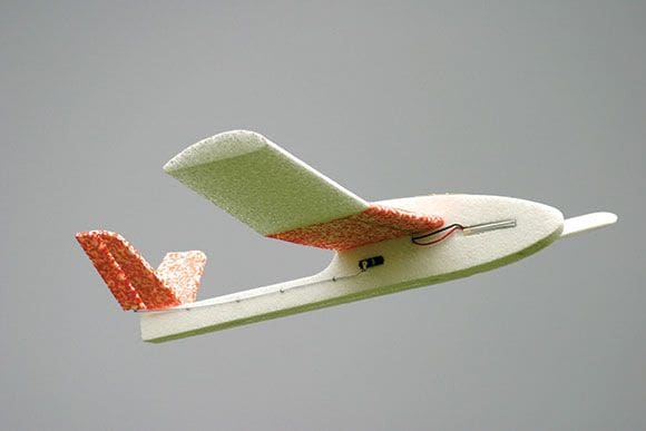

Flying Wings V-Trainer. The V-Trainer’s overriding advantages come from the pusher prop and EPP foam construction so it’s extremely crash-proof. Of the models listed in this section, it’s by far the most robust. It’s a kit, so note that you’ll need to fit your own power system and servos.

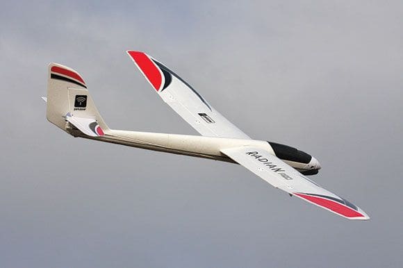

ParkZone Radian / Radian Pro. A popular motor-glider series. The three-channel Radian has taught many whilst the five-channel Radian Pro (pictured here) offers a superb progression. Both are available in BNF and PNP formats.

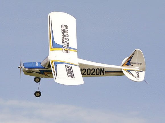

Multiplex Easy Cub. A large, docile, proven three-channel trainer kit. Radio gear and a power system must be purchased separately.

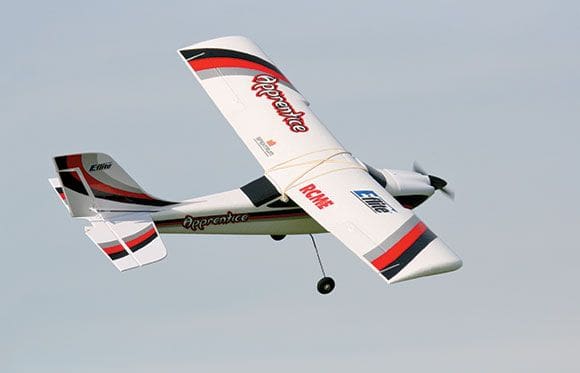

E-flite Apprentice. A well-developed traditional style four-channel RTF trainer that’s available in PNP and BNF forms.
