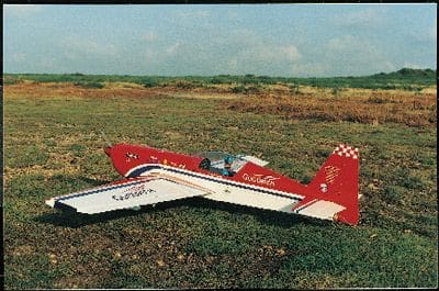

One Monday morning a few weeks ago, while getting bored with decorating and wishing for the weekend to come around again, I decided to have a peek at the Motors & Rotors website. There, I found Graupner’s latest ARTF fixed-wing scale model: an Extra 300. Pictured on the site was an example already built by Dave Wilshere (proprietor of M & R), finished in the Patty Wagstaff / Goodrich colour scheme and kitted out with a new Super Tigre 90.

All-up weight of my model was about 3kg., even with an ST 90 up front!
At the outset, I realised this would probably guarantee pretty impressive and predictable vertical performance. I’d chosen to put the battery behind the rest of the radio, toward the back of the wing seating area and just under the start of the pushrod runs. As luck would have it this provided a pretty accurate C of G position to kick off with.

Oh dear. Test day, and a Force 5 wind blowing right across the runway. But, before long, and with the engine already run-in, I was goaded into trying it out. The agreement was this: if I could taxi the model from the near end of our runway, where I was, down / crosswind to the opposite end and turn back nicely for my up / crosswind take-off, it would be a deal.
I expected this task to be very tricky, and thought I’d soon have an excuse to abort for another day. Alas, despite that strong wind, the Extra happily trundled down the tarmac with plenty of tail-wheel authority. The subsequent first flight was okay, although it really wasn’t all that fair to judge; the wind was extremely turbulent, but she coped surprisingly well. Landing proved to be straightforward too, with the model displaying a very predictable and safe reaction to rudder inputs as she came in crosswind. Boy, how I looked forward to trying again on a nice day…
WRING IT OUT
Well, try it on a nice day I did. Suffice to say this is a terrific value-for-money model in the sky, too; the Extra 300S is very easy and forgiving to fly, and yet very capable for the more experienced pilot wanting a bit of aerobatic fun. I thoroughly enjoyed wringing her out, especially since she was displaying a penchant for tumbling and flick manoeuvres – very crisp, and simple to achieve. As for the balance, it seems I got the C of G just right, but she did require a little more right thrust – no problem, a couple of extra washers under the front lugs of the engine will sort this when I can be bothered. Right now, I’m having too much fun with her!
Knife-edge spins are very effective, and a synch to perform. Lomcevaks, tumbles, knife-edge flicks, flat spins… the Extra will do ‘em all. Actual knife-edge flight is straightforward, and despite the ‘normal’ size rudder, the ST 91 provided enough power for her to climb the first half of a knife-edge loop. A truly well behaved aerobatic model, although not one for the 3D end of the envelope; control surfaces are a little too small for that, but hey, everything else is just great.
