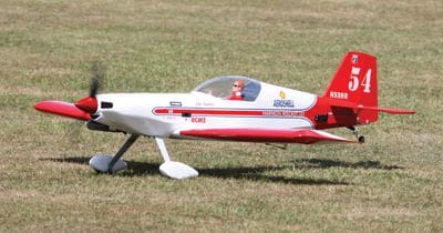

First introduced in 2004, Seagull’s Harmon Rocket hasn’t appeared in the pages of RCM&E so it’s nice to have the opportunity to examine this popular low-wing trainer/aerobat. The model draws inspiration from the full-size machine designed by John Harmon which you’ll have quickly surmised, is closely based on the Vanns RV-4. A development of John’s two-seat Rocket II, the III is built for speed and speed alone so no surprise that the slick machine is capable of 250-300mph. The kit has remained in production for seven years, a testament to its popularity and Seagull has ensured that build quality has improved in line with the efforts they’ve made with newer releases.

The instruction manual hasn’t kept pace in the undercarriage dept either – the undercarriage legs now bolt flush with the underside plate instead of slipping through an aperture and exhibit a slightly forward rake angle. It’s not a problem though and the laser-cut airframe slips together effortlessly enough, fit and finish is good, the hardware fine too.
Seasoned Rocket campaingners often point to the spats as a source of weakness – fibre glass they may be but it’s pretty thin stuff. A problem then? Well I’m not so sure, I’ve found that this means they’ll flex rather than crack when the going gets tough although I’ll admit to having a smooth grass surface from which to fly, just as important, wheel clearance is generous.
A long cowl means there’s plenty of room for any .46 – .60 size two-stroke although the slim front end means a good deal of trimming to accommodate a standard silencer. Do it though or fit a Pitts muffler. A four-stroke would be fine although down-to-earth sportsters like this seem at home with a two-stroke doing the pulling.

Ground handling is excellent where the revised undercarriage arrangement no doubt helps and, with a smidgeon of rudder correction, the model will rise gracefully after a short run. The Rocket tracks well, it’s predictable and safe with the .52 providing just the perfect amount of power. Low wing tyros will be fine using a good .46 but I’d strongly suggest that experienced pilots consider the larger motor.
Ground handling is very good.
The model will happily accommodate all skill levels although, as I say, experienced pilots will find the low rate settings deliver a sedate performance that’s hardly in keeping with the Rocket’s racy persona. On the aerobatic side, the model could be described as entirely traditional in its repertoire yet still capable of impressing non-the-less – big loops come easily helped by the pull from the .52 and the large rudder ensures that knife-edge can be held with very little coupling adjustment. Like many models, a fraction of right rudder helps hold the vertical line but this could easily be mixed out or adjusted with the addition of a little more side thrust.
Article continues below…Inverted flight requires a little forward stick pressure at the suggested C of G yet here also, the model tracks well and will soon encourage those low inverted fly-bys. Like all racers, the Rocket looks pretty enough through a simple low banked pass, better still, a fast one, yet, at the other end of the spectrum, it’s a very friendly aeroplane with fine slow speed handling, the sedate stall coming at a point where you’ll only have yourself to blame if it comes as a surprise.
Landing the Rocket is just a case of bleeding sufficient speed in the approach, more than you’d at first think, to ensure that the rigid undercarriage doesn’t re-launch the model at every touch down. A low, fast downwind dead-stick situation has been proof of the Rocket's ruggedness. Faced with a model that would have ended up in the boundary hedge, I yanked in some elevator and pulled her round, the ensuing turn killed all speed to the point of stall dumping the model down from 4ft or so yet enough only to crack the cowl.
