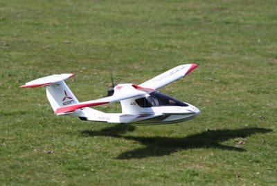

The model is supplied with fixed undercarriage and a nose wheel steering linkage is also included. I’ve made a few flights with the gear in place but, to be honest, the drag is notable and it’s a smoother, nicer flying machine without.
With care it’s possible to hand launch the Icon although it will get away from a smooth wet grassy surface too and belly-landing on grass should pose no problems. Use the manual for the C of G and control throws, they’re fine starting points, Spektrum DX7 and DX8 owners can download model settings if they prefer.
