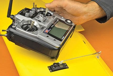

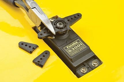

3. Remove the servo arm, power-up your radio gear and ‘centre’ the servo using the transmitter’s trim button. Replace the servo arm in the required position – commonly at 90° to the pushrod – then cut off any unwanted extensions to prevent fouling.

6. With the servo centred and the control surface set to neutral, measure between the hole in the control horn and the servo arm. This will be the finished length between the clevis pin and the right angle (or Z-bend) at the servo arm.

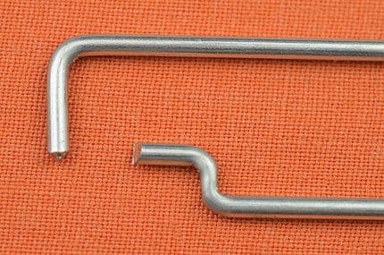

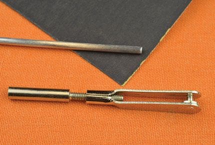

7. If using a threaded rod, attach the clevis leaving sufficient thread for adjustment in both directions. Using the measurement obtained in item 6, create a right angle bend in the plain end to take a swing keeper. A Z-bend won’t need a keeper, of course!

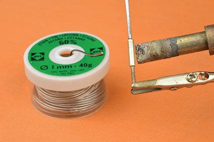

8. If you’re using plain unthreaded wire, these threaded couplers are specifically designed to be soldered onto the wire pushrod. Before soldering takes place, however, the end of the wire must be polished to a bright finish. I use emery cloth for this job.
9. If using a threaded coupler, solder it onto the plain wire pushrod. A 70 – 100 watt soldering iron will make light work of this job.
10. Now screw the clevis onto the coupler, once again leaving sufficient thread to allow for final adjustment in either direction. Use the measurement obtained from item 6 to make your right angle or Z-bend.

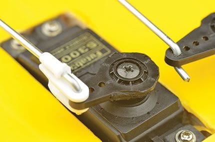

11. Connect the Z-bend or swing keeper to the servo, then check to make sure the servo is still centred. With the control surface held in the neutral position adjust the clevis to the required length and snap it in place.
