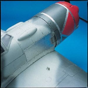

Although you’ll be keen to get on with the fuselage, it’s worth assembling the cowling first. The mouldings supplied in three parts, and it’s handy to use formers F1 and F2 to support the pieces while you glue and tape them together. Speaking of glue, I used the solvent sold by plumbers merchants for gluing polypipe and, once it had set, the joints were reinforced by laying glassfibre tissue and resin around the inside of the cowling.
You’ll see that I was able to keep the cowling lines clean by doing away with the mixture needle. Mixture control for the model’s SC .52 four-stroke engine is now managed by a servo mounted behind F2. This means that fuel metering can be adjusted in-flight, and it’s such a neat and simple alternative to untidy needles, I’m surprised more people don’t do it.

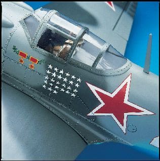

Prior to fitting the canopy you may want to embellish the cockpit area with the Warbirds pilot and instrument panel, just to add that finishing touch. In truth, the LA7 instrumentation was notoriously basic, extending to little more than a compass, asi, vsi, rev’ counter, temperature gauges for oil and engine, and a clock. Anyway, this done, the model was covered with brown parcel paper, the ABS gun breech mouldings added, and the whole kit ‘n’ caboodle was sealed with a coat of dope.
Impressive as the Warbirds decal pack is, I rather enjoy painting the insignia on my models as it means I can individualise them. The colour scheme that I chose in this instance is that of White 27, which was flown by Ivan Kozhedub, the Soviet Union’s highest scoring fighter pilot during W.W.II. Apart from Kozhedub’s success against the Germans – he’s credited with 62 kills, and was the only Soviet to shoot down a Messerschmitt 262 – White 27 was one of the few La7s to have the star insignia on top of the wings.
The main colour scheme was applied using Humbrol enamels and an airbrush (use aerosols if you don’t have an airbrush). As for the insignia? These were marked out lightly with a pencil, outlined with a ruling pen, then filled with brushed enamel paint. Panel lines were added with a fibre tip pen, and the rivets highlighted in white before the whole airframe was given two coats of polyurethane satin varnish.
