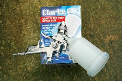

I’ve a collection of several spray guns of different types, and I find that gravity fed guns (with the paint reservoir mounted on top) are more than adequate for the size of models I build. These are often referred to in the car repair business as ‘touch-up’ guns and are smaller than the ‘siphon’ variety that have a very large can on their underside.

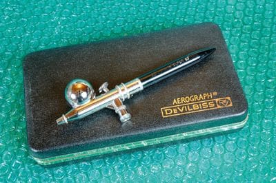

My DeVilbiss airbrush – used for spraying the reg' numbers onto the fuselage sides.

Article continues below…The Clarke gravity fed spray gun that I use for larger areas.

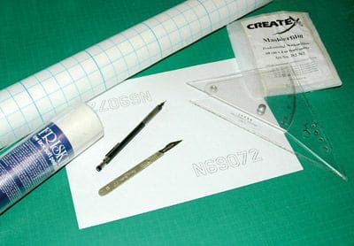

The lettering print out and roll of Frisk film prior to my little light box trick.
I needed a spray mask for the registration, which I made using Frisk film, a low-tack, self-adhesive masking medium that’s available from graphic media suppliers in both sheet and roll form. Laying the computer-printed registration onto my home-made light-box and taped Frisk film over it. With this, the printed registration became very clear through the masking film and with a new blade in the scalpel, plus a steady hand and straight edge, I cut out the letters to produce the two sets of masks that were required. These were then carefully stuck in place under the tailplane with newspaper masking around them to stop overspray getting on the rest of the model. The registration was then painted using black gloss paint through a fine airbrush.
