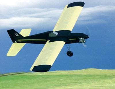

For a forty-class model, this aircraft is not small; it has a good wing area, and a delightfully chunky look. A key point made by the original designer is that his Maricardo embodies most of the advantages you expect with a low-winger, but retains the security and good manners of a shoulder wing design. I’d also say the Maricardo is a very easy model with which to learn tail-dragger take-off techniques, especially, if she’s a follow-on from your first high-wing, tricycle undercart trainer.
Starting and adjusting the engine in a Maricardo is very easy since everything is to hand – something that is not to be underestimated if you intend getting in lots of aerobatic practice. Maricardos are good all-weather fliers, and have a decent amount of ground clearance. Moreover, handling on the deck is first rate, and the overall aerodynamic layout confers great stability in the air. They suit our blustery British winter conditions, and handle gusty winds very well.
However, Maricardos aren’t just good aerobatic trainers, they also provide great sport for competent pilots too. Fit a bigger engine, dial in way more throws than were ever envisaged in the seventies, and you have a very potent aerobat. They’re also good for learning the fundamentals of control mixing in a forgiving airframe. If you’ve just bought a posh computer radio and have no idea how to exploit it fully, then a Maricardo is for you.
VICELESS AND PREDICTABLE
Overall, the great thing about a Maricardo is her smoothness and predictability in the air – these qualities mean she’s a very easy model to fly cleanly and neatly through club aerobatics. In my experience, the Maricado always has a solid ‘sit’ in the air; this makes her easier to judge in, say, a stall turn, bunt or loop. I’ve flown three or four with different engines and set-ups, and amazingly (perhaps I shouldn’t be so surprised), they’ve all had the same, comforting laid-back handling characteristics. It’s in the genes.
Maricados have got speed and excitement when you want it, and an easy grace and stability when you don’t. Inverted flight requires little or no forward stick, and spin entry and exit (with the modifications set out earlier) are both very positive. With a good bit of aileron deflection dialled in at the transmitter, she overcomes her natural stability, and rolls like a good ‘un – highly axial, even without a dab of elevator as she passes ‘12 o’clock’ inverted.
She’s a genuinely viceless flier, and a newcomer to aerobatics can simply throttle back and buy some breathing space before re-entering the fray. I’ve watched our Gareth doing lazy, low, slow rolling circles with his Maricardo, and find I become hypnotised just absorbing all the synchronised stick inputs, and the model’s correspondingly smooth progress. You do not have to hurry manoeuvres with a Maricardo – just select an appropriate throttle setting, and take your time.
When it comes to flying through huge loops at three-quarter throttle, or performing leisurely reversals far down the strip, the Maricado looks particularly good. The glide is first rate, as you would expect with that wing area and such a modest weight. Long, slow approaches are the norm, while dead-stick approaches are entirely relaxed affairs. Maricardos do not drop wings, have vicious stalls, or try to catch you out – probably the main reason why such a range of pilots, from beginners to experts, swear by them. The fact is, you look good flying a Maricardo, even if, like me, you’re definitely just a bog-standard club pilot.
