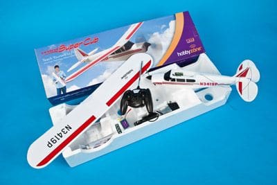

The box is well presented and states “Teach Yourself to Fly! Anti-Crash Technology makes it possible” and the model is identified as Skill Zone 1, no experience needed and ready to fly (RTF). On sliding out the inner packaging one is presented with a nicely finished model in white foam with red and black trim. The mini Cub has approximately 2/3rds the span of its larger brother, which it closely resembles. The fuselage is, easily repaired, Z-Foam, the one-piece wing and pre-fitted tailplane laminated foam. The included 27MHz transmitter has an ergonomic casing and extending aerial. Both left and right sticks centre by spring pressure there being no ratchet or friction provided for throttle control.

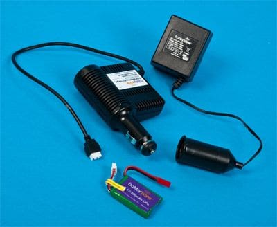

A deeply recessed switch allows selection of Mode 1 or Mode 2. Motor arming is achieved by pulling the throttle stick fully down, ACT is activated and deactivated by pushing the rudder stick inwards towards the transmitter. A tie-on ribbon is included and doubles as a useful wind indicator. A quick start guide is provided for experienced flyers and a detailed manual and instructional DVD for the novice. The manual is well presented providing assembly, flight and safety information. I love the upbeat instructional videos from Hobbyzone as they generate the right mood for success. A spare prop, 300mAh Li-Po battery, AA batteries for the Tx and a 12V car charger with additional mains adaptor complete the package.
The one-piece wing is fitted to the fuselage using four elastic bands, check for central positioning as you do so. Squeezing the main undercarriage legs together makes it easier to fit. The non-steerable tail wheel simply slots in place. The flight battery took a little over an hour to charge using the mains adaptor. When ready, switch the transmitter on and then connect the flight battery. A Velcro strap secures it for flight and a neat plastic hatch with catch gives further security. Before flying, check the control surfaces are in the neutral position with the transmitter sticks centred and that the controls move in the correct sense. That’s it RTF!
