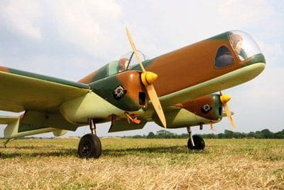

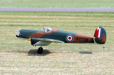

Long-time modeller, sometime Nats scale judge, and Cotswold Kits supremo, Syd King is the designer of the Bobsleigh model. He describes the Desford as the ideal twin model: “Two rudders – both in the prop’ wash – and a fixed undercarriage!”
PHOTO-FIT
Syd worked from photographs to arrive at his own plan, using what he cannily terms ‘reverse isometrics’. The model certainly looks convincing, though Syd refers to it as a typically “sport-scale / large scale model. The construction is of largely traditional built-up structure with the addition of Syd’s own-design / own cut foam wings. This is hardly surprising, given Syd ownership of Cotswold Kits, famous amongst other things for their foam and fibregless pylon racers such as the Tracer. The fuselage is entirely built up on conventional frame formers, and then skinned using 1/8 balsa. The tailplane, fins, and rudders are built to the ‘Brian Taylor method’ with a central core of 1/16 balsa, skinned in 1/6 balsa riblets. Overall finish is traditional tissue and dope, topped with Flair Spectrum paints.
Turned on a Myford lathe by Syd’s mate John Parker – he’s the engineer in their little group – the undercarriage legs are damped with 1/2” springs bought in a bagful from one of the shows. Wheels are Flair Tiger Moth types.
PETROL POWER
Ultra-reliable, the two Zenoah 26s feature standard silencers that are conveniently accommodated within the cowlings. The tanks are 500ml each side, allowing 14 minutes duration – easily long enough for an LMA flying slot.
Highlighting the only disadvantage of the twin fin configuration is the fact that an extra servo is required to drive the steerable tail wheel. This is operated by the rudder channel, via a three-way lead. As Syd wisely observes: “You really need a steerable tail wheel with a twin…”
The RS-4 is fitted with flaps, which are small but effective. They deploy to 70°, giving a usefully steep approach. Pitch is neutral on deploying the flaps, conferring virtually no trim changes. Apparently the aeroplane is delightful to fly, very stable, with crisp controls. Syd has even tried deliberate one-engine landings, and noted hardly any trim change. In flight, the Desford looks appropriately quirky and British.
