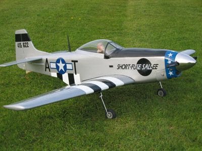

First job here is to trim the fibreglass cowling to suit your chosen engine, then cut and fit the canopy. A pilot was glued in and the canopy adorned with some trim tape on the inside to highlight the framework before securing it to the fuselage using eight self-tapping screws.
Wing fairings are usually glued to the fuselage, but they are glued to the wings on this one. The fairings are again made from a plastic moulding and a bit of covering has to be removed from the wings before they can be glued into place. There’s a huge, polished aluminium spinner in the kit and it looks great, proudly pointing the way forward.
One’s final, and most rewarding, task of the build is accomplished with the addition of some decoration in the form of decals supplied with the kit. The controls and C of G were set up as per the instruction book and all that was needed thereafter was a sunny day to take it out to play.

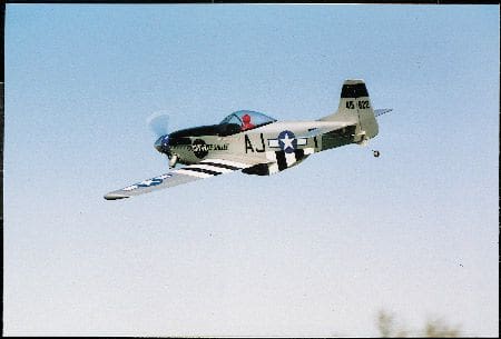

With a roll of film shot, I sent the model to the heavens and really began to explore what she could do. This is definitely not a prop-hanging, 3D-type; she’s a scale model and knows it. That said she has excellent manners and can pour out the fun just like any good sports design. She’ll respond obediently to the merest command and, with the power available from the YS, enormous loops can be flown. Better still, try rolling lazily from horizon to horizon – fabulous! The rudder authority is a bit tame when flying more serious aerobatics, so with increased movement (i.e. doubled!) it’s now more ‘in the zone’. Stall turns are crisp and graceful and she’ll spin quickly whether the right way up or inverted. Spin recovery is virtually instant with no heart-stopping extra turns before she pulls out. Flick rolls are good… fast and clean, stopping when the sticks are centred. In fact, the flicks are so good the pilot’s head fell off during one of them… oops!
With the increased rudder movement the model could now fly knife-edge, making long, four-point rolls a doddle. Flying inverted presented no problems and just required a bit of down elevator to hold her level. This is a very stable aeroplane that handles well, whichever way up you want to fly it.
Whilst the Mustang is capable of flying aerobatics, she really looks best chasing after Me109s or flying around at low altitude, where she shows off her lines and markings (and that great big silver spinner) to maximum effect.

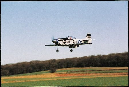

Landings are fairly straightforward. As you might expect, the big radiator scoop underneath the wing creates a bit of drag, so when throttling back it’s best to keep to a couple of notches above idle. She comes in very slowly, so there’s no need to be too timid with the throttle. Drop the wheels, line her up and drive her in, throttling right back just before touch-down. And if you get it right, she’ll settle onto her main wheels and roll a few yards before the tail comes down. Lovely.
CLASSY CADILLAC
Having flown the Mustang for several hours, it’s proved to be an extremely well mannered sweetie which looks terrific on sunny days and is great fun to fly. It’s now fully sorted out and can fly from horizon to horizon hands off. No problems have materialised with the construction quality, and the retracting u/c has stood up well to grass field use. Several people have flown the model, they’ve all liked it and been pleasantly surprised at how easy it is to fly. A common phrase heard amongst those who’ve flown the Mustang… “What a fabulous aeroplane.” Enough said!
