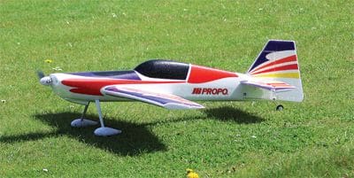

Enter the ST Model ‘MX-2’ which fitted this brief perfectly. Distributed to model shops across the UK by Ripmax, the MX-2 has a wingspan of 1210 mm and is pre-fitted with a 920 kV brushless motor, a 30A speed controller and four mini servos. The model is moulded from white EPO foam, which looks to be tough and fairly ding proof. A couple of large sheets of self adhesive stickers are supplied to add a rainbow of colours, giving a livery that is very pleasing to the eye. The only drawback is that there is just the one colour scheme so if your club mates take a shine to this model then you could soon be surrounded by a squadron of MX-2 clones. ST has alternative sticker sheets for this model, so it would be great if Ripmax could offer these as an option, just to add a little variety.

The first task is to attach the ready made undercarriage.
This screws to a plastic plate moulded into the EPO foam. The screws supplied have fairly soft heads and the plastic is quite tough, so be sure to use the correct size screwdriver to avoid rounding the heads.
There are tales on the internet forums of the undercarriage on this model ripping out but it seems pretty tough and I have not had any problems. All the landings so far have been fairly neat and onto short grass. If you fly from longer grass it may be prudent to take off the spats to stop them from catching and bringing the model to a dead stop.

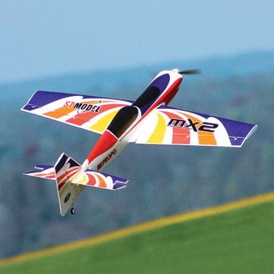

But ST obviously did a good job as he went straight into a rolling thingy-ma-jig (apologies to 3D fans for not knowing the terminology!). Several other ‘thingies’ followed (I thought a Harrier was a jump jet!) before Steve pronounced that all was OK. I’ll let Steve describe what he was up to in his own flying report. With a new battery loaded up, it was my turn. Take off was a non-event and with the MX-2 established at a decent height, I flicked into the aerobatic flight mode. For a club flier like me the ailerons offered a responsive but not too aggressive roll rate. Like Steve, I would have liked a lot more rudder to hold knife edge, but this should be no problem as there is plenty more movement available once the screw-lock has been moved inwards on the horn. For me, elevator was a little too powerful and I will be toning down this down to practice FAI style aeros.
I didn’t try the third flight mode as Steve had warned that the ailerons had too much throw. But I will tone this down and increase the tail throws so that Steve can really wring it out the next time he flies it. There is no doubt that MX-2 is fully 3D capable. Flicking back into Normal flight mode, it was time to bring the MX-2 into the circuit. Landing was a smooth, easy affair.

A quick range check with the JR RD721 receiver and DSX9 transmitter showed no problems so the model was taxied out onto the strip and lined up on the runway. Kevin was ready with the camera and so the throttle was opened. The model tracked straight as a die and lifted off in no time. One click of left trim, one click of down was all that was needed. So it was immediately pulled up into a vertical climb to see what the performance was like. I was quite surprised to see the model track vertically with little or no correction, and with a nice climb rate. Vertical rolls were performed which seemed a little slow even on high rates and seemed to just send the model off track. I felt that there was a little too much aileron travel on high rates. It just seemed to create drag. Cutting the travel back actually improved the roll rate, still leaving plenty of control authority for the slow, high alpha stuff.
Personally I would like to have more movement on both the rudder and the elevator although high alpha and prop hanging manoeuvres are achievable with the current settings. Harriers are particularly nice, both upright and inverted, with very little wing rocking, just leaving the throttle cracked open a little, and are easily controlled by the rudder. Transitioning the harrier into a high alpha pass and figure of eight only needed a little more throttle to stop it descending and then balancing the controls as needed.
Large IMAC style aerobatics are a breeze with the MX-2. Loops, multi point rolls, spins etc. all just fall into place. Knife edge flight is also very nice but as I said earlier, I would like a little more rudder which Kevin is going to sort out for the next sortie. But the controls are well balanced and only a touch of up elevator is needed to hold the MX-2 steady.
