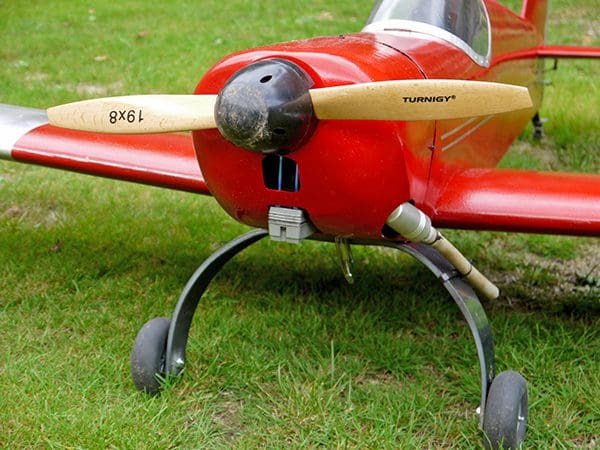

NGH GF38 installed in the Privateer, showing the silicon tubing extension and needed because the exhaust gases are very hot and will burn anything they come into close contact with, in this case the undercarriage.

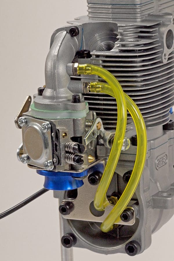

There are two Tygon tubes connected to the rear of the crankcase, one to operate the carburettor pump and a second to recycle crankcase oil back to the inlet manifold. A third connection, between the main bearings allows some excess oil to vent this way and is probably located to ensure a portion of the oil is circulated through to the bearings and camshaft. The recommended oil content is 35:1, just less than 3% oil, and to accommodate this low oil content the connecting rod dispenses with plain bearings and instead uses roller bearings at both ends.

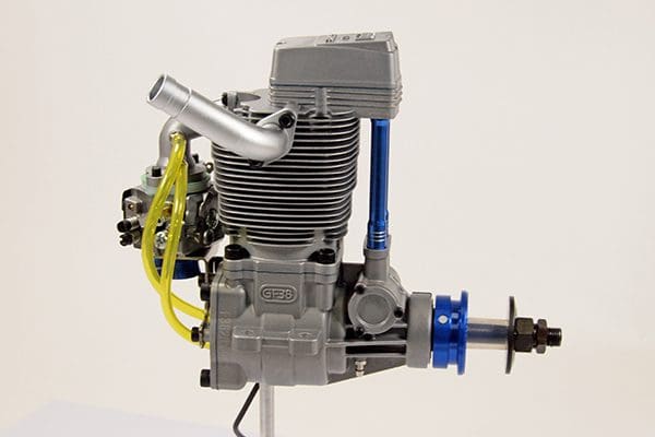

The overall finish of the engine is very good with nice smooth casings and blue anodised push rod tubes, carburettor inlet trumpet and propeller driver.

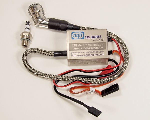

Auto advanced ignition unit is manufactured by RCEXL for NGH.
Ignition is by an RCEXL manufactured NGH CDI unit, triggered by a magnetic pick up that takes its signal from a magnet embedded in the prop hub so the spark plug fires on the exhaust stroke as well as the compression stoke, just like some Honda motor cycles I had back in the 1970s. A small CM6 spark plug is supplied to light the fire.

This engine is nicely finished, with a generous cooling fin area. Pushrod tubes and propeller driver are blue anodised for extra bling.

Installation in the Privateer was quite straightforward, with the engine mounted inverted on the beam mounts and the throttle operated by a standard Futaba 3003 servo. The choke was manually operated by a lever routed through the top of the cowl. The latter worked okay but fitting the operating rod was a pain after the cowl had been fitted so I reversed it to come out of the bottom of the model where the cowl was cut away to allow the hot air out. I cut a hole in the cowl for the cylinder head with a small air inlet directly in front of the cylinder and a larger outlet on the underside of the cowl, the outlet being approximately three times larger than the inlet. A hole was also cut for the exhaust, ensuring adequate clearance all the way around.

Carburettor is a Walbro WT962. The dual tubes to the crankcase are for carburettor pump operation and oil return from the crankcase back to the inlet manifold.

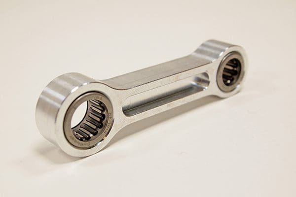

Robust connecting rod has roller bearings at both ends.

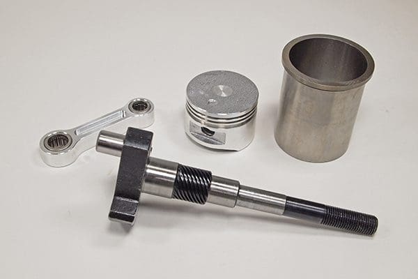

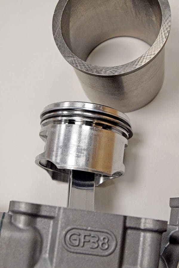

Connecting rod, piston and liner. Crankshaft uses a helical gear to drive the camshaft.

Piston fitted to the crankshaft. The liner is fitted inside the finned cylinder block. Although the piston has three ring grooves only two piston rings are fitted.

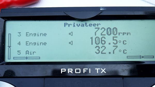

RPM and temperature readouts on the author’s Multiplex Profi transmitter.
On the factory setting the engine was running a little rich and at the end of the running in period we noted a maximum rpm of 6,800 rpm on the 18″ x 8″ Turnigy Aerostar propeller. Without the cowl the cylinder temperature was getting to 140+°C at short full throttle bursts.

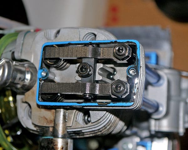

Valve clearances were checked after a couple of hours operation and found to be okay and well lubricated. Black staining beside the exhaust adaptor is because it became slightly loose and allowed some exhaust gas leakage.

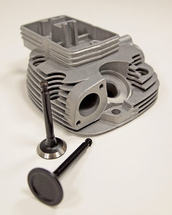

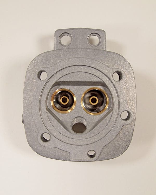

Internal shot of the cylinder head showing the valve guides and valve seats.

Cylinder head alongside the inlet and exhaust valves.
