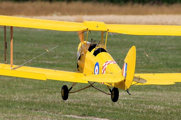

TIGER MOTH

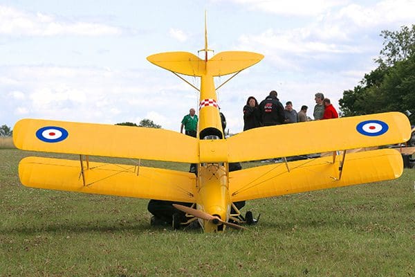

Gerd’s Tigger is built to 1:2.8 scale, with a wingspan of 125.6 inches. It was a collaboration between the aforementioned Scale Triumvirate. They based their plan directly on DH factory drawings. The construction is very much like the full size, with steel tube of square and round section.

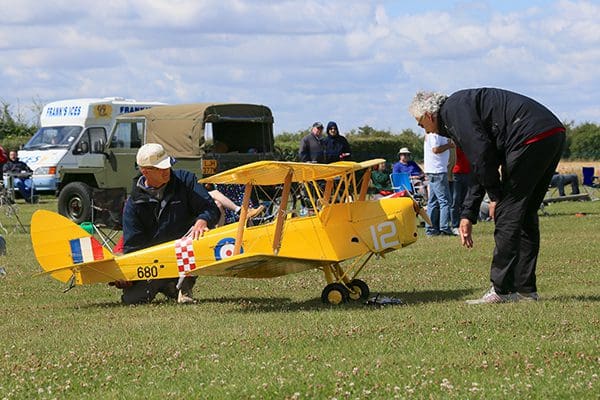

oct20magic3
Gerhard fettling his Tiger Moth at Little Gransden.
The wings are of wooden construction with steel bracing and fittings, just like on the full-size. Most significantly, the full-size aerofoil is also used. Similarly, the tail has a wooden construction with steel fittings, just like on the full-size. There are epoxy-glass parts, like the wing fuel tank and the nose bowl of the engine cowling. All these moulded items were produced by Toni Clark (Practical Scale).
oct20magic4
The Toni Clark Tiger Moth is 123” in span.
The Tiger Moth weighs 50 lbs. Since it was the prototype of the Paolo Severini kit released via Toni Clark, it flew with 3 lbs of ballast in the nose to compensate for a heavy tailplane. The production version was projected to weigh just 44 lbs.
oct20magic5
Gerd’s Moth flew at 44lbs after a bit of weight trimming.
Gerhard’s Tiger Moth is powered by a mighty Valach VM 120i2-4T inline four-stroke petrol engine of 120cc. There is even a custom-made stainless-steel exhaust. The prop used is a Fiala 30″ x12” wooden design.
oct20magic6
These are shots that I got of the phototype in 2015, as yet unfinished and crying out for a P1 and P2.
The superb undercarriage is fabricated from stainless steel tube, ready silver-soldered and included in kit. All the scale fittings, cockpit interior and streamline wires are included in the kit. The model was finished in two component polyurethane paint from the company ‘Relius’. All legending and decals are by Paolo Severini.

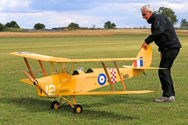

oct20magic9
Gerd was an elegantly tall man – it may look smaller but that huge model is 40% scale!

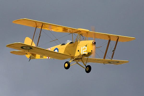

GERD’S FLYING NOTES
“A dream to fly, no matter if flown slow or fast. Easy to flat spin, recovery is simply by releasing the controls and rotation stops after two turns. Scale take-off and cruising flight is on about 33% power, with a super realistic sound. Full power is good for very big loops and high stall turns. She can also be flown and landed in very strong winds.”
oct20magic10
The Tigger has a wing area of 4,650 square inches – that is three square metres!
Model Name: Toni Clark Tiger Moth
Scale: 1:2.8
Wingspan: 125” (3.17m)
Wing Area: 4650 sq.in. (3 sq.m.)
Weight: 44 lbs as flown at Cosford
Engine: Valach VM 120B2-4T petrol
Capacity: 120 cc
Prop: Fiala 32″ x12” wooden prop
Controls: Ailerons, Rudder, Elevator

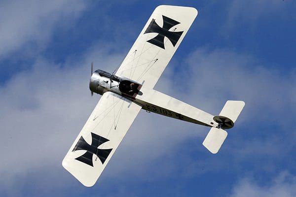

FOKKER EINDEKKER
First and foremost, Gerhard’s immaculate Eindekker is truly massive. She is built to forty percent scale and spans a majestic 159”. She weighs 44 lbs and is powered by a Valach 120cc petrol engine. This astounding Eindekker was built from the advanced kit from the unmatched Paolo Severini.
oct20magic11
Gerd positions the Fokker E.1 beautifully with just a touch of top rudder.
Paolo has the eyes of an artist and hands of an engineer. His kits have no close competitors. Their quality, fidelity and sheer completeness is unsurpassed.
Paolo worked hard on scale accuracy with the E.1. The model employs exactly the same aerofoil as the original. It also uses exactly the same +6 degree wing incidence. The model’s construction faithfully mimics the tubular original. Only metal and wood are used in the model. There is no fibreglass, balsa or carbon composite used in the kit.

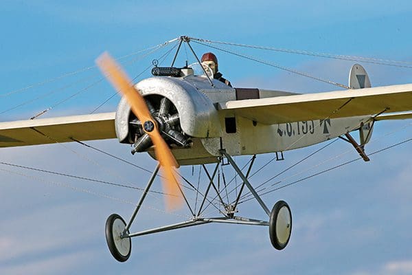

oct20magic12
Superb dummy engine to the fore, the Fokker comes in to attack its prey!
Paolo Severini returned to primary historical resources to draw up his meticulous plan. The kit is based on the later production E.1, with the larger aspect ratio wingspan of 10 metres. As per the full-size, the model uses a wire-braced steel tube fuselage. This, and the all moving metal tubed rudder and tailplane, have been sandblasted before finishing.

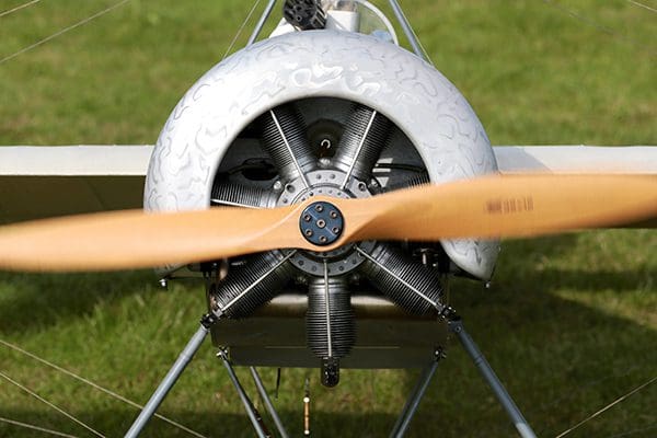

oct20magic13
The dummy Oberursel engine expertly masks a Valach 120 petrol twin.
The wing has plywood ribs threaded on to cedar wood spars. As mentioned, the ribs are a true scale section. The wing also has the full true scale wing warping mechanism. All steel fittings are laser cut and pre-bent ready for fitting. The pilot’s joystick is linked to the operation of the controls.

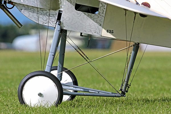

oct20magic15
Fully articulated scale undercarriage with rubber bungee suspension.
Gerd fitted a Valach VM 120B2-4T twin petrol engine. This was sourced from Toni Clark Models in Germany. It is a four-stroke petrol motor with a capacity of 120cc. The engine has nickel-silicon coated bores and uses Honda valves. It is fitted with a classic Walbro carb, familiar to generations of petrol modellers.

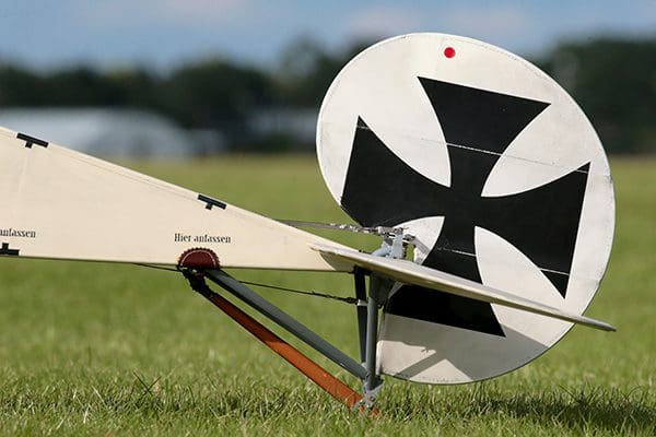

oct20magic17
Crisp, authentic detailing on the all-moving rudder and elevators.

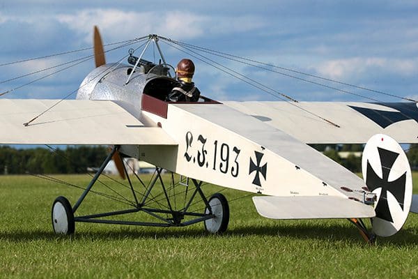

The aluminium cowl is supplied preformed, as are the cowl’s side fairings. A scale-like engine-turned finish is used. The superb fuselage cowling is from light aluminium sheet, of a heavier gauge than litho. The fully articulated undercarriage is true scale and fully functional. It uses rubber shock absorbers, bungee style. Gerd used scale wheels from a Toni Clark Albatros.
oct20magic18
My favourite angle for any Eindekker really shows off the essentials of the design.
The model has no ailerons. In authentic scale fashion she uses wing warping. This also means that the control stick is directly connected to the surfaces. The pedals are also connected to the elevators. Elevators and rudder can be easily removed for transport. All fixtures, fittings, cables, terminations and turnbuckles are faithfully reproduced in the kit.
Gerd used an adhesive backed woven polyester fabric called ProfiCover for the model. This is available from Toni Clark. Its particular property is that it shrinks more tightly along the roll than across it. Gerd painted the model with two-pack polyurethane from the Relius paint company.

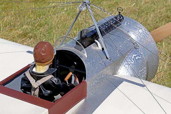

oct20magic19
Pilot is nicely dressed, and the cockpit is edged in leather. Note the crisp detailing on the machine gun and the king post.

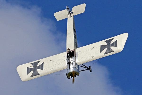

GERD THE SHOWMAN
Gerd was a superb pilot and a real showman. One of his party pieces with the Fokker was extended inverted flight. I have to say, scale or not, an inverted Eindekker is something to behold. However, Gerd’s most chilling manoeuvre was to dive the model vertically on full power, then flip her through a 90-degree pull-out at just above the deck. The G-forces this inflicts on the airframe are truly eye-watering but the Severini metal construction just shrugs it off.
oct20magic20
Gerd was not afraid to put the Fokker into hazardous attitudes at high speeds.
