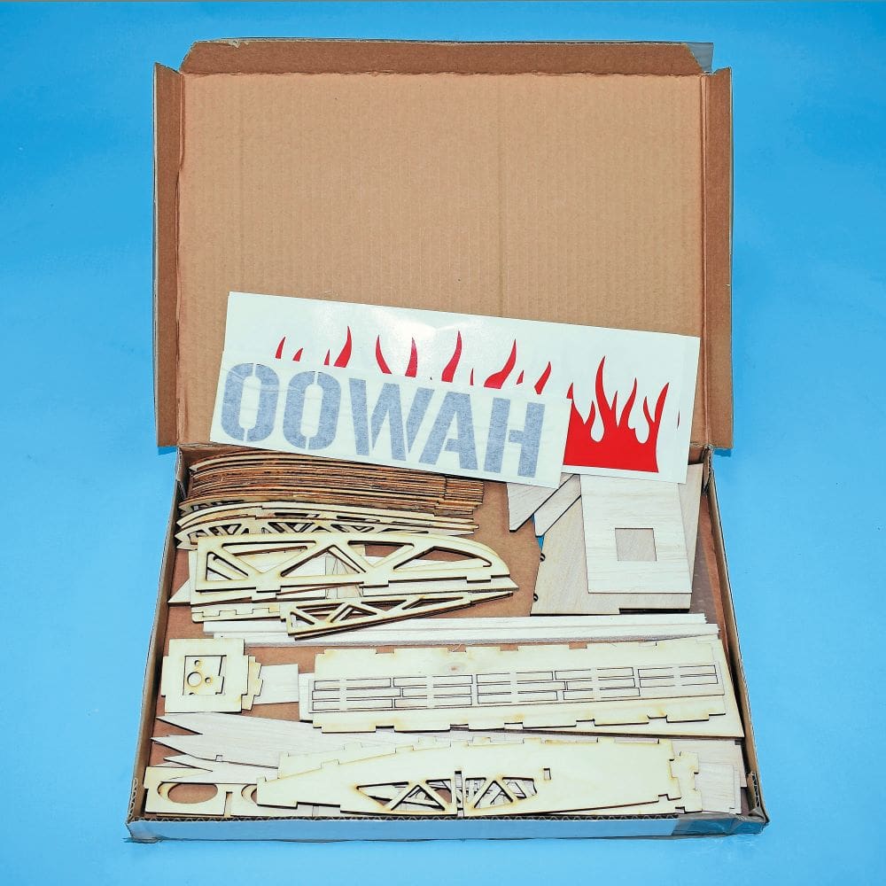

This kit is supplied in a simple box to keep costs down.

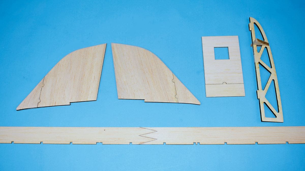

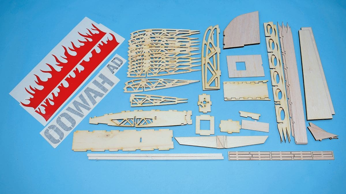

The laser cut kits use mostly lite ply for the ribs, spar, wing tips and fuselage, with balsa for the elevons and fins. When assembled it all makes for a very robust aircraft. You can see from the kit parts photo that a lot of unnecessary material has been removed and it certainly keeps the weight down, but with negligible compromise to the strength.
Unusually, the kit doesn’t include a plan, but this isn’t an issue and is intended because there’s a Facebook group dedicated to the build of the various models. Additionally, you can download the plan in tile form from this group, but it is essentially a guide and, genuinely, you don’t need a plan. However, there is a caveat – Oowah is designed for intermediate builders and pilots.

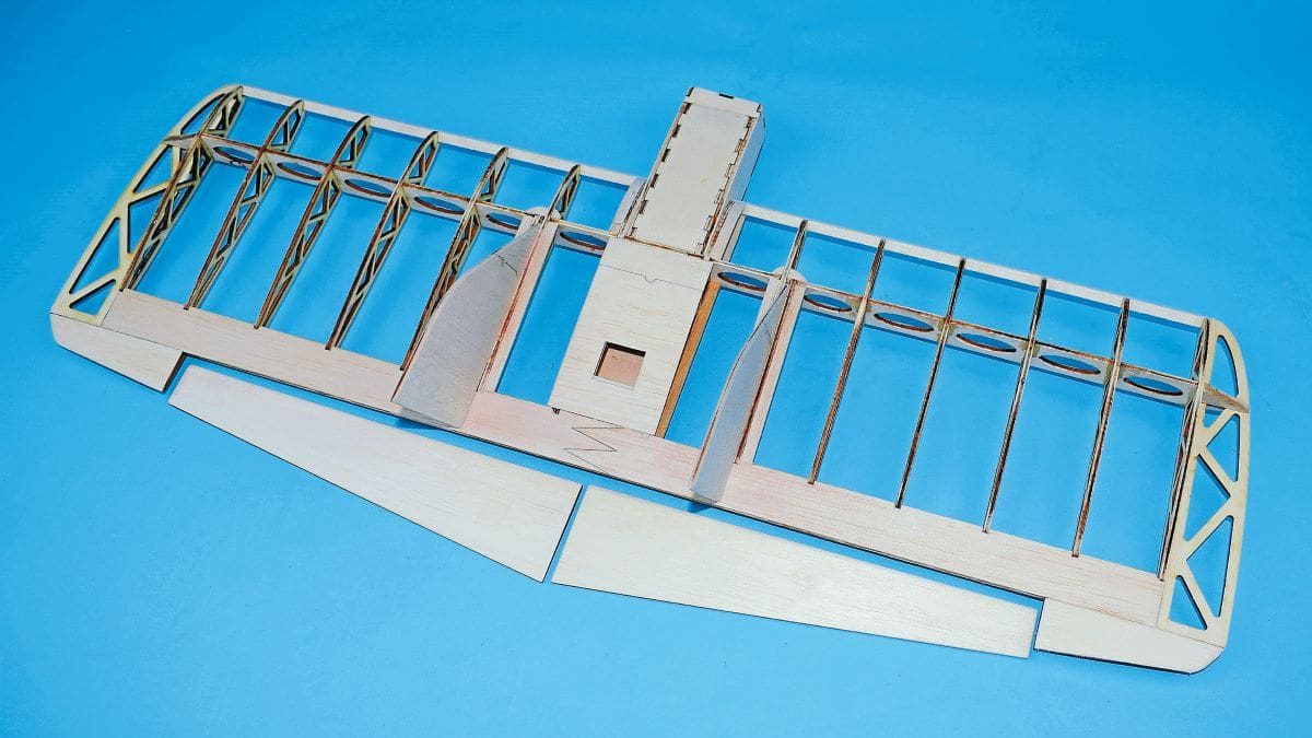

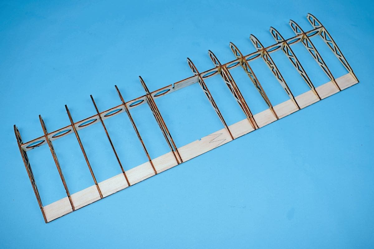

The quality of the laser cut parts is good and a credit to I.A.D. You start by making the spar joining the two parts together, along with the trailing edges. Ensure this is accurately done so the finished wing doesn’t emulate a banana. Same procedure for the trailing edge sheeting.

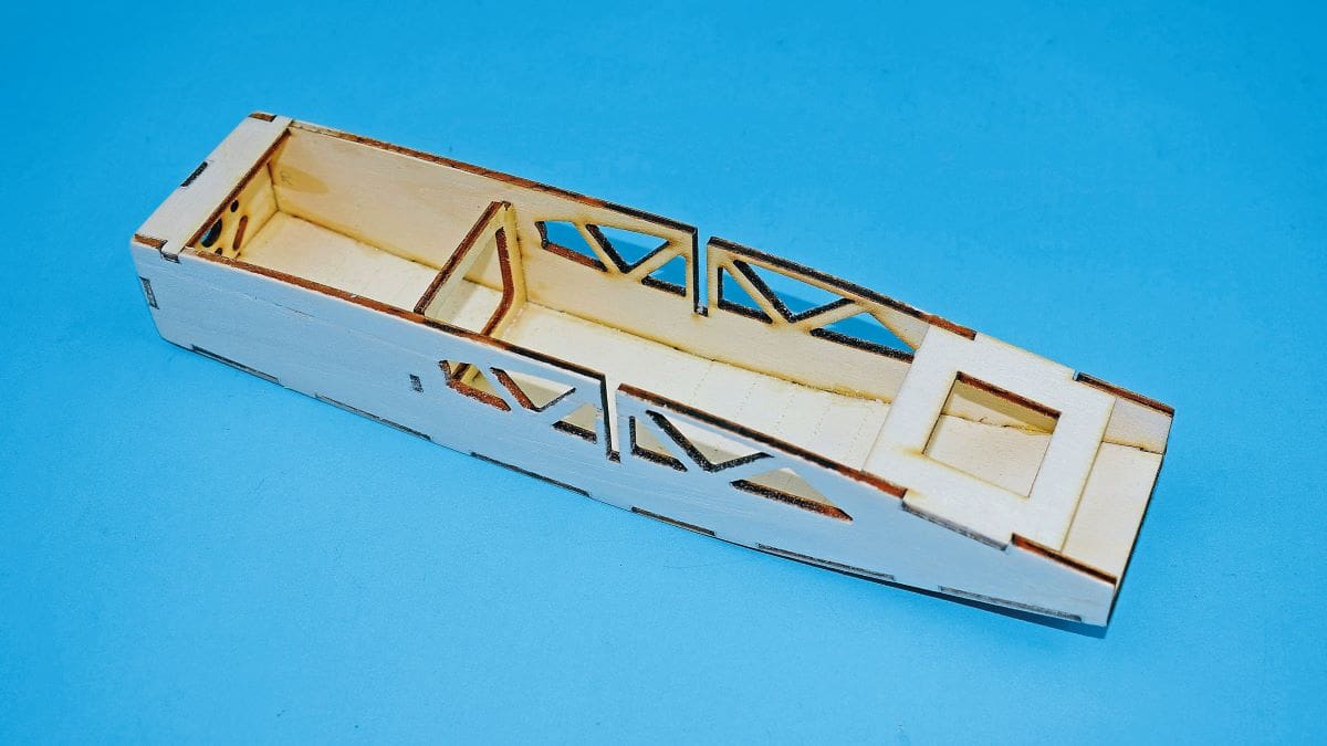

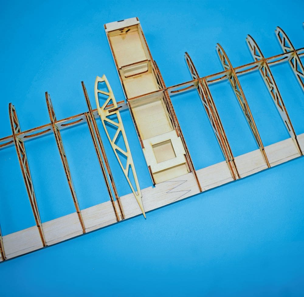

One suggestion I would make is to build the fuselage pod first before starting on the wing. The reason for this is if there’s any slight discrepancy with the inner wing ribs it could be a squeeze to fit the pod in. Make sure you have the correct right thrust when building as one fuselage side is slightly longer than the other. Also, you will note that the holes for the motor are not central. This is intended so that the prop nut ends up central on the fuselage with the built in right thrust.

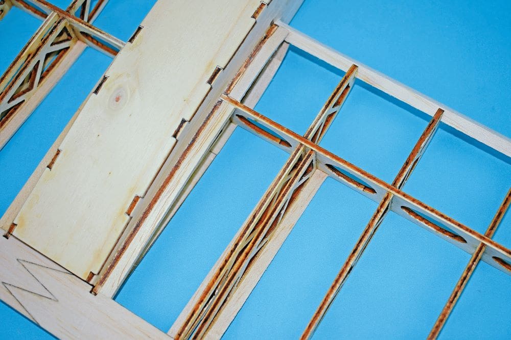

Referring to the pictures of the wing you can see how easy it is to assemble but you do need to identify the tip ribs, fin doubler ribs, centre section ribs etc. before you start gluing. Everything simply slots together so line and square it all up, then use cyano wicked into the joints. As mentioned, temporarily position the pod to check the fit between the inner ribs and, if everything is fine, then glue these final two ribs in place; if not tweak as required. My build sequence was a little different to how others have proceeded but just ensure the wing is straight and true. Don’t forget to put the infill pieces between the trailing edge sheeting and add the wing tips etc., then glue the pod in position.
At this point I made a minor modification because I was slightly concerned that the covering, where the fins attach, could easily pull off. So, I used a 1/4” x 3/32” strip glued alongside the ribs to provide a greater area for the film to adhere to. I also did the same between the wing and pod join. It’s easier to see than explain so please refer to the relevant photo. I would also check now that your servos will fit in the space provided and if not modify.
A trick I employ on elevons is to chamfer them only on the underside as I find a touch less reflex is usually required. The fins just need rounding off on the edges; there’s no need to create a sharp trailing edge. A light sand all over the airframe will ensure no lumps and bumps will show through when covered.

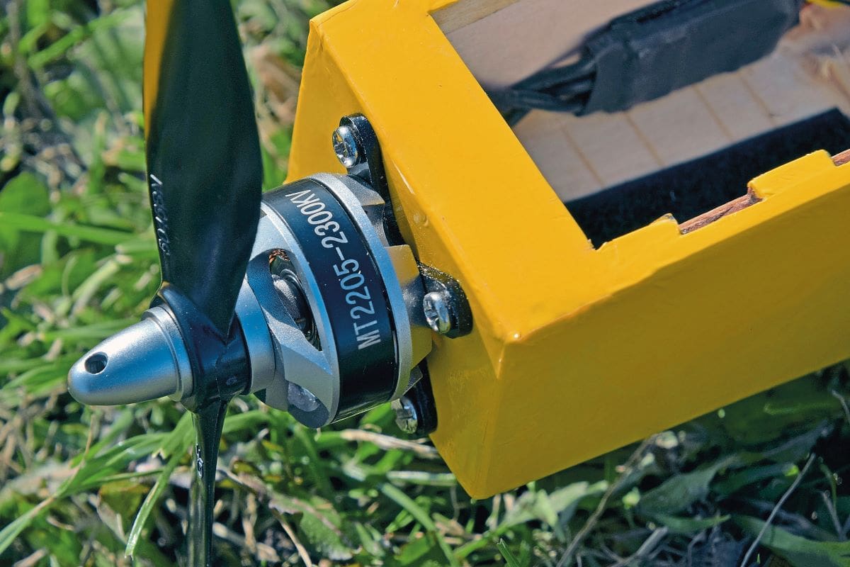

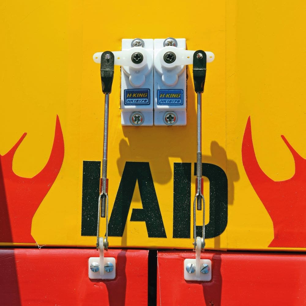

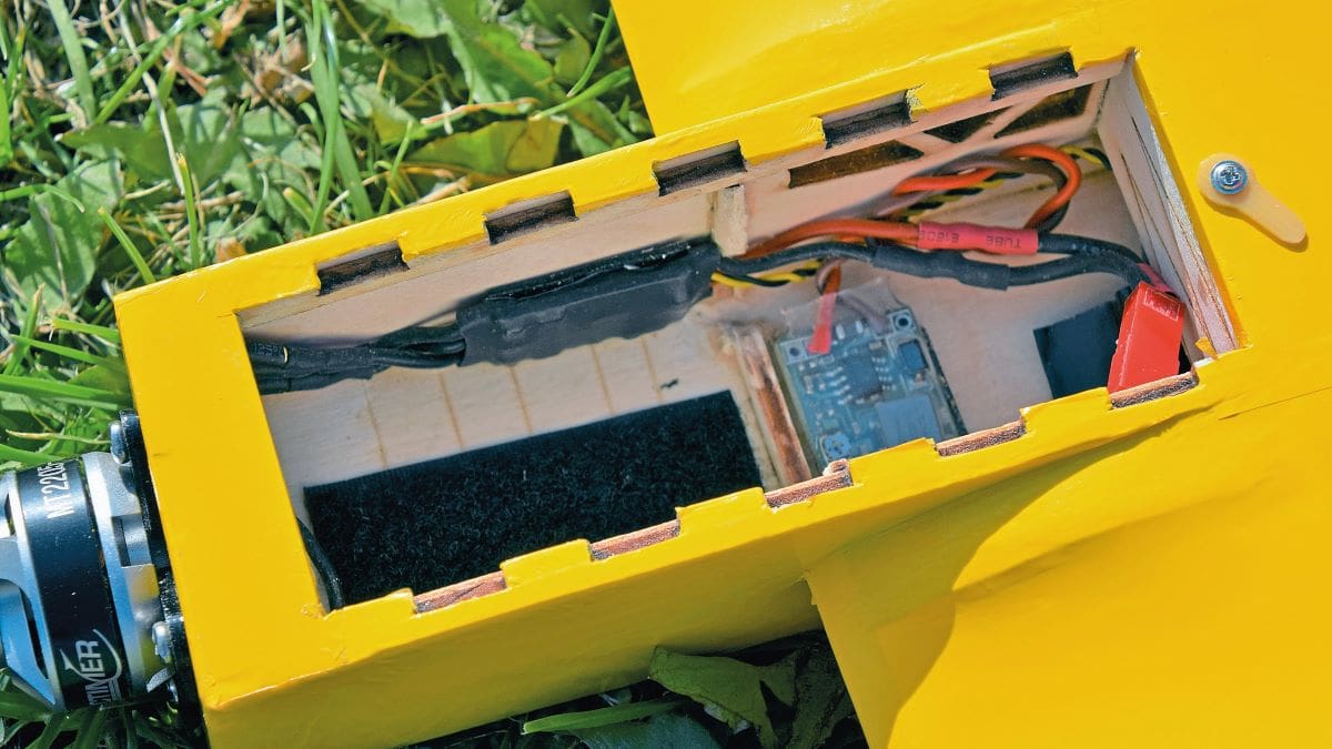

For my set up, I used a spare 2205 – 2300kV drone motor, a 6” x 4” Graupner prop, a 20 A Little Bee drone opto controller and an 800 mAh 3S LiPo. To get the 5-volt supply for the receiver and servos I made a 5V BEC from a 3A DC-DC converter. Servos were 9 g analogue types and provided plenty of authority.
Installation was as shown in the nearby photo, but I did cut an additional cooling hole in the battery hatch and glued a simple scoop on top to channel air over the ESC and BEC. On my model the receiver is located behind the wing spar and is just pushed in. If you decide to use a larger LiPo then it may be worth adding another hatch behind the wing spar to locate the ESC etc. as it will potentially turn out nose heavy if they are positioned where mine are shown.

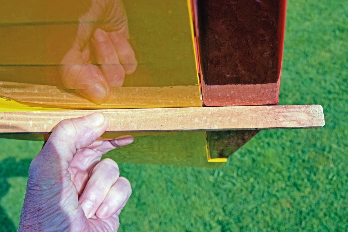

Check the elevons work correctly and, very importantly for a flying wing, that the C of G is spot on. For the test flight I had few millimetres of positive reflex (have a look at the photo showing the alignment of mine with the lower rear edge of the wing) but if you have any concerns then go old school and give it a test glide over grass.
