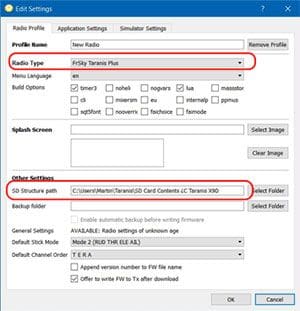

Please note there are different themes available for the screen. I have used the “classical” theme as it provides the clearest icons for printing purposes. We need to tell the program which transmitter we will be using, even though we might not have one. It can be easily changed later. Select the Settings icon, the round yellow icon in the screenshot above. A new “Edit Settings” window will open up to enable the settings to be edited.
 Now select the radio type. In these articles I used the Taranis Plus radio, which is currently perhaps the most common. Next you will need to select the folder where you stored the SD card files. Notice down at the bottom of the window the default channel order is set. I tend to use channel 1 for throttle, and channel 4 for aileron because I almost invariably use individual aileron servos for each aileron and assign channel 5 for the second servo. At this stage however, that is not important. Everything else on the screen can be ignored, and once the OK button has been clicked the window can be closed.
