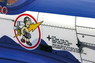

Now then, you’ll probably want to know what spinner I eventually used? Well, in the end I chose an Irvine metal-backed item which, I must say, seems to really set the model off well. Adding the decals is a truly satisfying task and after sticking them in the places where I guessed they should go (the instructions and box illustrations depicted the alternative Silver and Olive Drab B&C versions of the Mustang) I placed the whole thing assembled on the floor for a final inspection. You know, it does look good despite the hiccups along the way, and for all my moaning during the build it was indeed satisfying to see the result. The detailing is very good and the drop tanks looked the business. The Golden Knight engine was virtually invisible mounted in its inverted position and I was glad I chose to do it this way. What’s more, the balance point was bang on the money; must have been all those big steel pushrods that helped out there. Finally, the forward rake of the main undercarriage was a nice (if non-scale touch), for the model showed no sign of nosing over.

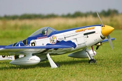

Swinging a 12 x 6” prop I did pre-empt a slight torque swing to the left when she lifted off but nothing manifested itself, which was jolly nice. As it was, the take-off run was quite brisk and short for a reasonably heavy model. Moreover, once airborne, and after a couple of circuits, I decided it didn’t even need trimming!
Going vertical was no problem but rather than silly aerobatics I loved doing simulated diving attacks and strafing runs up the field making machine gun noises in my head and rolling out at the end as if I’d just won the war. Despite its toy-ish appearance on the ground with its plethora of detail she didn’t half look good in the air. The Cadillac of the skies she certainly was. The drop tanks set the model off really well and the slow passes that I did for the cameraman looked well. Even the pilot’s moustache could be seen fluttering in the wind on occasion.
There were never any signs of flicky behaviour and I was really enjoying the exemplary slow handling characteristics. With this, I started a landing approach and brought her in for a greaser without any problem. Even taxiing back was a breeze.
Never satisfied, one’s cameraman asked for even more pictures so I refuelled and took her up again, this time stretching the take-off for scale-ish looks and just because I could.
I was machine gunning the daisies again right up to the moment when one of the ‘drop’ tanks fell off a long way from the strip in a very scale like manner. The handling characteristics were unaffected by the single remaining tank but even so I promptly landed. Upon doing so we discovered that the pilot had done a 180 turn in the cockpit (obviously looking for his tank). Perhaps you can spot him looking around for the enemy in some of the photographs. Anyway, after sticking him down again and giving him a strict rollicking for taking off his seat belt, we embarked on a fruitless search through the undergrowth for the missing drop tank. Alas, in its absence I removed the other one for the third sortie.
