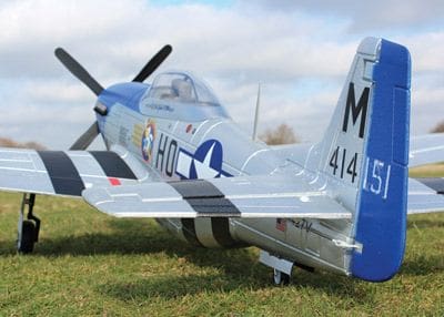

Not without reason has it taken a few months to pen some words on this, the second generation 1450mm FMS Mustang. You see, instead of scribbling my thoughts on the model after a handful of flights, I decided to live with it for a while, then scribble an account of the ownership experience. You know the sort of thing: how convenient it is to cart around, how durable it is, how it flies, and whether I genuinely think it’s the sort of model you’re likely to enjoy. This, I hope, will prove useful to all who might be seduced by the impressive detail, finish and undoubted presence of the new P-51, and tempted to part with cash.
You’ll notice that I used the word seduce in that last sentence and I did so with good reason. To my mind, anyone who has a liking for warbirds will have only to cast an eye over these pages to understand why I use the term. Take a look at the model in the photo above during a smooth low pass, wheels tucked neatly away and yellow prop tips highlighting the arc of that evocative four blader. Convincing isn’t it? Now have a peek at the landing shot on page 120 and tell me you can’t hear the powerful V12 Packard Merlin banging and popping as she flares for a three-pointer. Mass produced re-modelled packing foam it may be, but you simply can’t deny the authenticity or appeal of this model. Granted, as P-51s go it’s not 100% accurate, yet it has more than enough Mustang credentials to pass as a convincing scale replica. In fact, let’s qualify that with a look at a few visual highlights.
Starting that the sharp end, then, there’s that four-blade paddle – albeit a little small in diameter – complete with aforementioned yellow tips and manufacturer’s markings. Behind this, panel lines, vents, Petie nose art and a set of six scale exhaust stubs on either side. Move back a little further and we find worm gear electric retracts (complete with leg fairings), functioning flaps, panel lines, canon detail and working navigation lights. To its credit FMS has also made a brave attempt at detailing the cockpit, indeed here you’ll find a 3/4–length pilot, a seat, and a passable instrument panel. Significant detail has gone into the legending and artwork, too, the whole reproduced in a pleasing satin finish and applied with a good level of accuracy – not something that can be said for all foam models.
Now, I don’t mind telling you that the bit which impressed me most was the inclusion of a retractable, steerable, tail wheel with, get this, hinged gear doors! This is a genuinely neat detail that, most importantly, has proven robust and very reliable. Finally, at the tail end you’ll find more panel lines and legending, plus balanced control surfaces. As I’m sure you’ll agree, a pretty fussy and impressive level of detail for a model of this nature, the result being that if you pop it on the ground and step back two or three feet, it looks the real deal.
