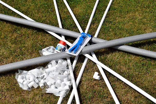

During this voyage of discovery, I also unearthed a few lengths of PVC overflow pipe, elbows and T-pieces. Looking at the pile of wings and fuselages that I also had stored up in the loft, an idea came to mind – build some racking. After a few tentative sketches I decided winging it was the way forward, so a quick measure up, with a lot of guess work, and I had a parts list. A trip down to the local plumbers’ merchant saw me ready to get cutting and gluing.
BUDGET RACKING

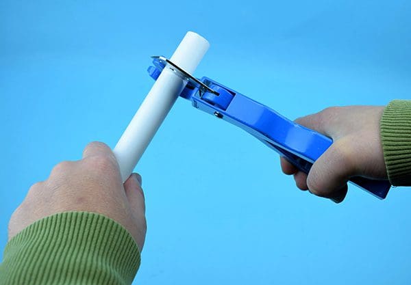

The racks are surprisingly cheap to make with the T-pieces and 90-degree elbows costing around 60p each, tubing (21.5mm) around 50p per metre and a tin of glue at £4.00. One widget definitely worth buying for around a fiver was the pipe cutter; it’s far easier than having to hacksaw each piece to size, then chamfering the edges off.

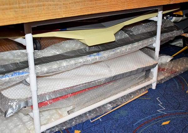

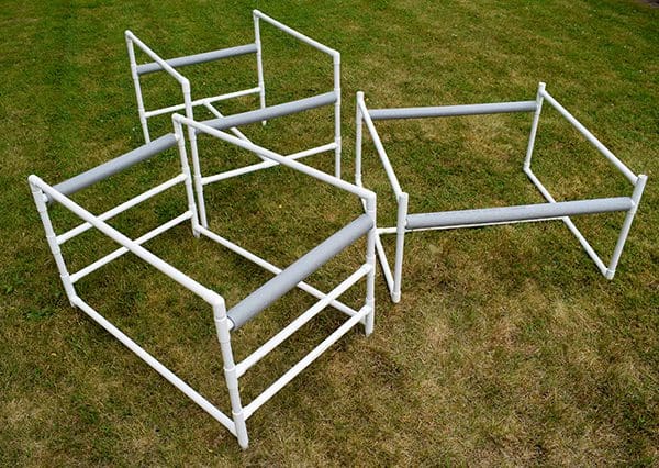

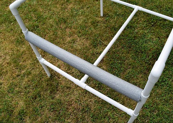

To start with I decided to make one rack for wings and another for fuselages, intending to fit them under some shelving in another loft; we have a lot of loft space, as we live in a bungalow. Once you have established the size, start by building the basic frame. I added additional struts to stop any flexing that may occur when loaded up with models, but there’s no need to make it absolutely rigid.

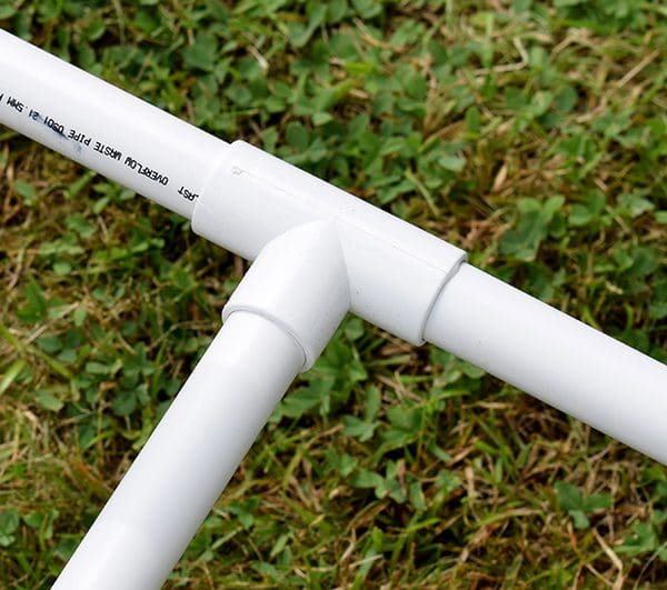

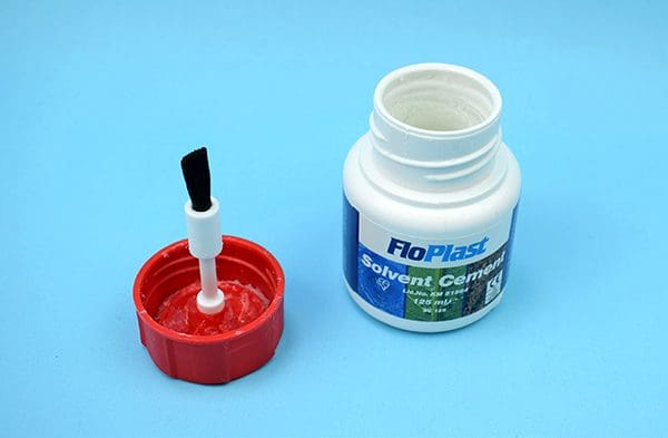

As you’ll see from the accompanying images the designs varied with no definitive shape. You don’t have a lot of time to move things around once the solvent glue is applied, so I would suggest a dry run first to make sure everything lines up because once glued the only way to remove a Tee or Elbow is with a saw, or the pipe cutter.
If you work on the end panels first, assembling them on the work bench will ensure they are not twisted. Once the glued pipe has been inserted into the fitting don’t forget to wipe off any excess glue that may have oozed out.

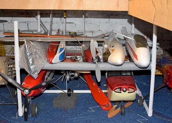

Most of my wings are stored in bubble wrap bags but to protect the fuselages I bought some thin 22mm pipe lagging to slide over the tubes to protect them. These racks will definitely maximise storage space; I managed to get eight fuselages into the space where I previously stored three – a great result!
Was it worth it? Most definitely, with the racks working out around £10.00 pounds each. Wood could have been used as an alternative, but the plastic tubing is so easy to work with, light weight and each rack can be made in less than 10 minutes.
