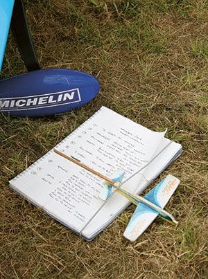

Competition pilots use these stick models to visualise their routines and I commend them to you, too.

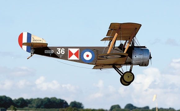

Flying a draggy scale biplane in a crosswind requires a huge amount of rudder manipulation.
